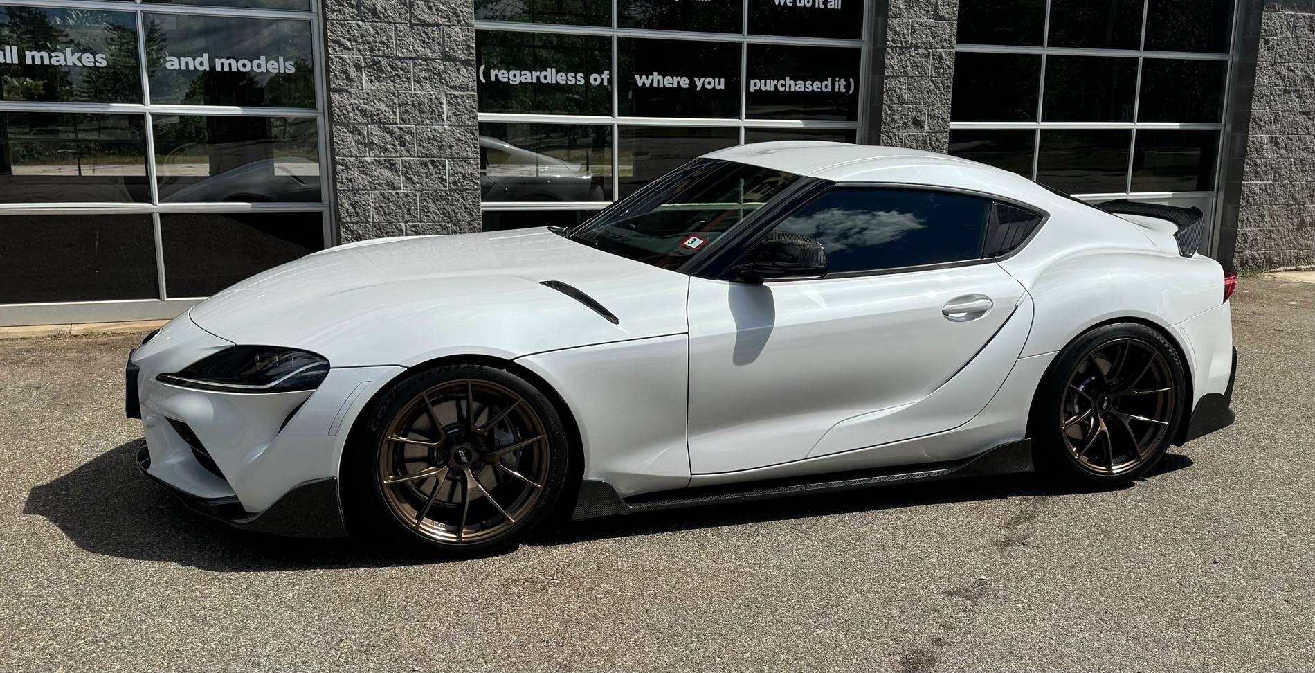

i run MSS springs on the lowest setting. I don’t have any experience with other brands. Ride quality wise- feels stiffer in both modes but still comfy in normal (this is my everyday setting) No rubbing even with 20mm and 17.5mm spacers.

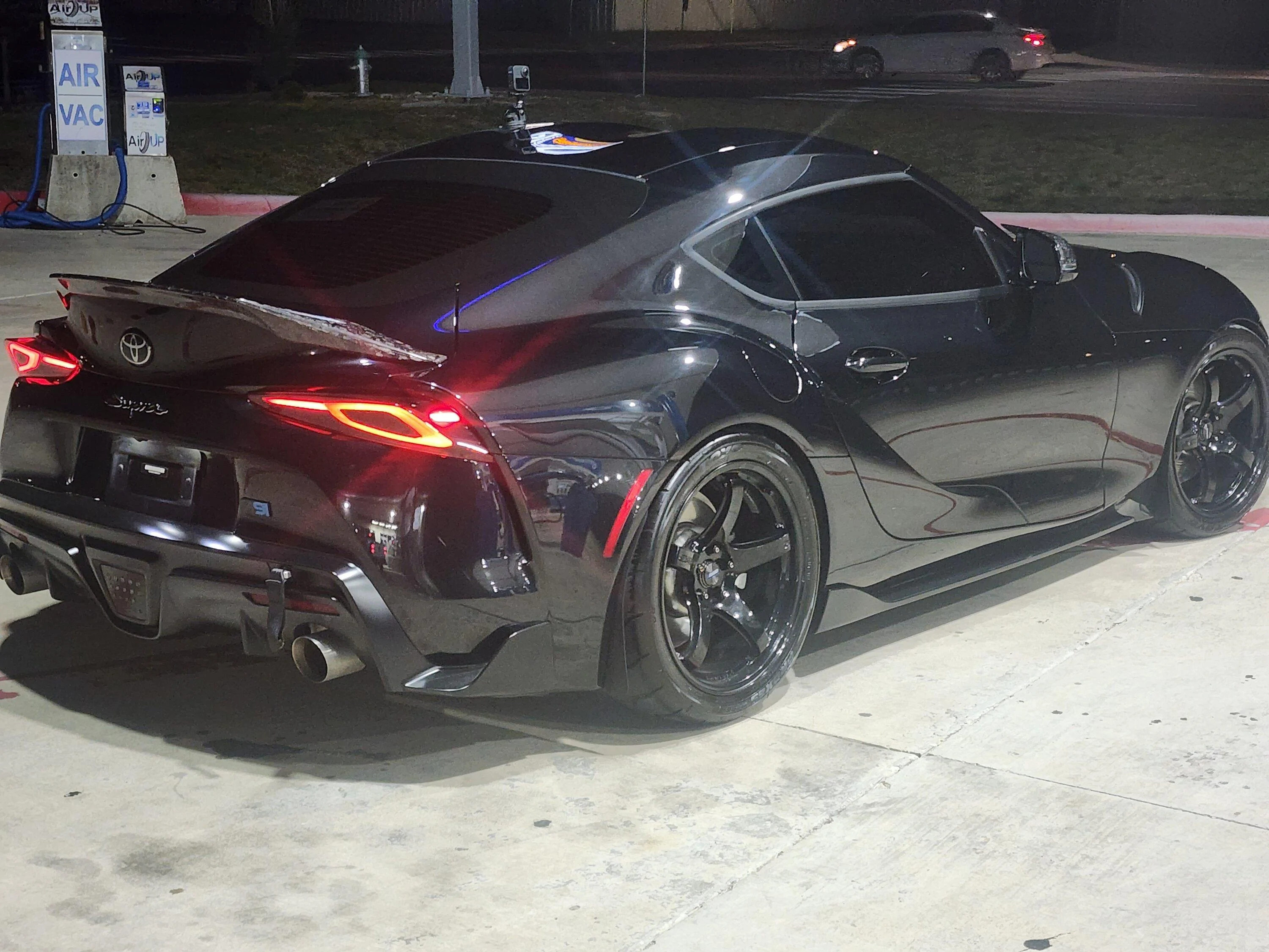

Was in same boat as you. I went mss because u dnt have to remove the wheels to adjust from what i heard. Ride quality good to me stiffer in normal mode but still comfortable. I'm dropped for a flush look and daily my car. MSSbis a reputable company and they do engineer quality parts. Wait til you open that box they send if you go that route 💪🏿💪🏿💪🏿
