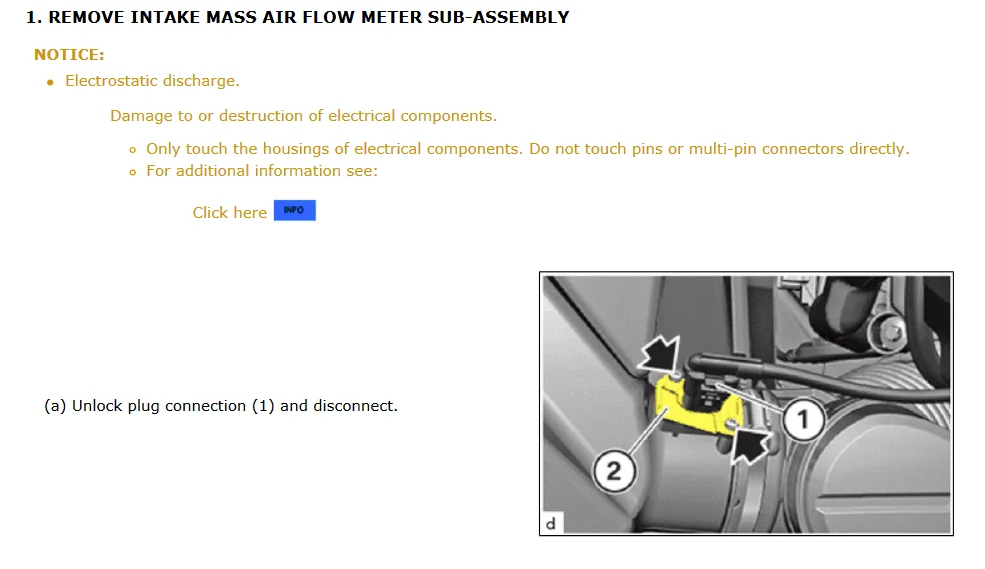

YOUR MAF
This is right after the airbox/filter, AKA the "long needle" sensor you reinsert to an aftermarket intake. Most people think this is an IAT, including some of the vendors making intakes, but it is not. It's the MAF sensor.

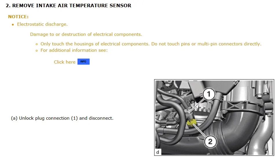

YOUR IAT
This screws into the charge pipe right before the throttle-body. Has a "star" shaped ring that can be unscrewed by hand. Some people think this is the MAF, but it is not. It is the IAT sensor.

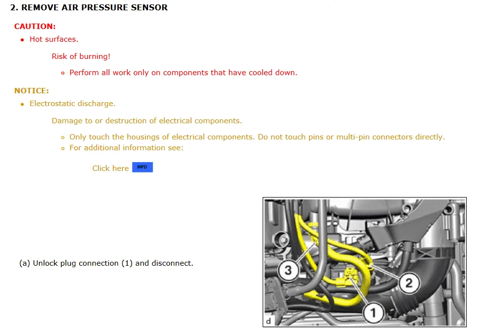

YOUR MAP
There's a bundle of wires coming towards the front of the engine, along the centerline. It's right above the charge pipe not long before it curves into the intake manifold.

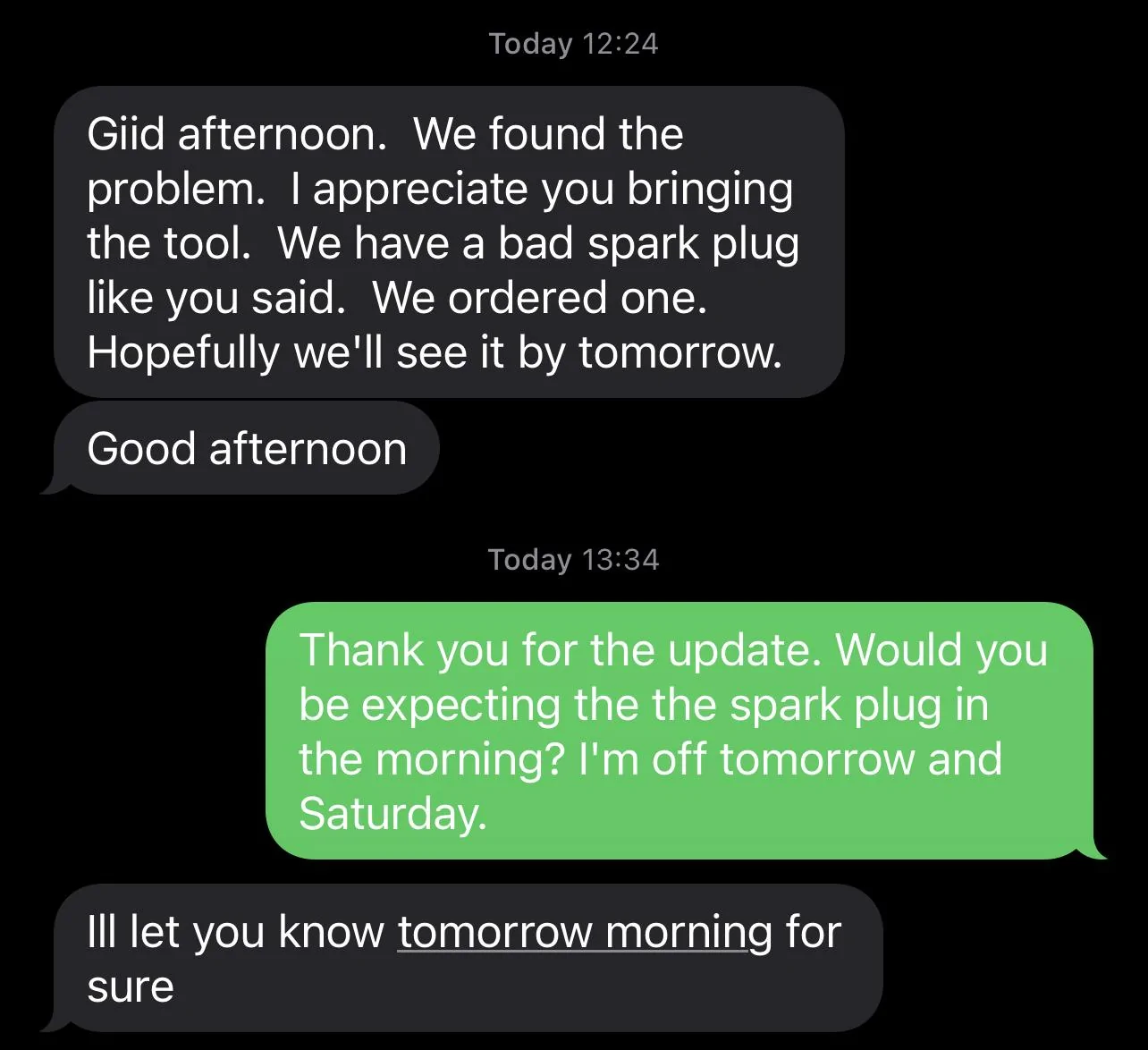

They finally decided to check the spark plug after I’ve been telling them to do so. I got this text below so I hope that resolves the problem. I wanna say that this Saturday will be two weeks since they’ve had the car. I’ll also switch to a different oil. I figured I’d give liquid Molly a try.
I wish you luck, they replaced cylinder 1 and 6 on my car and switch coils from 1 to 5 and vise versa
