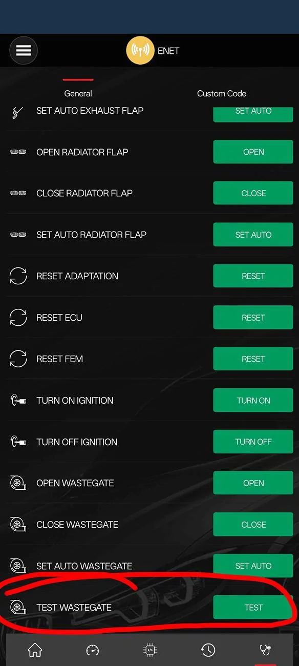

How did you calibrate the electronic wastegate? I know it can be done with Toyota INSTA, but I am having trouble registering a new account to download the program and TechStream also.

Use MGFlasher. It's free. It will tell you if the gate is too long or too short and give you the exact millimeters. Just need an Enet cable.
ISTA never needed to calibrate WG. It also doesn't "calibrate" anything, as ISTA just gives you the measurements this app does for free.

Yeah, for some reason this app hasn't been mentioned all that much on the forums, but MG Flasher is a great troubleshooting tool and all the diagnostic capabilities are $0.00. The WG measurements alone have saved me tons of time.

It used to log for free as well, I think they recently changed it so you have to have a logging license though.

how did you adjust the WG after getting the measurements from MGflasher?
