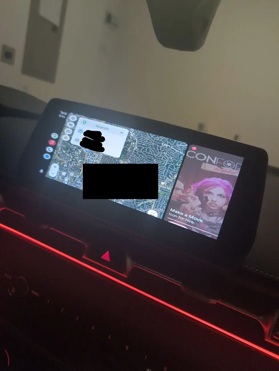

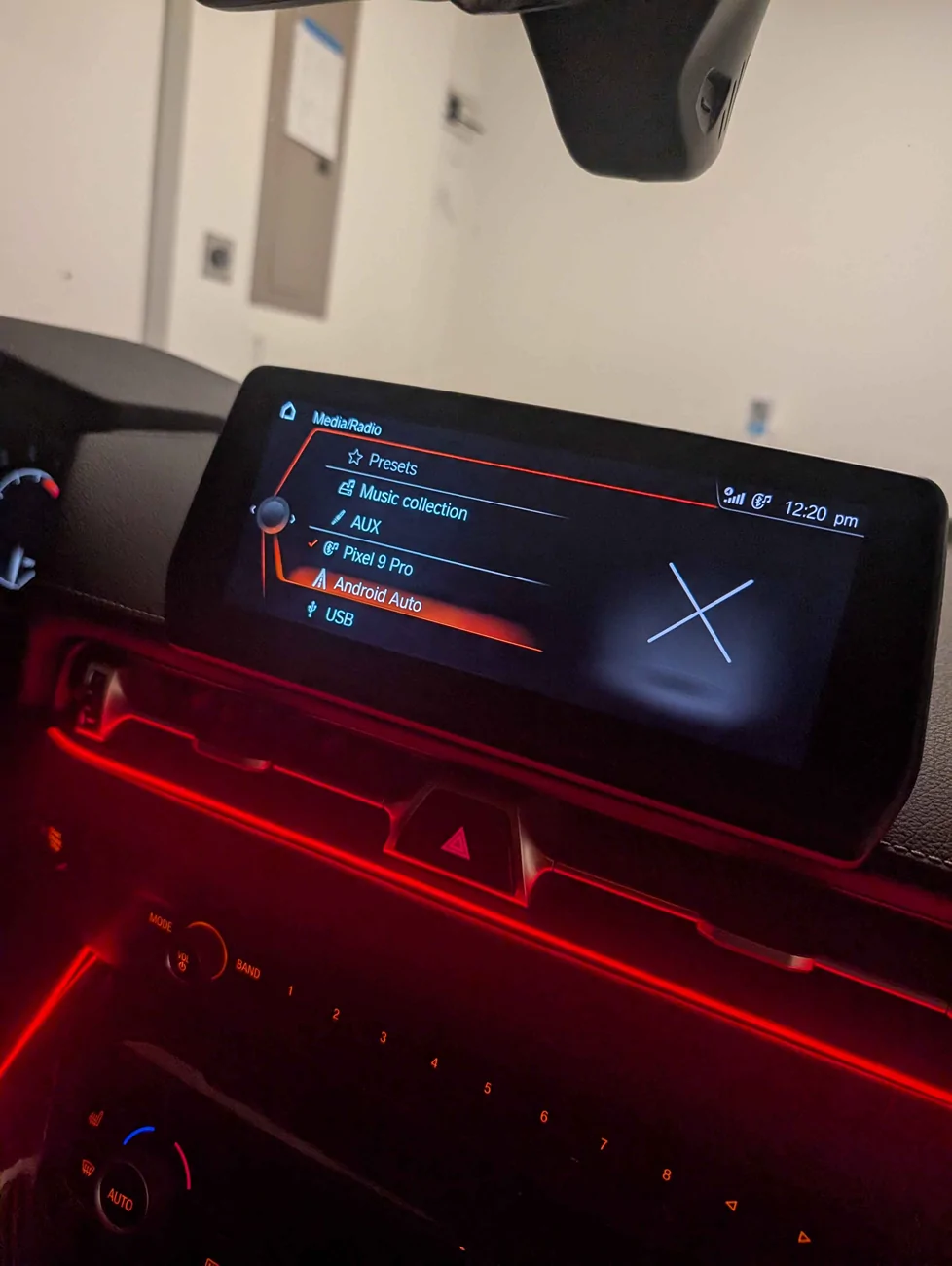

Proof or GTFO:
Initial Build -
Milestone 2 w/ Touch Controls -

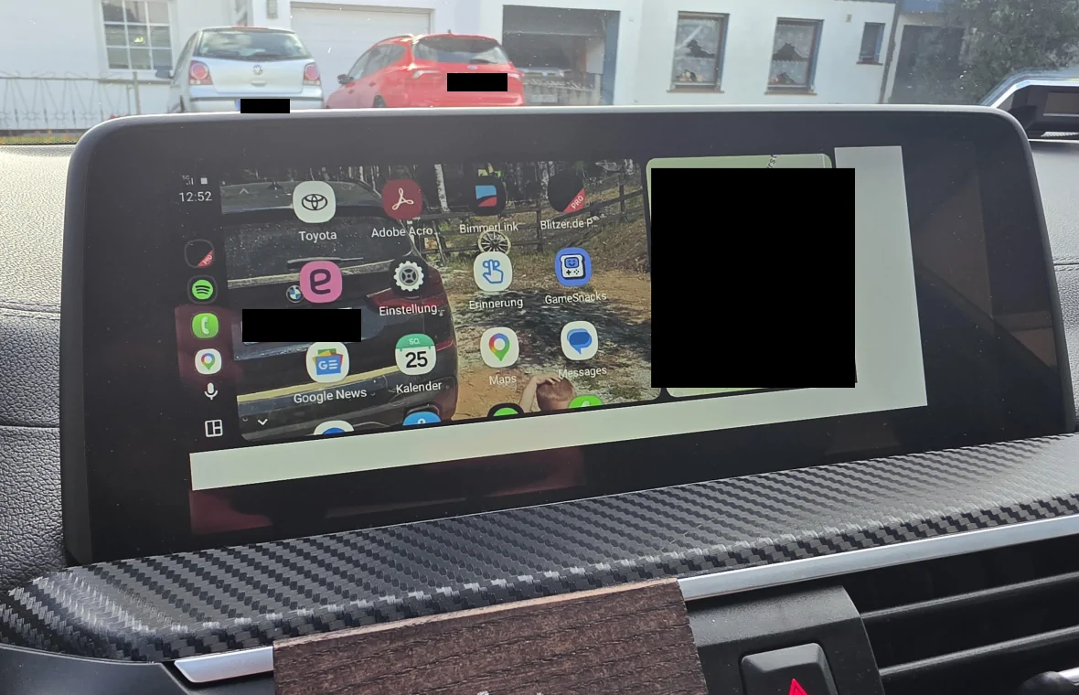

If you're looking for a way to help, I'm currently looking for a free way to enable SSH for folks. The goal is for this to be 100% open source. It's currently possible to generate a code with HUTool, and have it enabled with FeatureInstaller, but that sucks and costs people money. A standalone python script to open it would be immensely better. But... it seems to require a L5 security key that may be a private key.
This works on my head unit and that doesn't mean it'll work on yours. I'm also looking for testers to prove portability across multiple istep versions. If you have SSH open and are feeling like you want to donate some time, please let me know. I can send you a pre-compiled binary to try.
