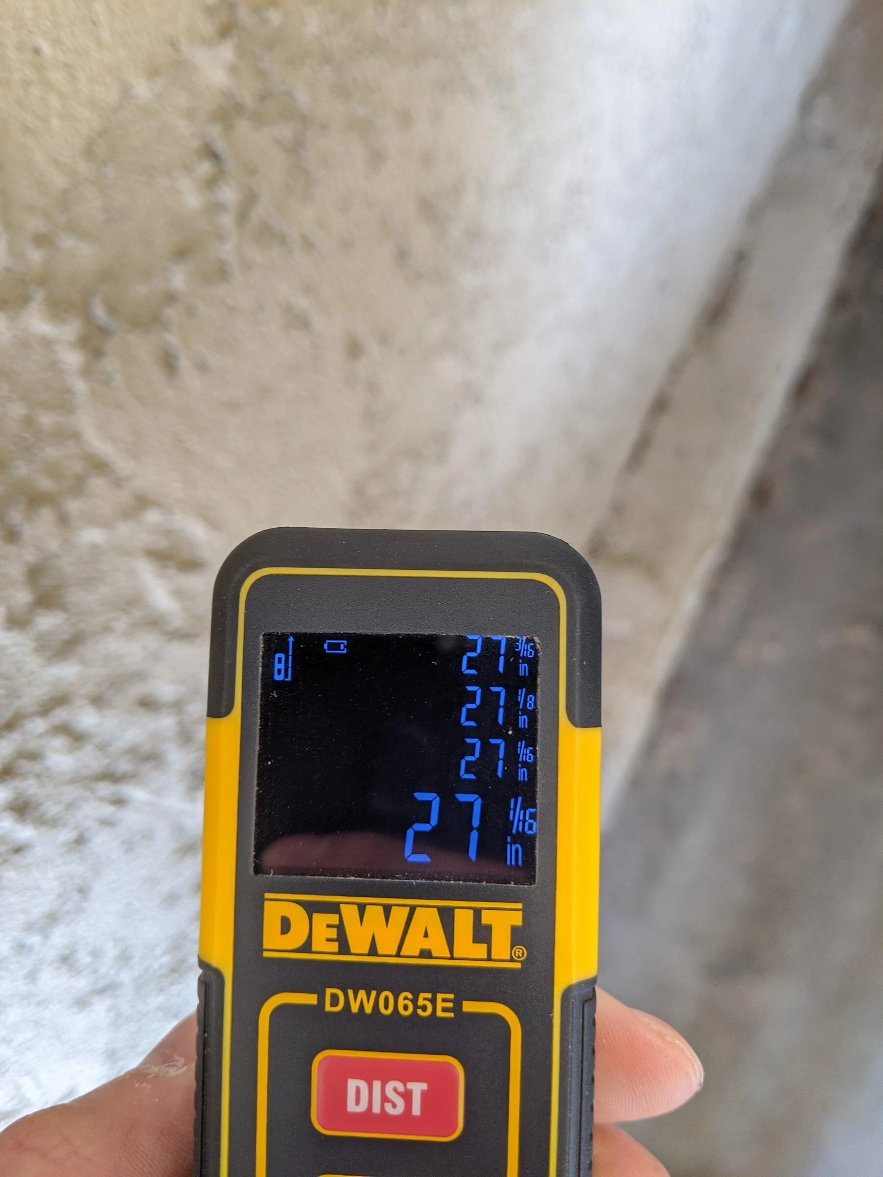

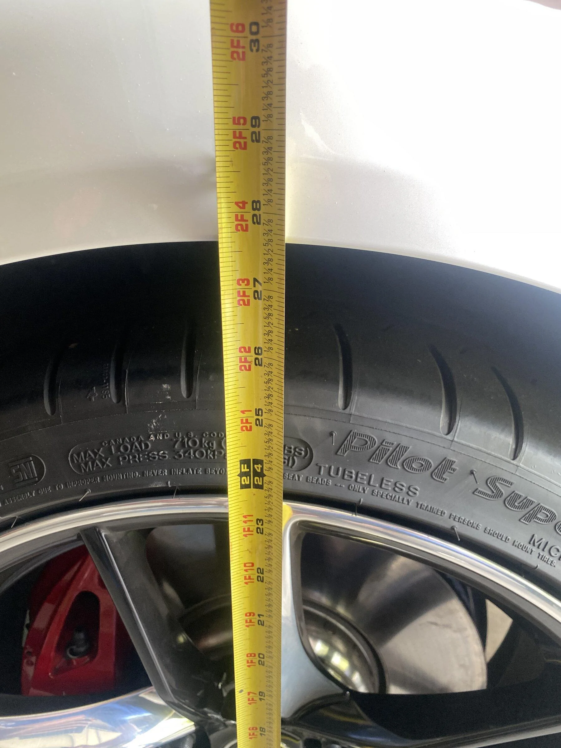

Can someone please measure the height of their front wheel well?

Yeah I just thought it was weird that my front end is at least a 1/4 inch closer to a half higher than my back.

Anyone else that could chime in so I know if there is any variation before I complain to the shop?

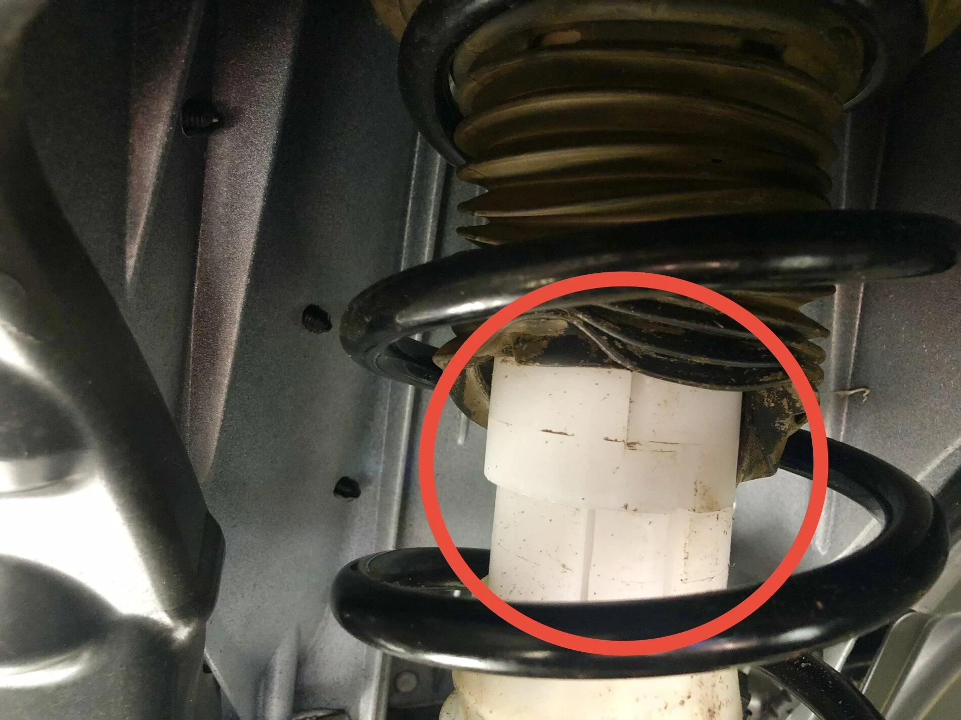

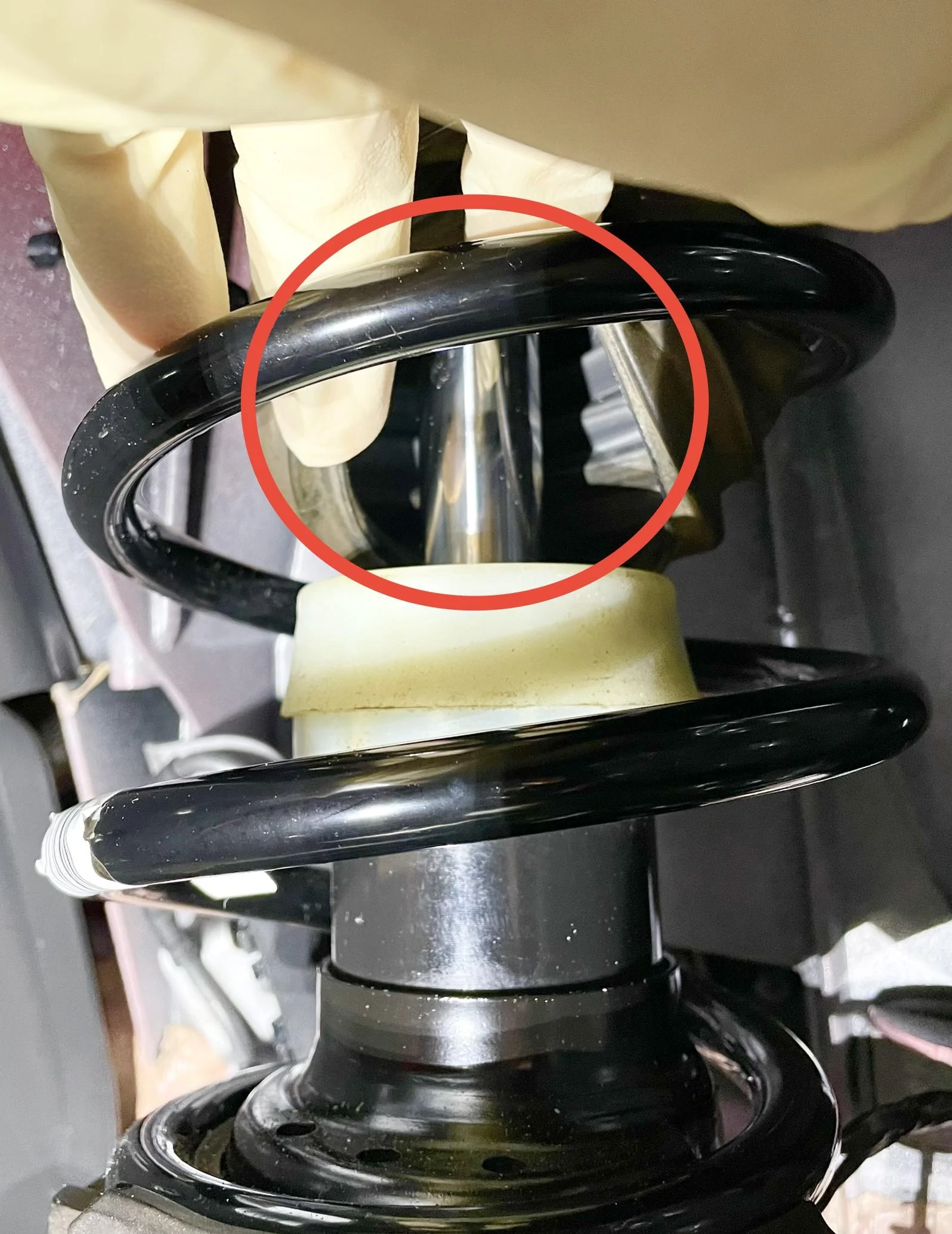

Did you check to see that the dealership removed the shipping spacers?
-RJM
This is how they should look removed.

I just had HKS springs put on and I wanted it at stock height… I’m worried that the shop has the front too high.
8,843
17,336
Stock is 14.5" wheel center to fender front/rear
