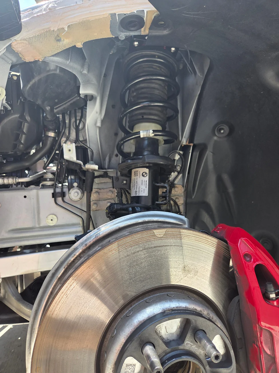

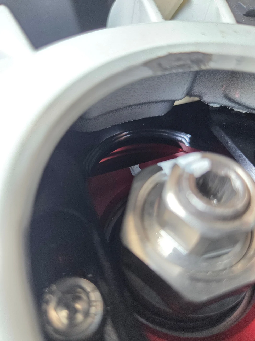

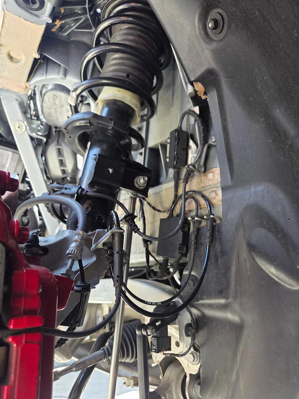

I'm trying to diagnose a left front suspension clack that started after installing Verus camber plates on an otherwise stock suspension (OEM struts and springs, ~4,000 miles). It does have a stud conversion and spacers. I also removed the bumper about a week before to repair the ambient air temperature sensor wire that a mouse chewed through. There is some possibility the noise is related to that, but I'm reasonably sure I didn't hear it until the camber plates went in. I've also since removed the bumper and fender liners and tested with them off.

Installation:
Verus camber plates installed on both sides at the same time.
Struts remained attached to the knuckles during installation.
I used a jack to compress the springs on the car, and death sticks to keep them compressed while I lowered the strut.

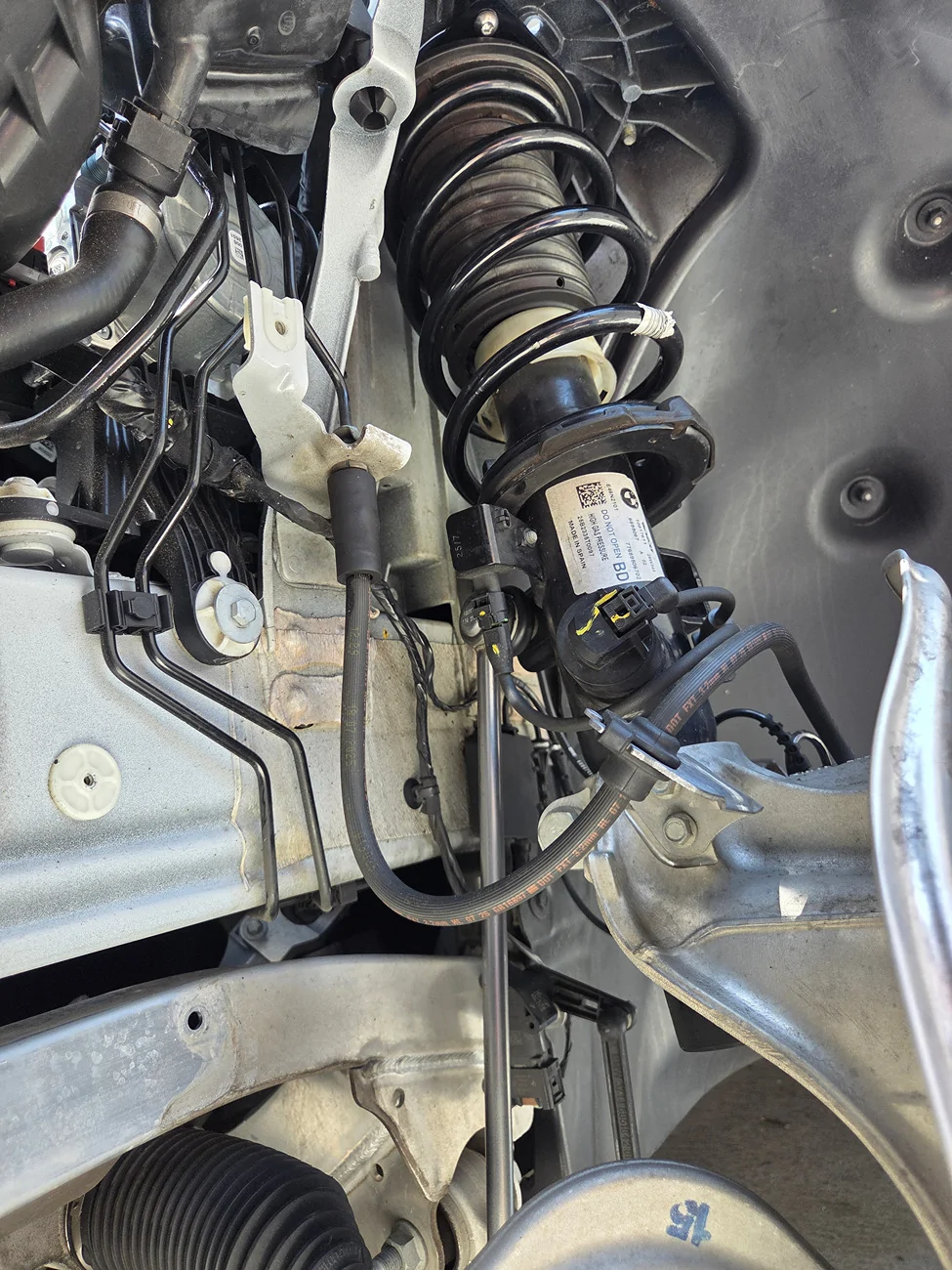

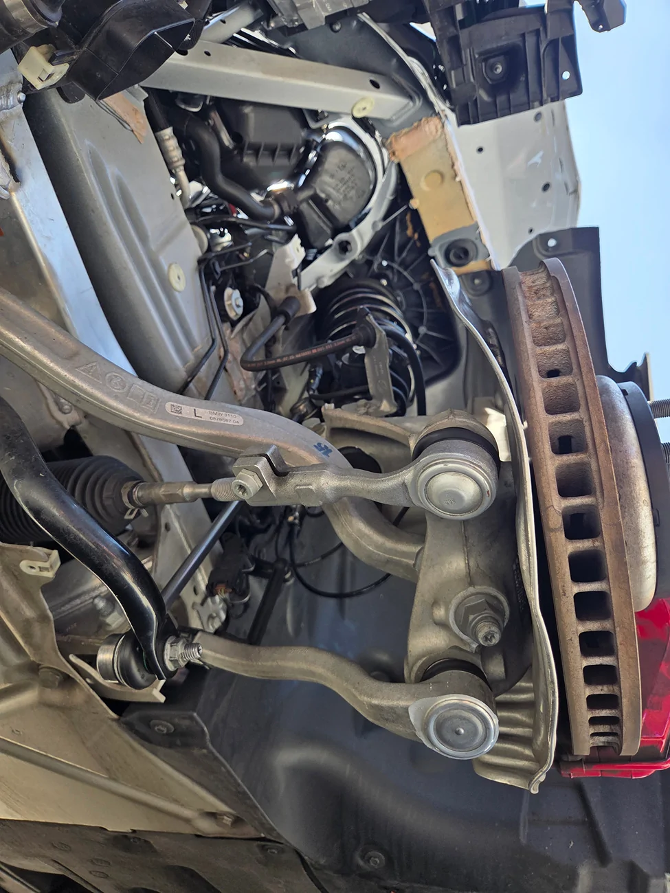

The only installation difference I can think of is that when i first compressed the left/driver side with the jack, I forgot to disconnect the swaybar endlink. I lowered it and disconnected it and continued.

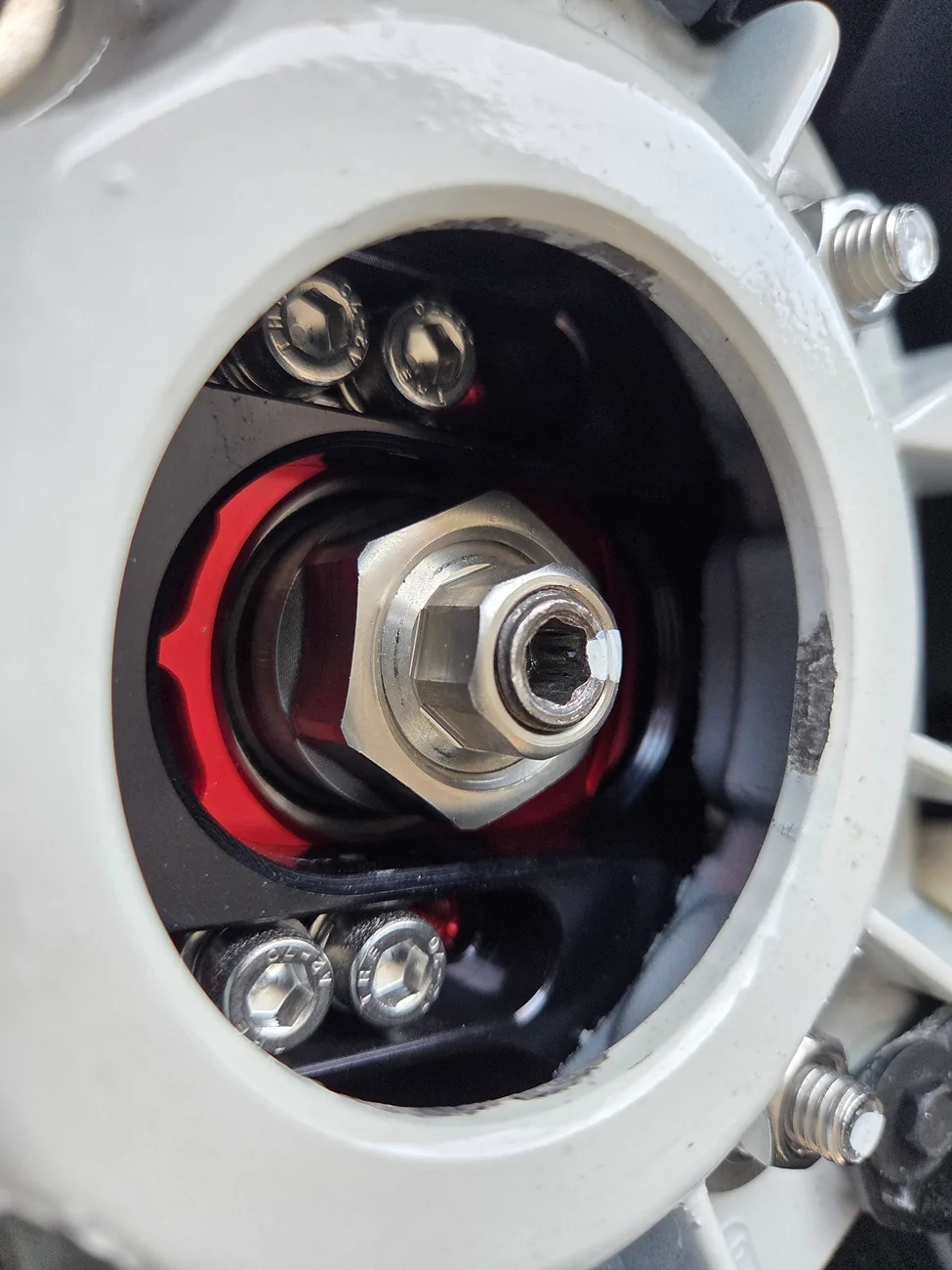

I used a pass through wrench on the top nut to keep the shaft from spinning when torquing. It still moved around a little bit.

Removed the endlinks on both sides and tested with the sway bar disconnected.

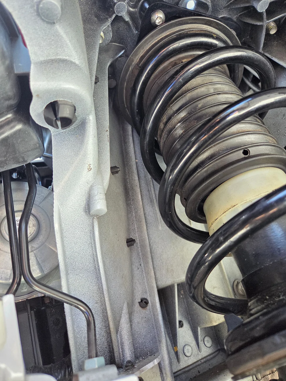

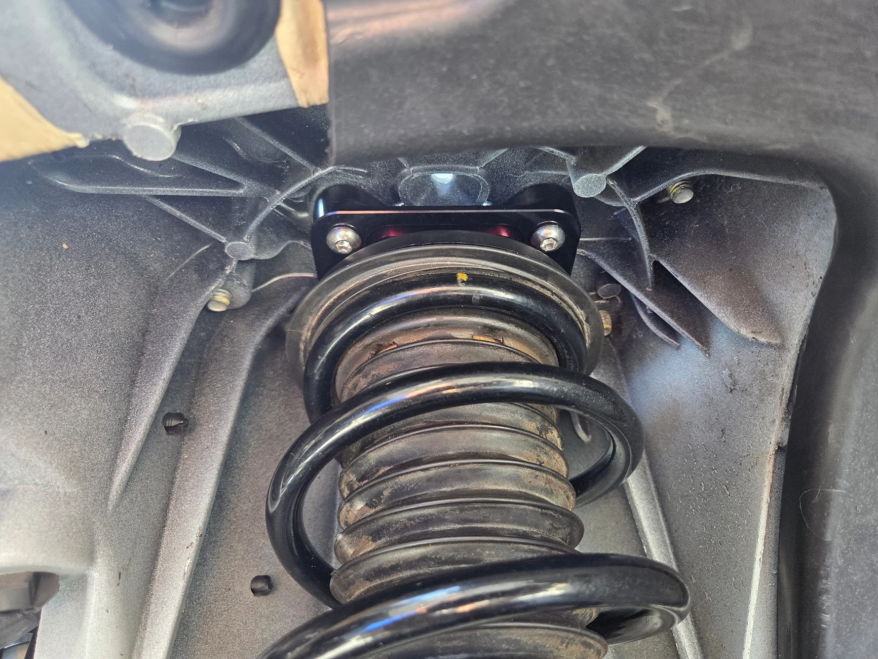

Dropped the strut shaft and reseated the spring and bearing multiple times. (Getting that bearing to seat just right is a huge PITA. I guess its possible it is still not sitting correctly, but I have carefully compared it to the other side and it looks the same). I used a endoscope to try to examine the backside of the bearing. Its hard to see, but both sides seem to be seated the same. I used some washers to try to measure the gap between the bearing and the plate, seems pretty close.
Replaced the bearing.
Tested with the plates at max and minimum camber.

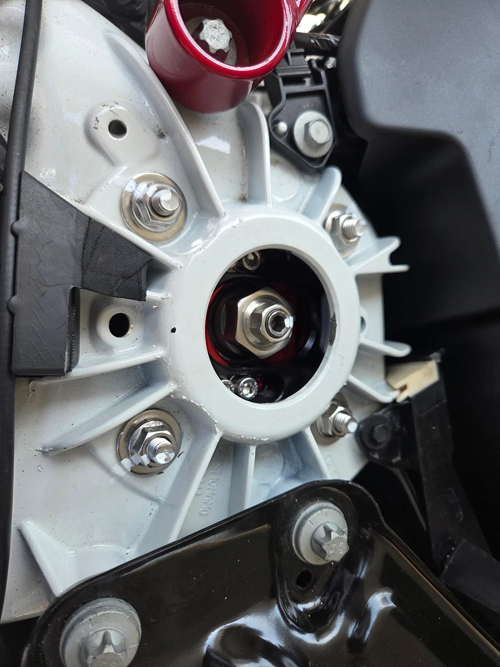

Replaced the entire Verus camber plate assembly with a new one.

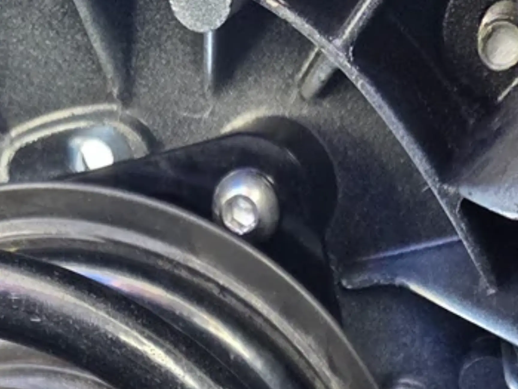

Top nut and camber plate bolts are tight and marked with paint; no movement.

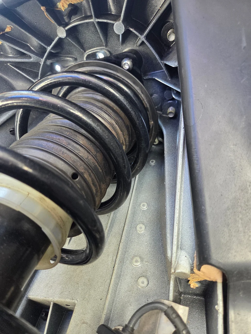

Brake line and other brackets checked.
The bump stop seemed looser on the problem side, so I put a zip tie on it to give it some more tension and keep it at the top of the strut.
