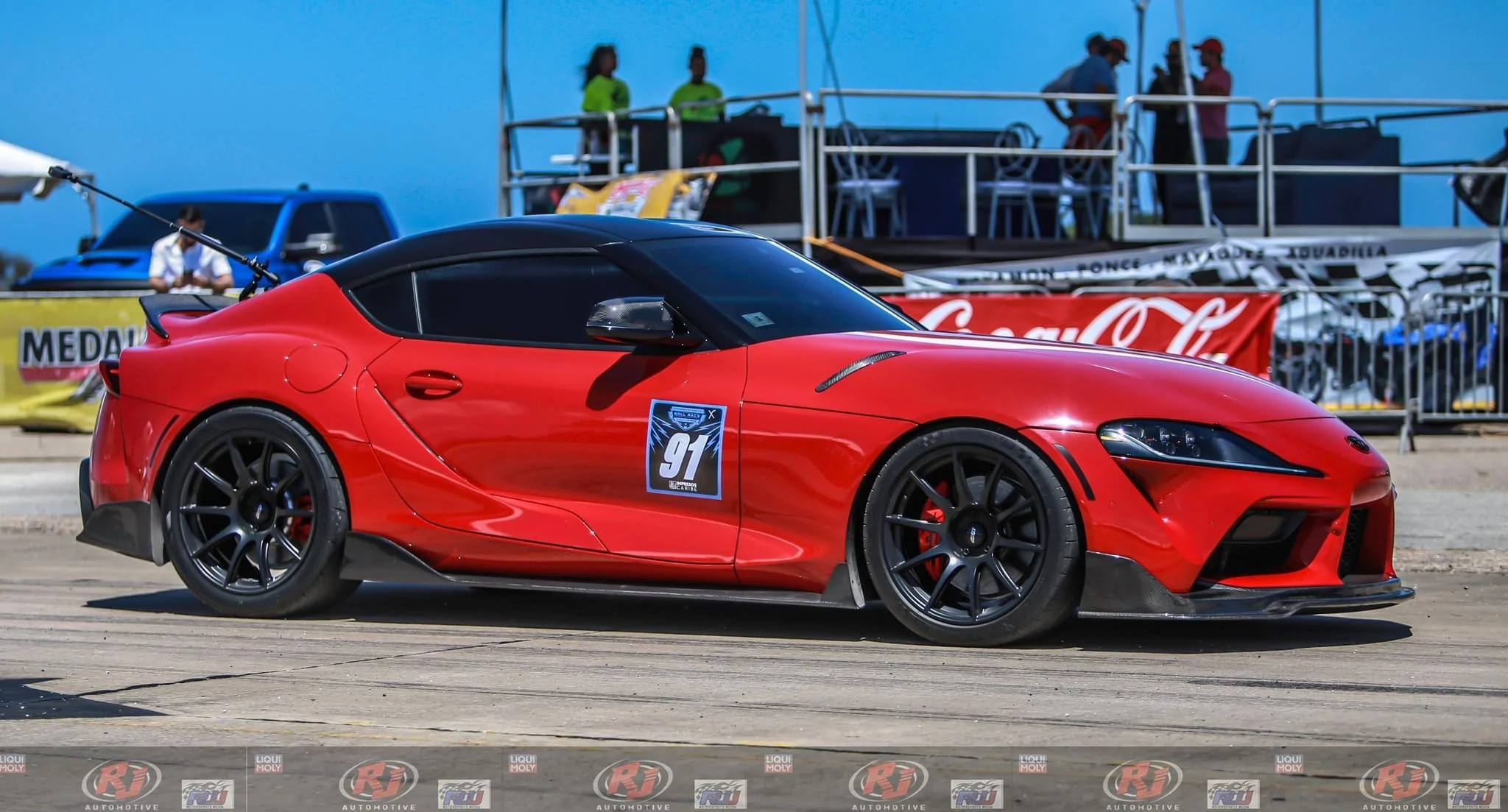

Need my car to launch straight!!

Lower your tire pressure 20ish psi.
NT555R2s are good tires, but 19s? You should be on 17s with a real side-wall for 700hp+
Ok, I will lower tire pressure and re-align. Ordered SPL toe arms just for my peace of mind. 17’s are on my plans.
Is there any suspension, KW, HKS that would do me good? Purchased SPL toe arms, traction bar and Cusco sway bar since were are going to be there.
