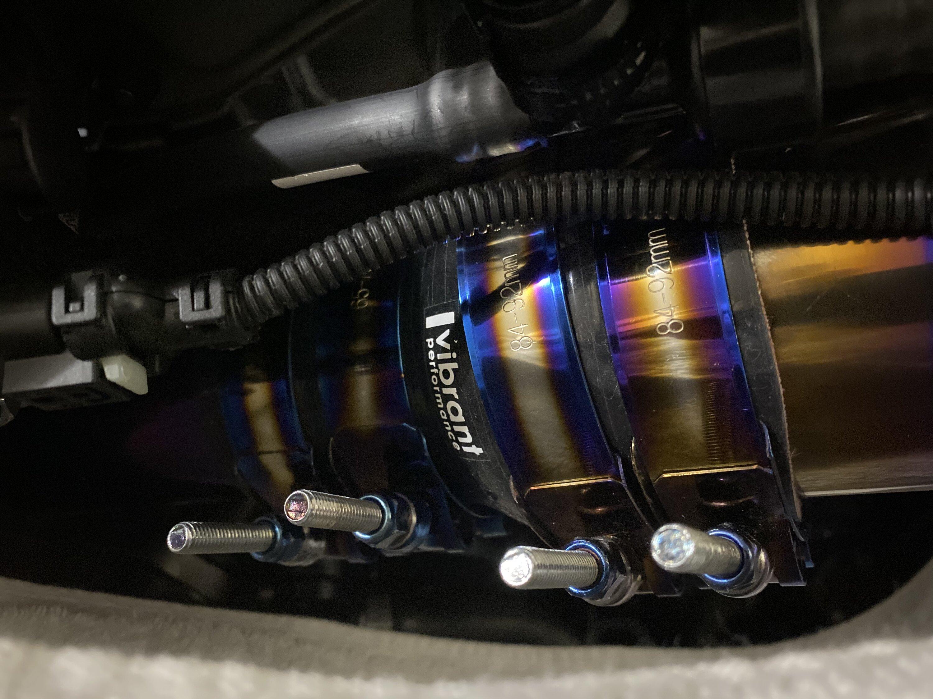

I have the FTP charge pipe, do you think this one would work and is longer? I have been pushing it close on space to clamp onto.
yes, it’s a generic coupler but way longer than the one that comes with the charge pipes which provides more clamping area. The Vibrant material seems to be better as well.
Here is the comparison.

No boost leaks with that setup. If I was running 30 psi I would run that dual clamp system.
For now the P2uned version gets the job done.
-RJM
i over did mine. Lol yours works fine I bet!!

Ok quick update.
Installed the Vibrant coupler and double clamped it just to be sure. ;)
Car drove fine but then no boost again.
Compiled some driving logs and it looks like it’s an issue with the Reflex /PI setup. Throws the PI Diagnostic Flag: 1048576 and 1048580 (PI Effective Pulsewidth Target is less than minimum allowed) & (Engine Load below activation threshold)
Can this cause the car to go into limp mode? There’s no codes just no power and I don’t have the Botti tune files to reflash. ?
