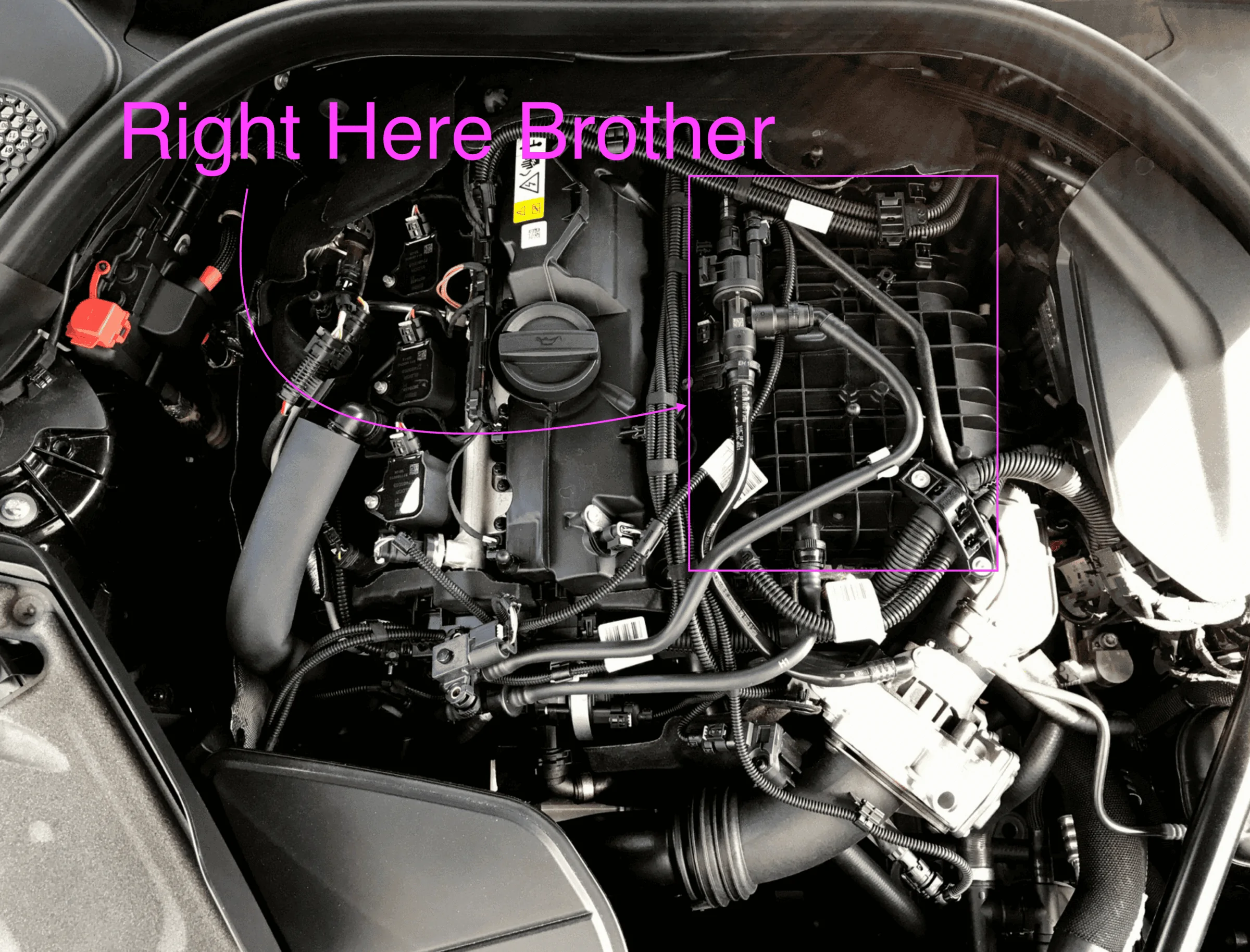

Looking at the engine, am I blind or does the car not have an intercooler?

The Gr Supra is equipped with a water to air intercooler (I believe it’s called). So the intercooler is placed right after the throttle body.

It’s molded into the intake manifold. As stated it’s a water to air intercooler not air to air.
