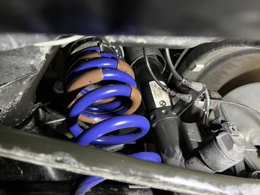

My H&R springs make the same clunking noise after install on my 21. Looking to get the Tein silencers Like you mentioned. Thx for the part number. Can I ask how many you bought. I see them come in pairs but it looks like you have around 4-5 on the 1 spring. Also can they be installed while the springs are still on the car? Thx in advance.

Lift the car to install, with the wheels hanging springs will be uncompressed and you can stick them on
Yes I added around 5 iirc to each spring in the rear

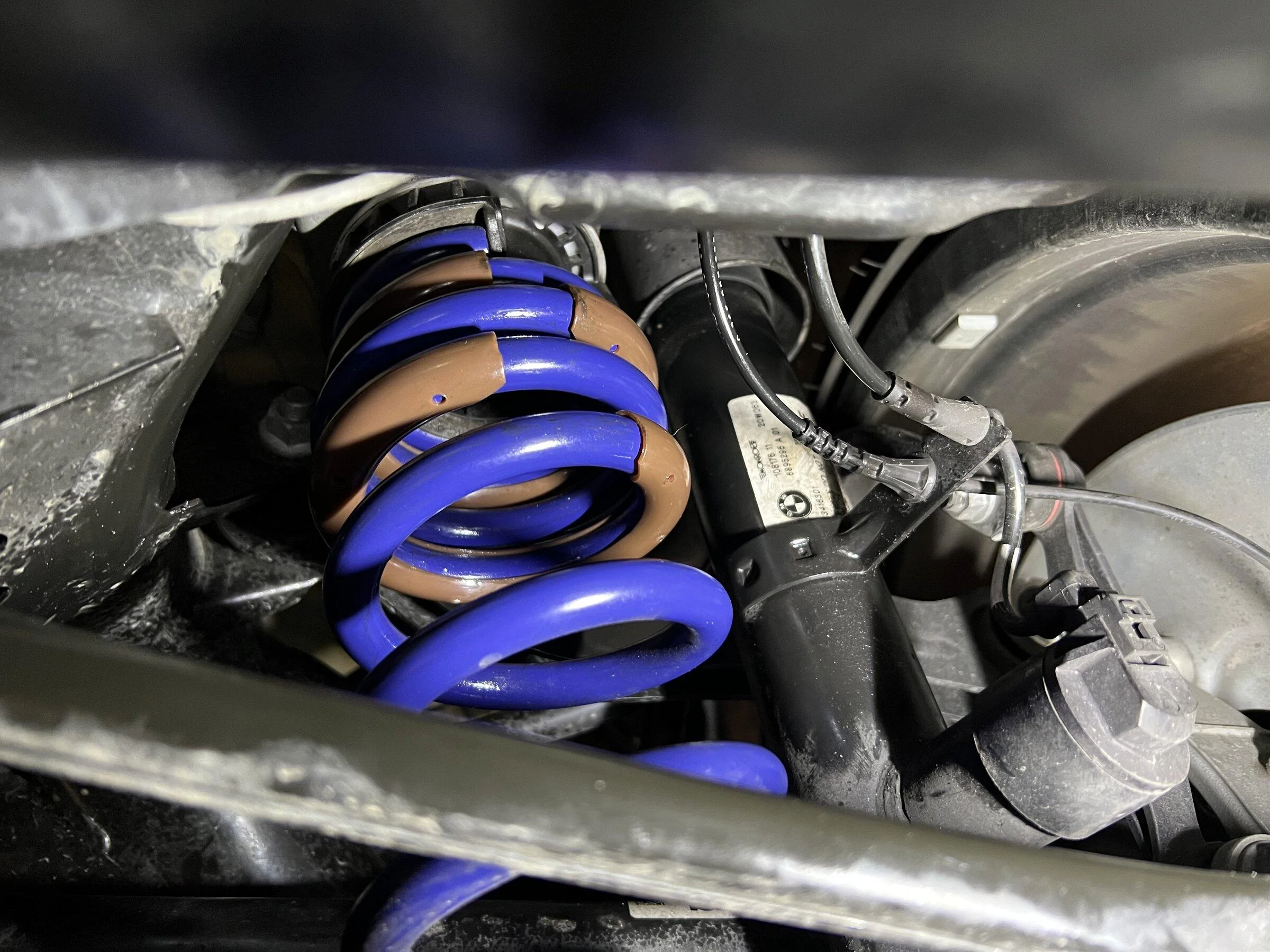

OverRev
Perry
Mar 11, 2022
38
2021 SUPRA

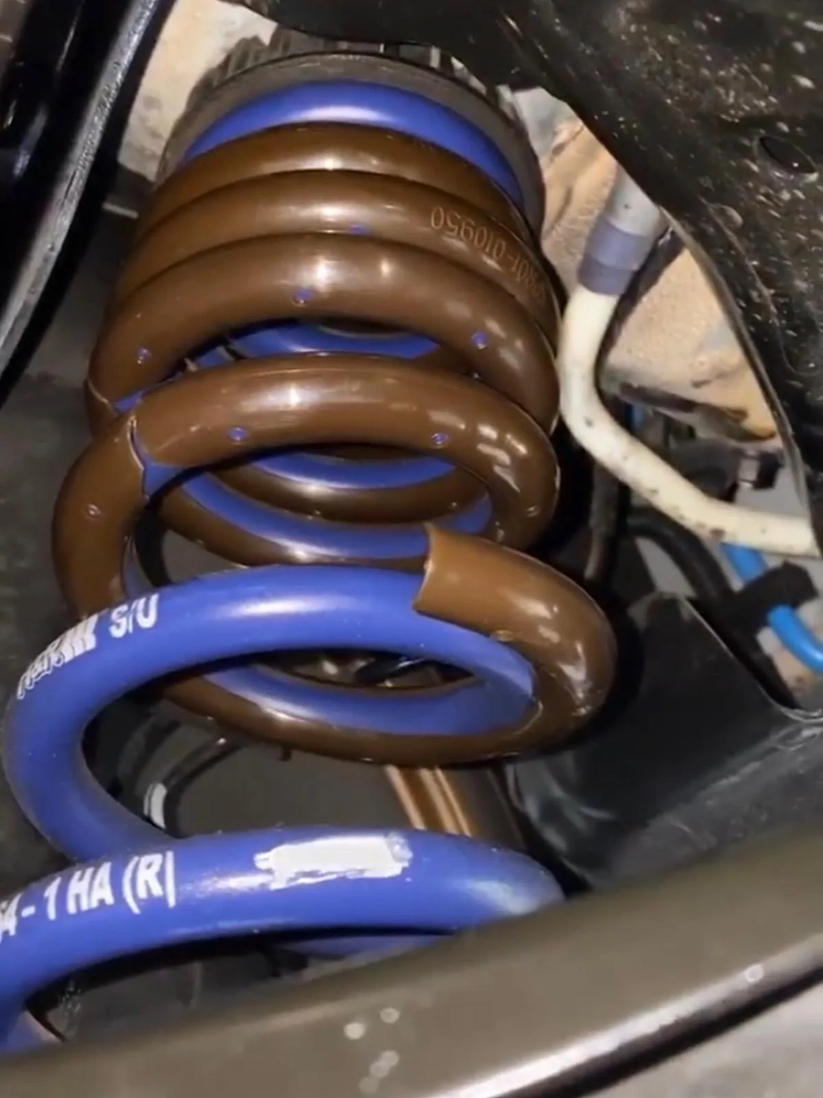

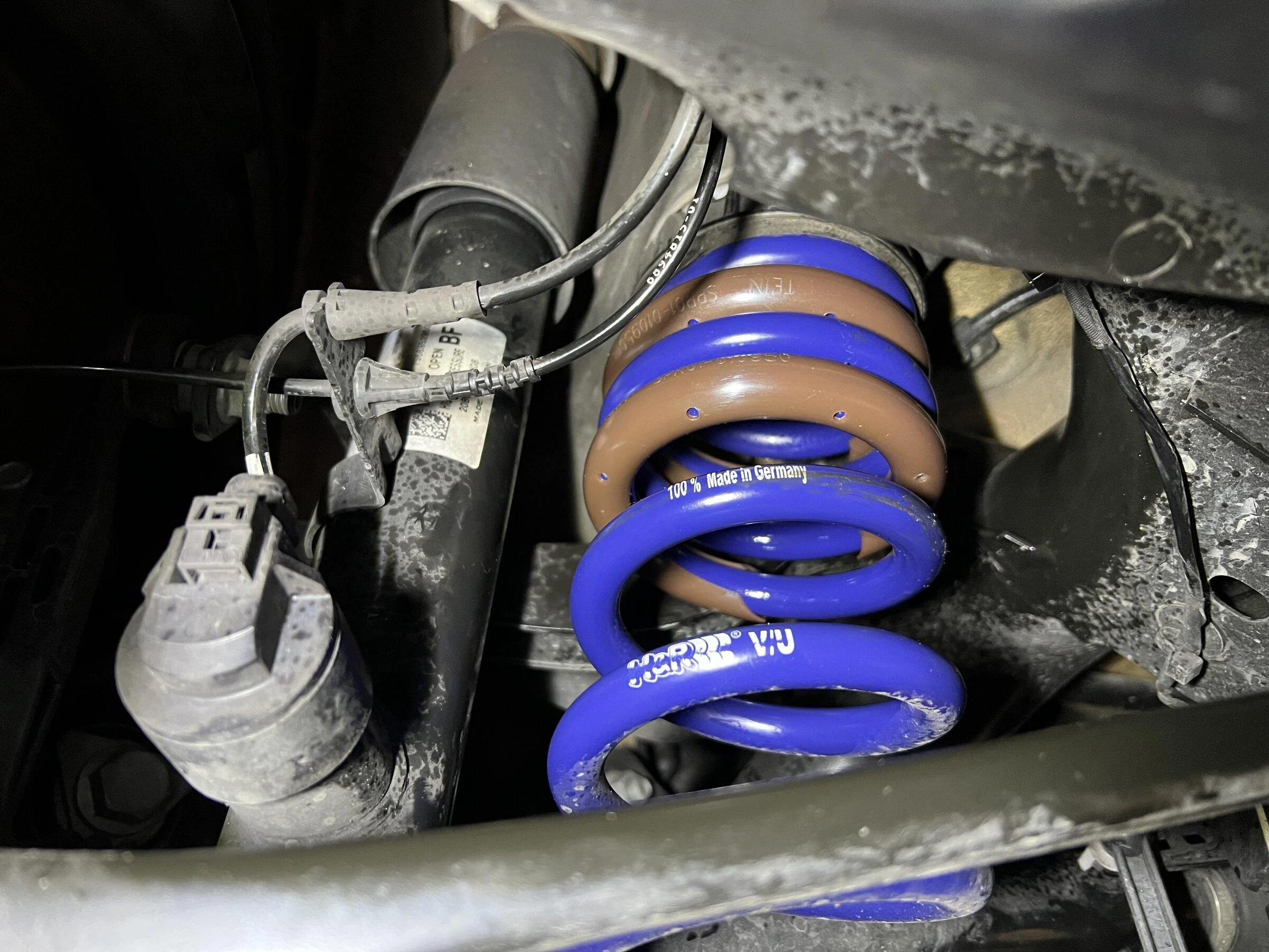

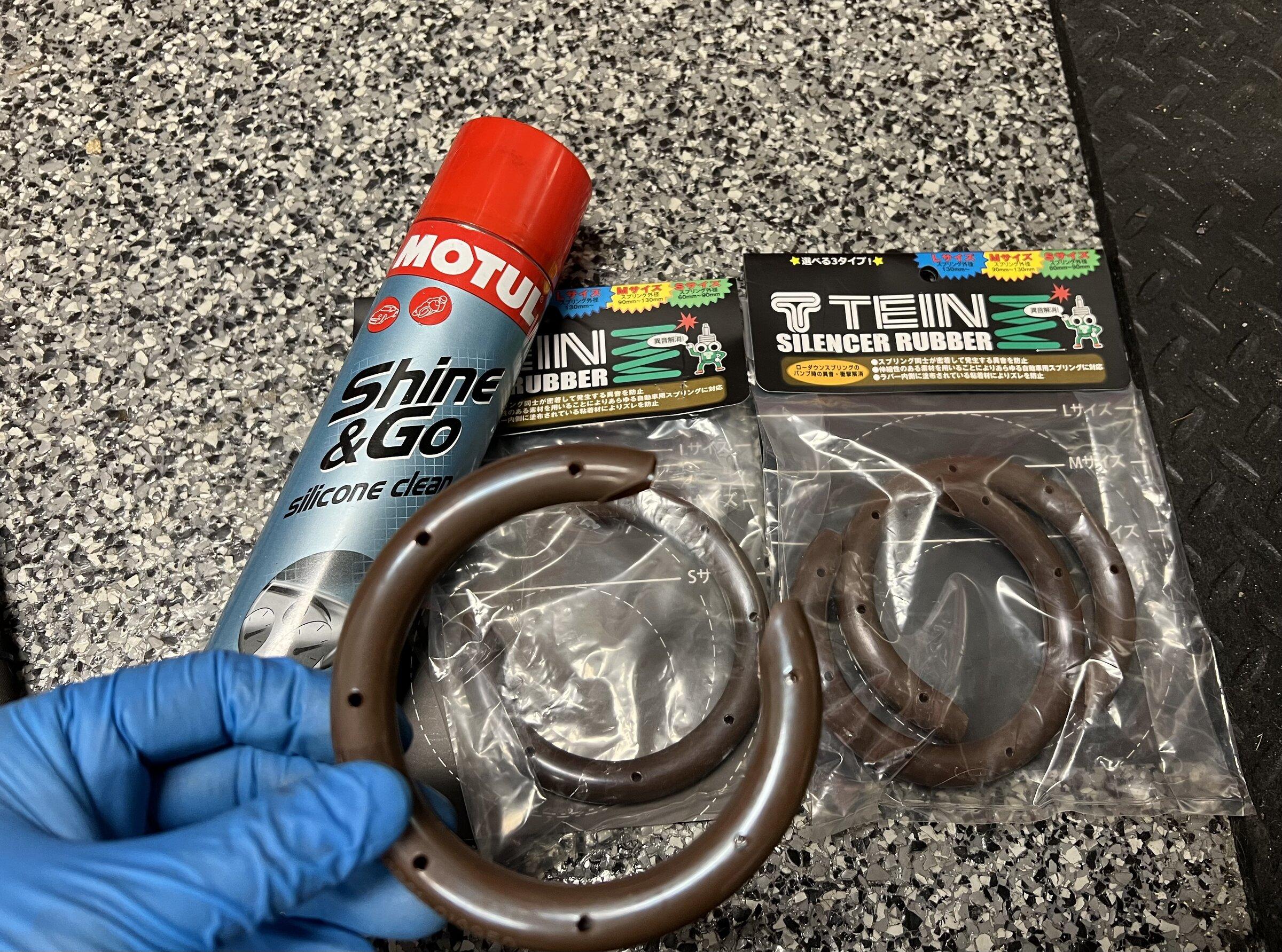

Same here. Triple checked the rear suspension and striped the interior to diagnose, still couldn’t figured out the cause of the clunks (metal to metal) from the rear. It only took place when driving thru small bumps/potholes. Decided to give the silencers a try and they completely solved the problem. Here are some pictures of The silencers installed. I used two per side just follow the run of the springs and space them out as instructed. *no need to remove the wheels, and I used silicone grease to make the install easier.
