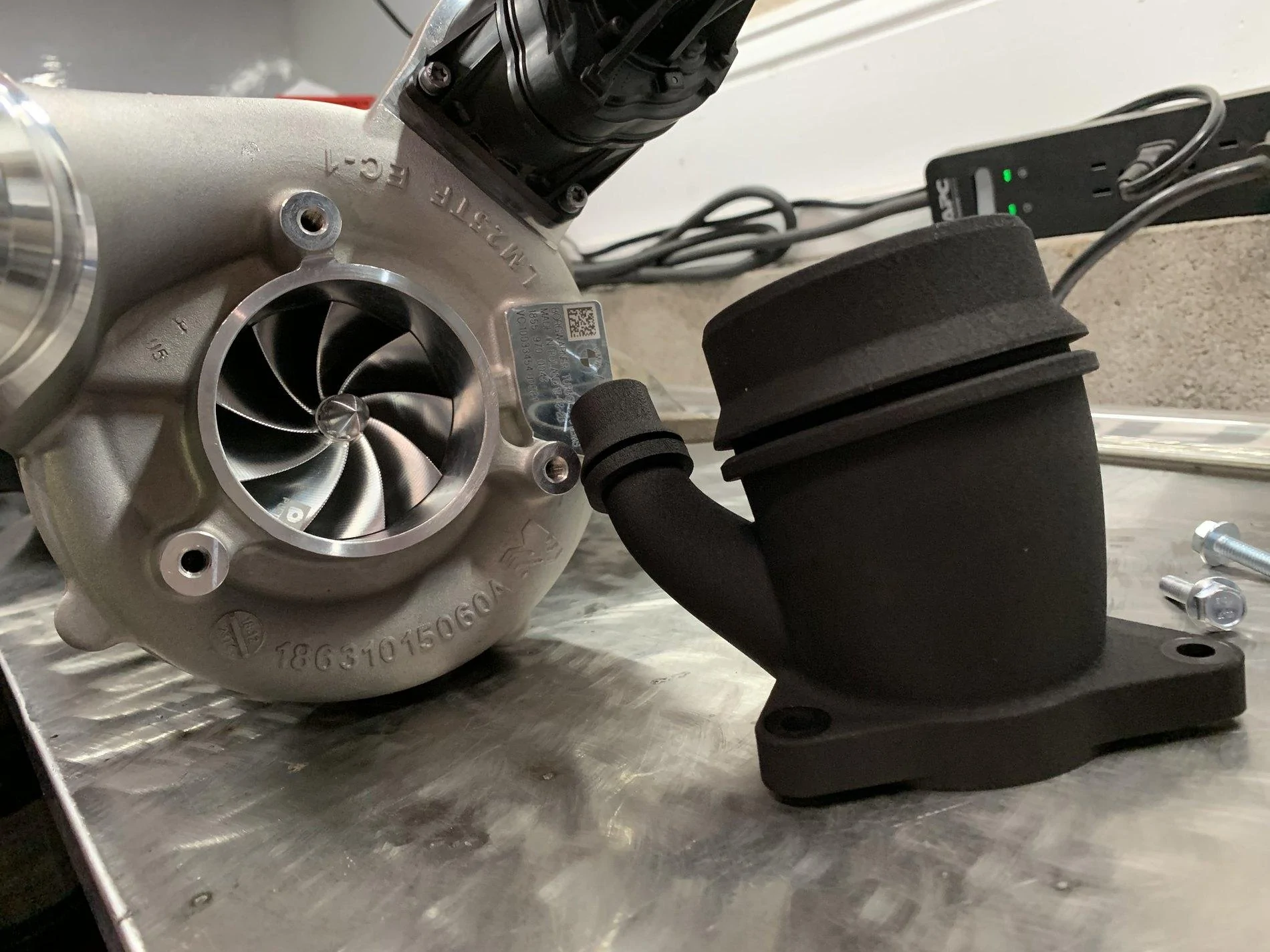

    Pure Stage 2 Turbo
    Euroformance Catless Downpipe

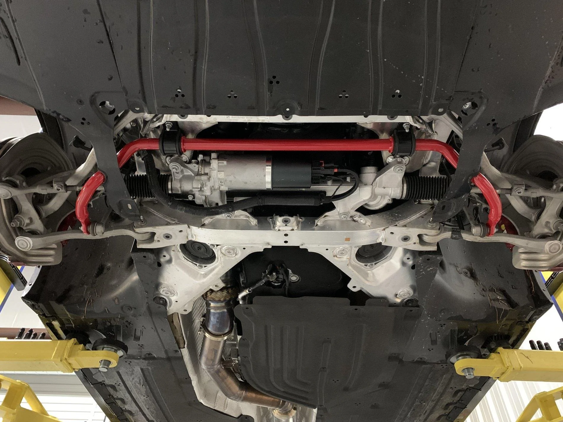

    Cusco Front & Rear Sway Bars

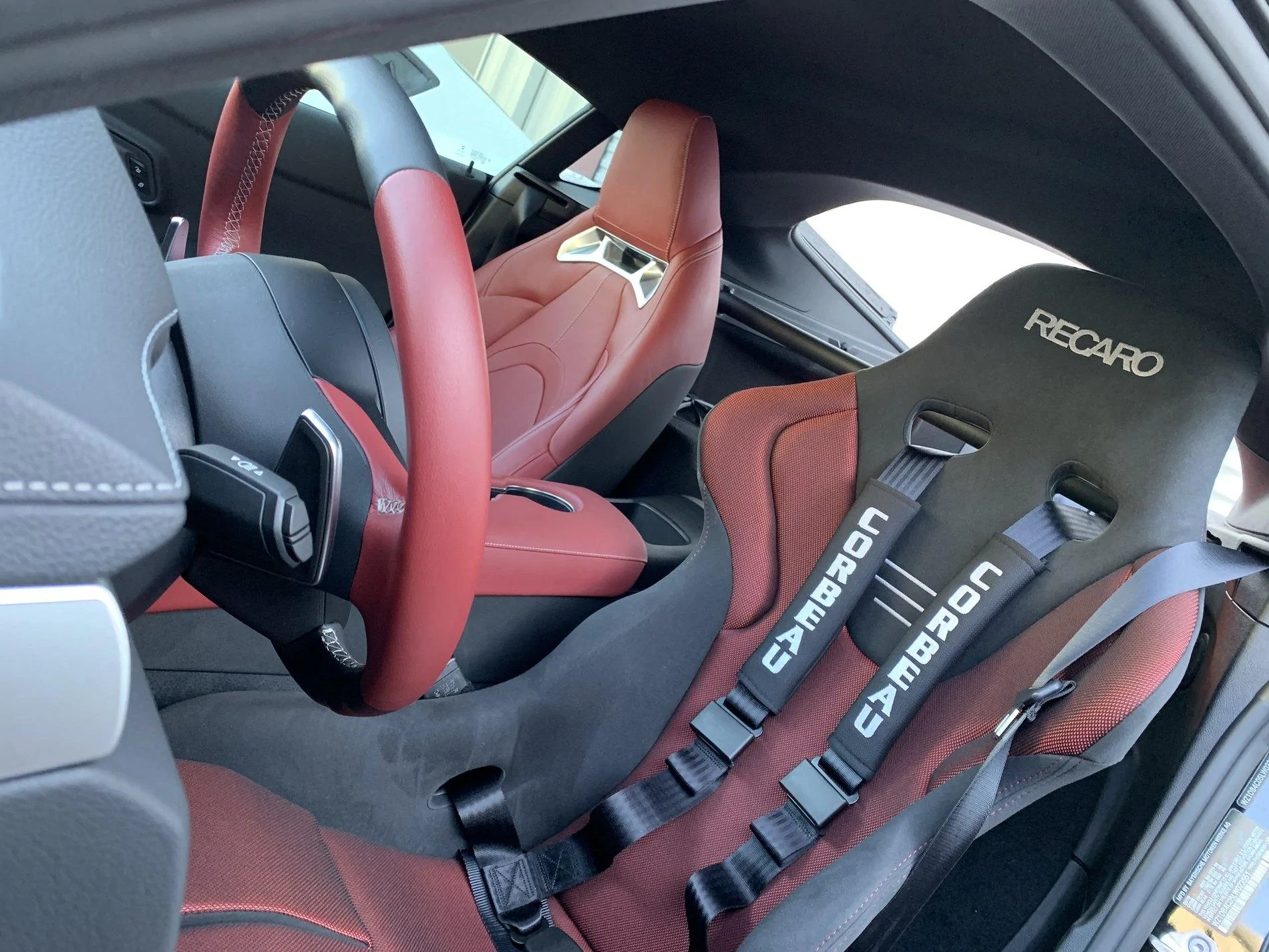

    Recaro RS-GK Fixed Bucket Seats
    GTNC Seat Bases
    Corbeau 4-Pt Harnesses
    Cusco Harness Bar (Powercoated Wrinkle Black)

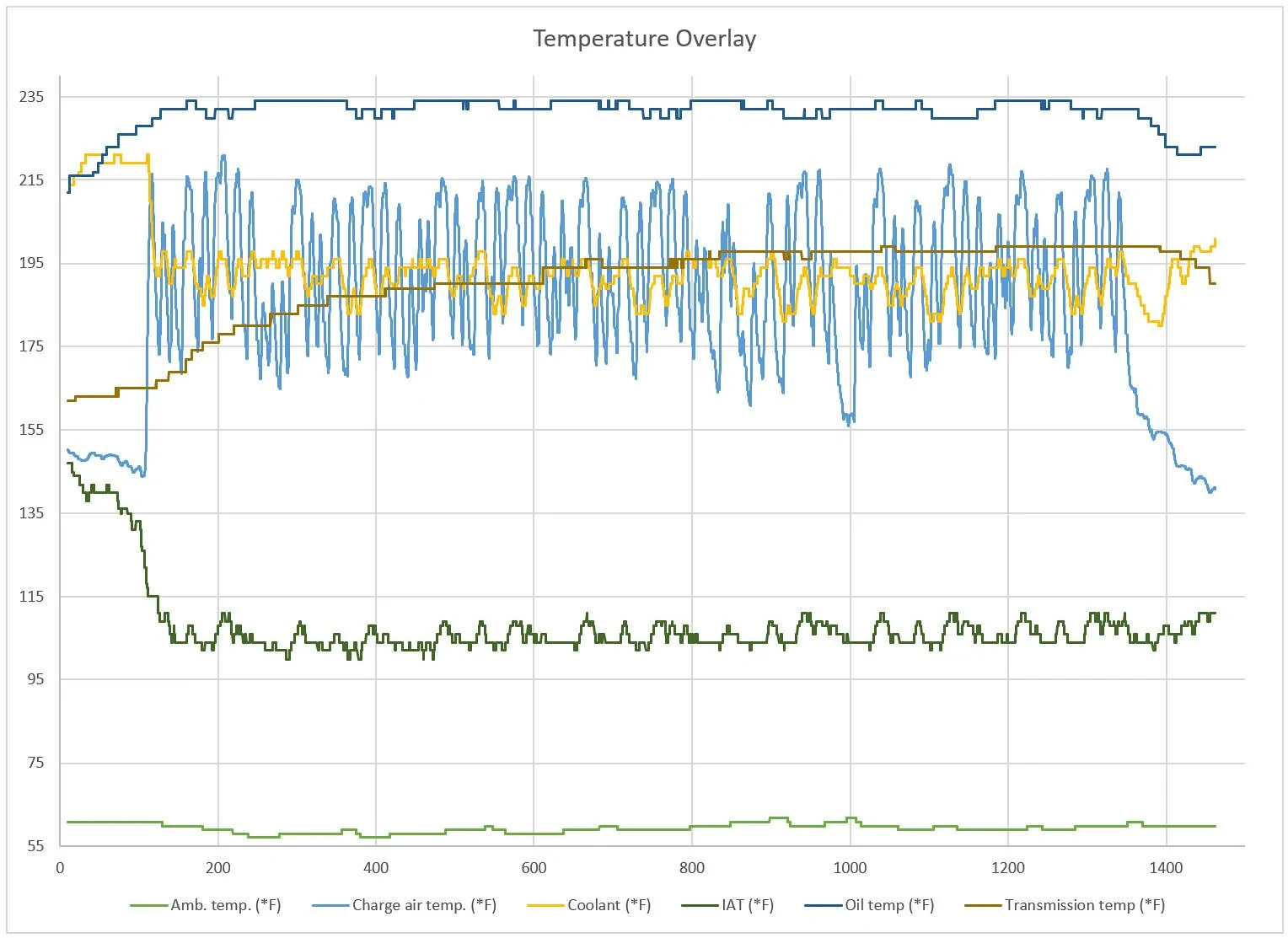

    I had a request to post some data, specifically temp data on track with the mods. So here's a quick overlay of all the pertinent temp data I can gather using the MHD logger.
    This data was taken during a single 20min session on Thursday at VIR in the Grand configuration. As you can see from the data, the ambient temps outside were sitting right around 60F for the majority of this session.
    For those unsure, the X-Axis is just time (s) and Y-Axis is temp (F). Everything looked to stay in check, with every temp recorded reaching an equilibrium state relatively early in the session, with the exception of the transmission (which I find pretty interesting). Peak temps were all very reasonable in my opinion, especially oil and coolant temps.
    After looking at this temp data, I am not super concerned about the need for a cooling solution just yet on the car, so I will continue to focus on suspension and brakes.
    If you guys want to see anything else, let me know!

    Awesome build so far!
    Have you noticed any dips in oil pressure in higher G corners?
