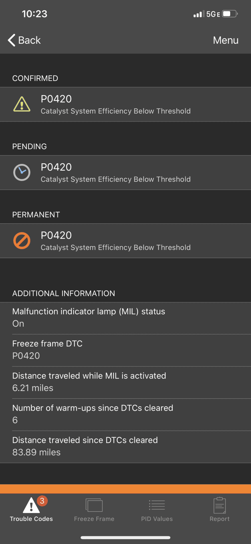

I have the OBDLink Mx+ however I can only read the codes with the car running and when I go to erase the codes it errors since the car is on . When I try to read the codes by simply turning ignition on by just pressing the start button and no brake there is no cel light and it reads no codes . Any idea on how I can reset the cel light ? Even tried a older wired scanner and same thing can’t reset code with the car running . Yet won’t show the code without it running . Weirddd . It’s a 02 code for my catless down pipe .

Whats the permanent code? Screenshot?

Just the permanent p0420 I posted in the earlier screen shot . Cleared the rest but the permanent saved . Made it about 30 miles and cel came back . To be expected though with a catless down pipe and intake . After I get it tuned this upcoming week should be good to go
