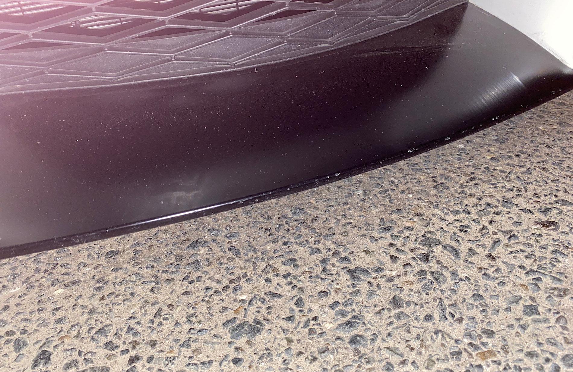

Stupid me bumped a curb whilst parking..
Was enough to chip of the black paint on the edges
You can see cement residue from the parking curb :cry:
Walked out feeling bumper was f*cked and was shocked at how the lip prevented any damages
Noticed the 3 piece design.. Dealer here knows nothing.
Can anyone check if centre piece is separate and what the part number is?

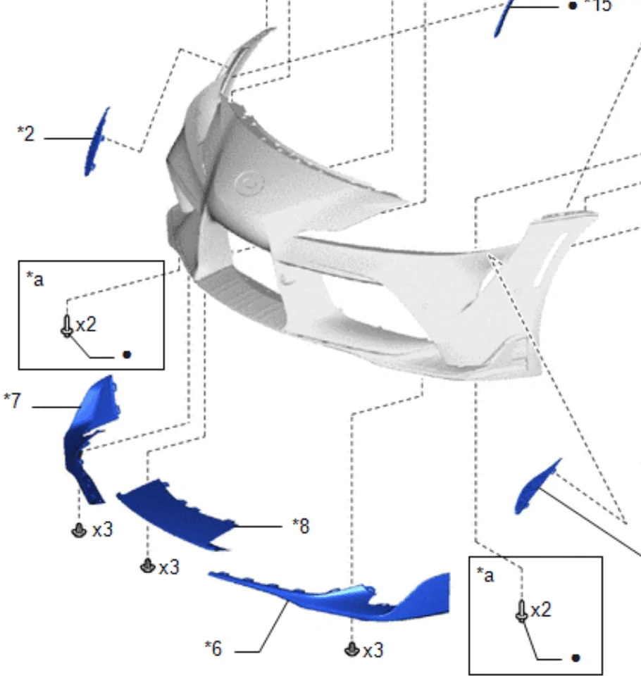

FYI, it's not depicted in the picture, but the sides are attached with push-pins (3 each I believe), whilst the mid one uses 3 bolts and hooks on to the bumper. You can use a trim tool to free those clips that hook on...
So, you can take them out without having the need to take the whole bumper out.

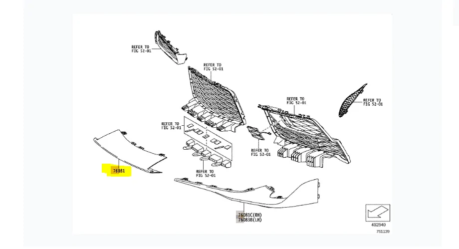

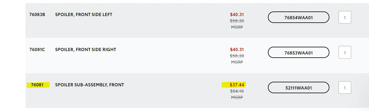

Have some damage on my center lip as well. Was able to find the part on Toyota parts website thanks to the information here.
Can you guys help me with the removal instructions. I want to do this without removing the front bumper. I see that there are tabs holding this thing. Can this be done at home without lifting the car and without removing the bumper?

They're 3 separate pieces. It appears they're held in by an assortment of clips, tabs and 8mm screws.
I took a peek at them when I installed my Maxton front lip - doesn't seem to be too difficult to replace.
@a90moe and @Dooo listed the parts number above. Should've be that hard to remove, just take your time and use a plastic trim remover tool to avoid any scratching.

Where is this photo from? Have any more info on removing these?
