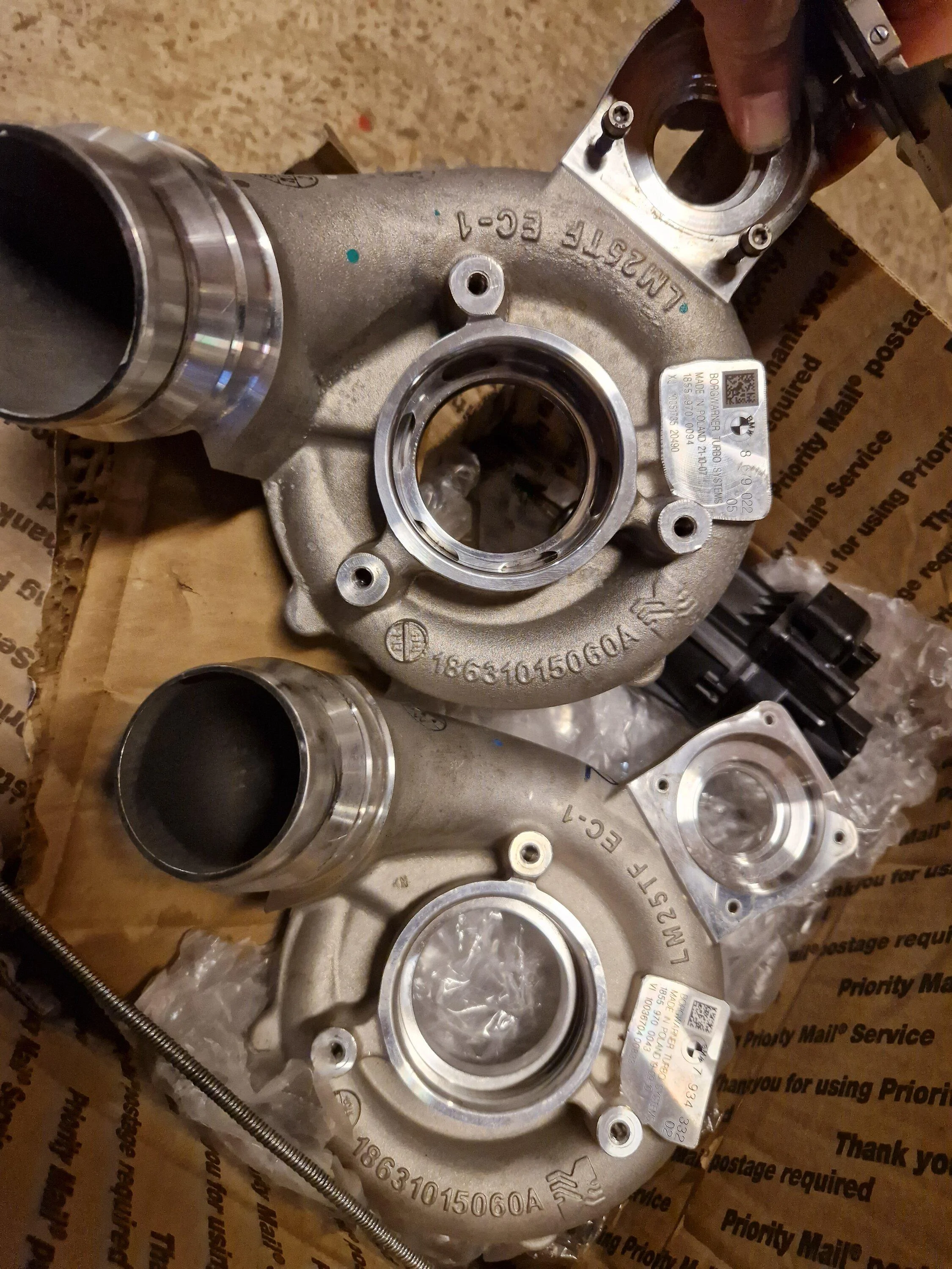

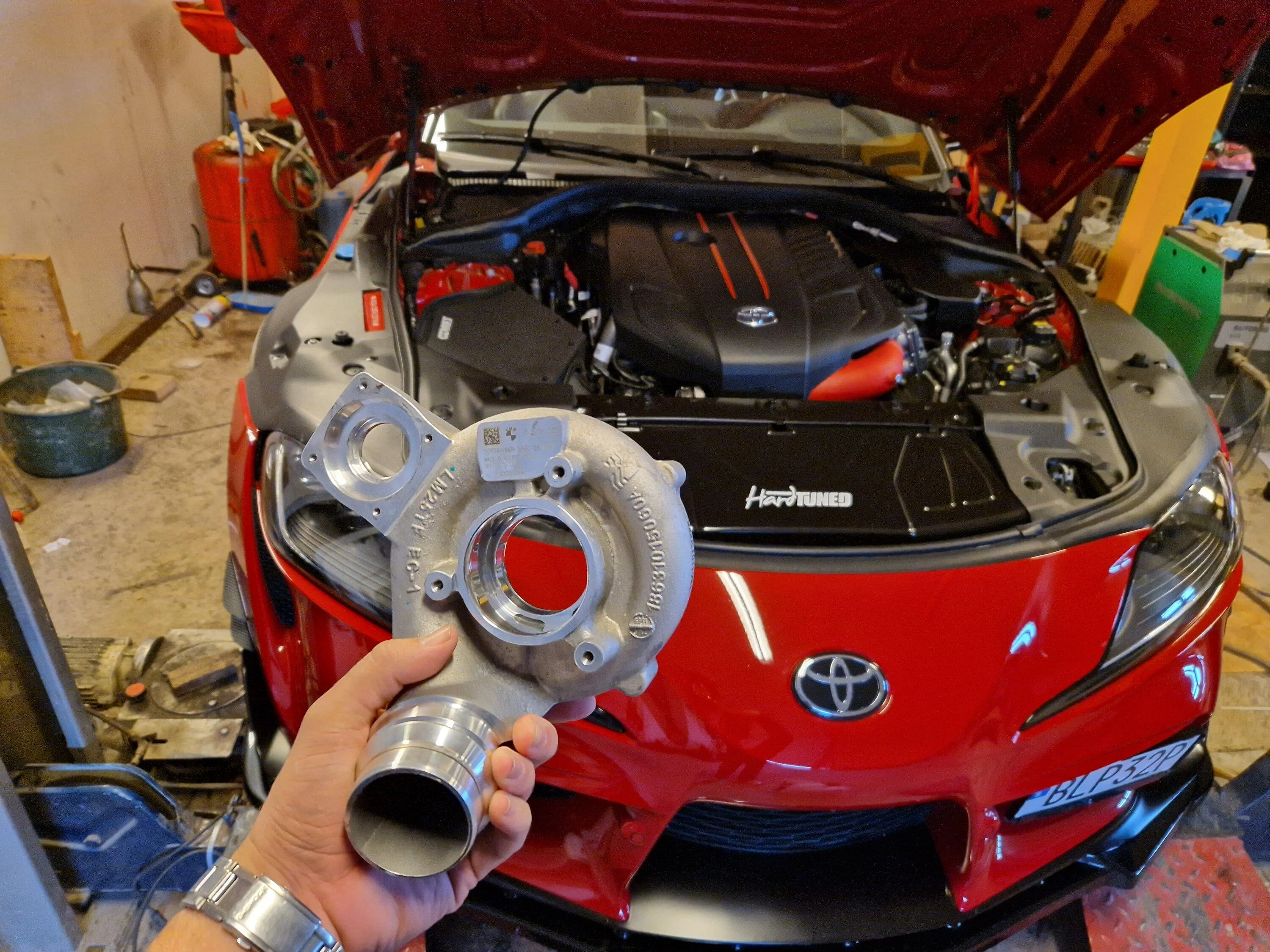

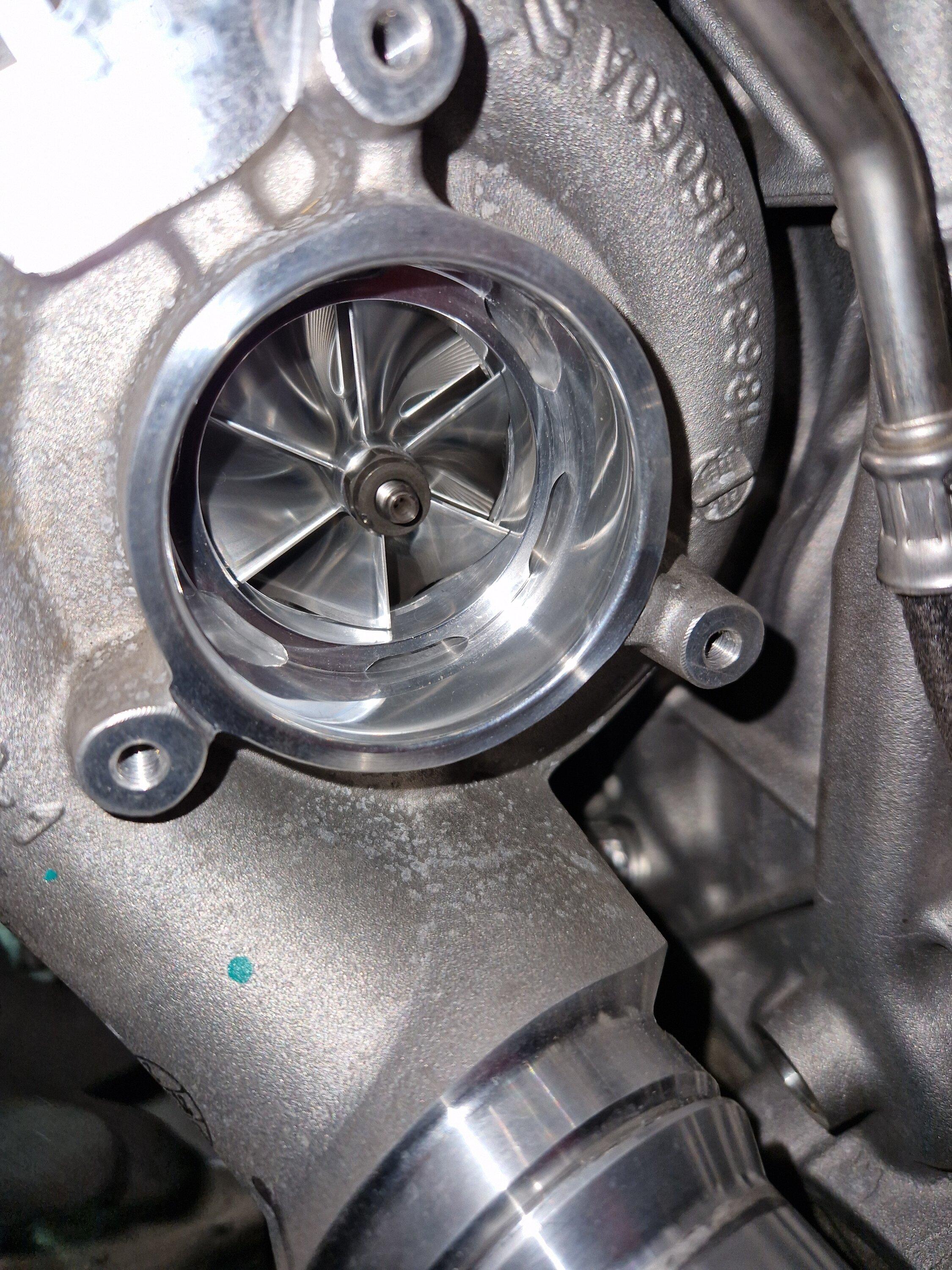

idk if there is a set screw in there or not. As far as I know there is not. My understanding when he explained it is a frozen insert on a heats up housing being pressed in. It shouldn’t go any where. I was doing some work a couple weeks ago and it’s been on since the end of last year, over 9 months now and thousands of miles and still looks fine. That said 9 months and a couple thousand miles is not 9 years and tens of thousands of miles. I’m confident in the work Matt did. He machined a few different inserts and wasn’t happy with at least one not holding its shape when inserted and getting warm. So he redesigned and redesigned until he came up with this one. And he has sold many of them.
as for the turbo sounds, once off throttle you won’t hear anything but the wind down of the turbo. It’s subtle but when I turn it off if you are outside by the hood you can hear it whistle down. It didn’t affect any of the bypass whoosh sounds or anything getting off throttle, but at highway speeds you’ll hear a whine. It was too much for me with the stock exhaust at the time, it with a aftermarket exhaust it blends in great and while you’ll hear it, it’s not unbearable for me anymore. If I did a lot of long distance trips though I doubt I’d run it or the SP1R. I’d probably go with something more quiet. But DD around town and 2-3 hour cruises I have no issues with my setup.

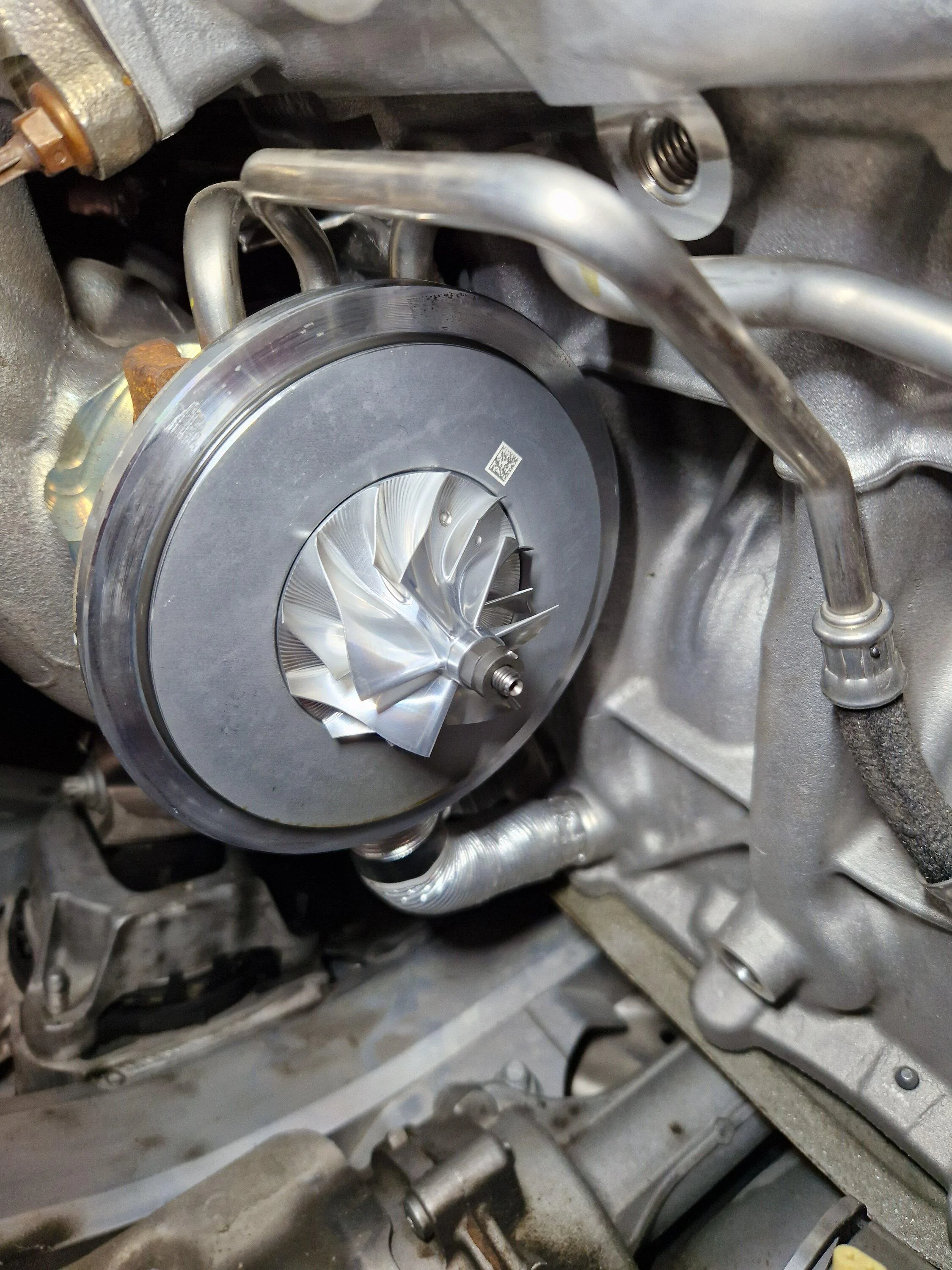

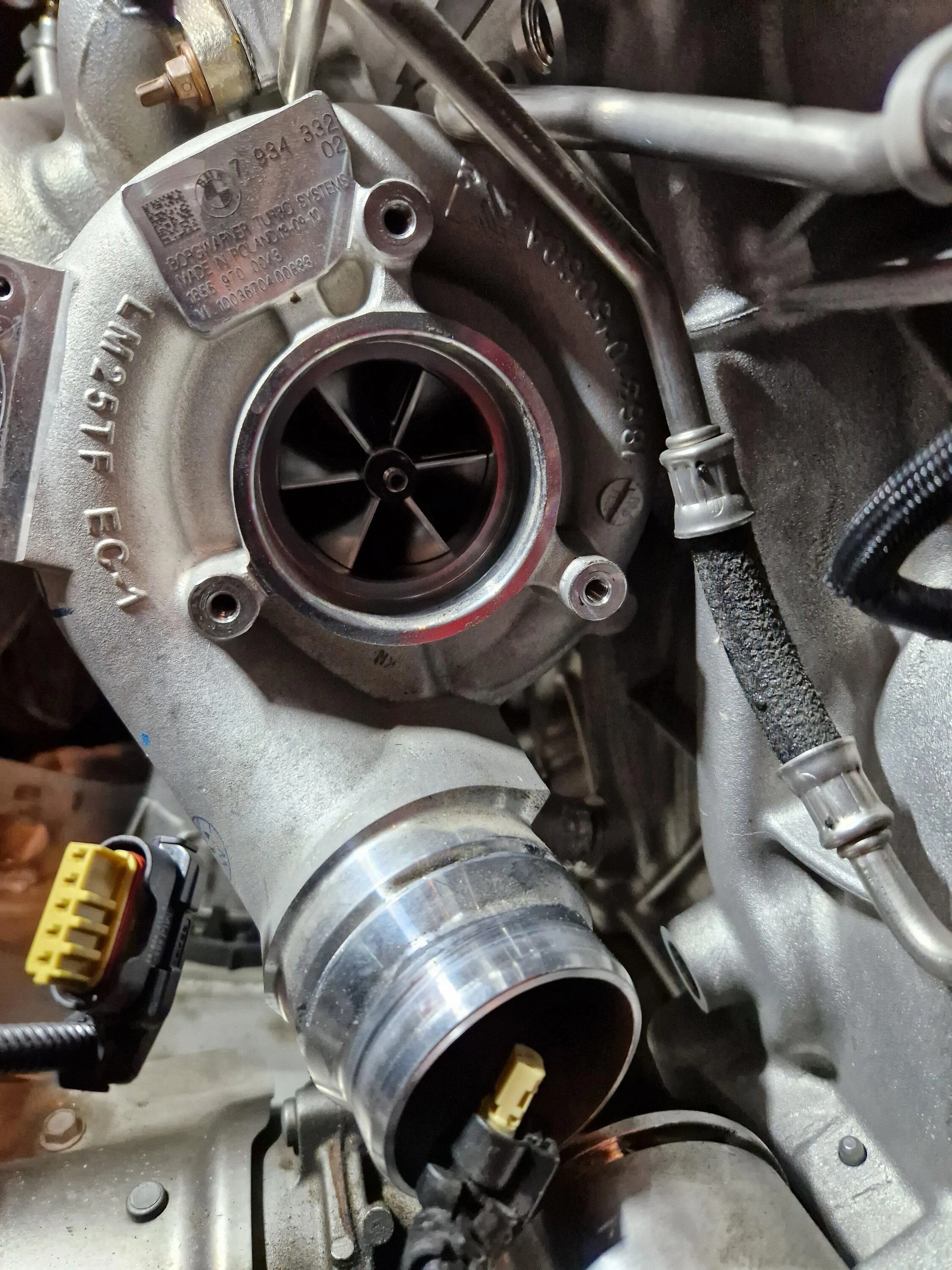

Hey guys people with the 6 port manifold how did you remove the compressor cover? I physically can’t get to the bolts on the right side as you look at the turbo

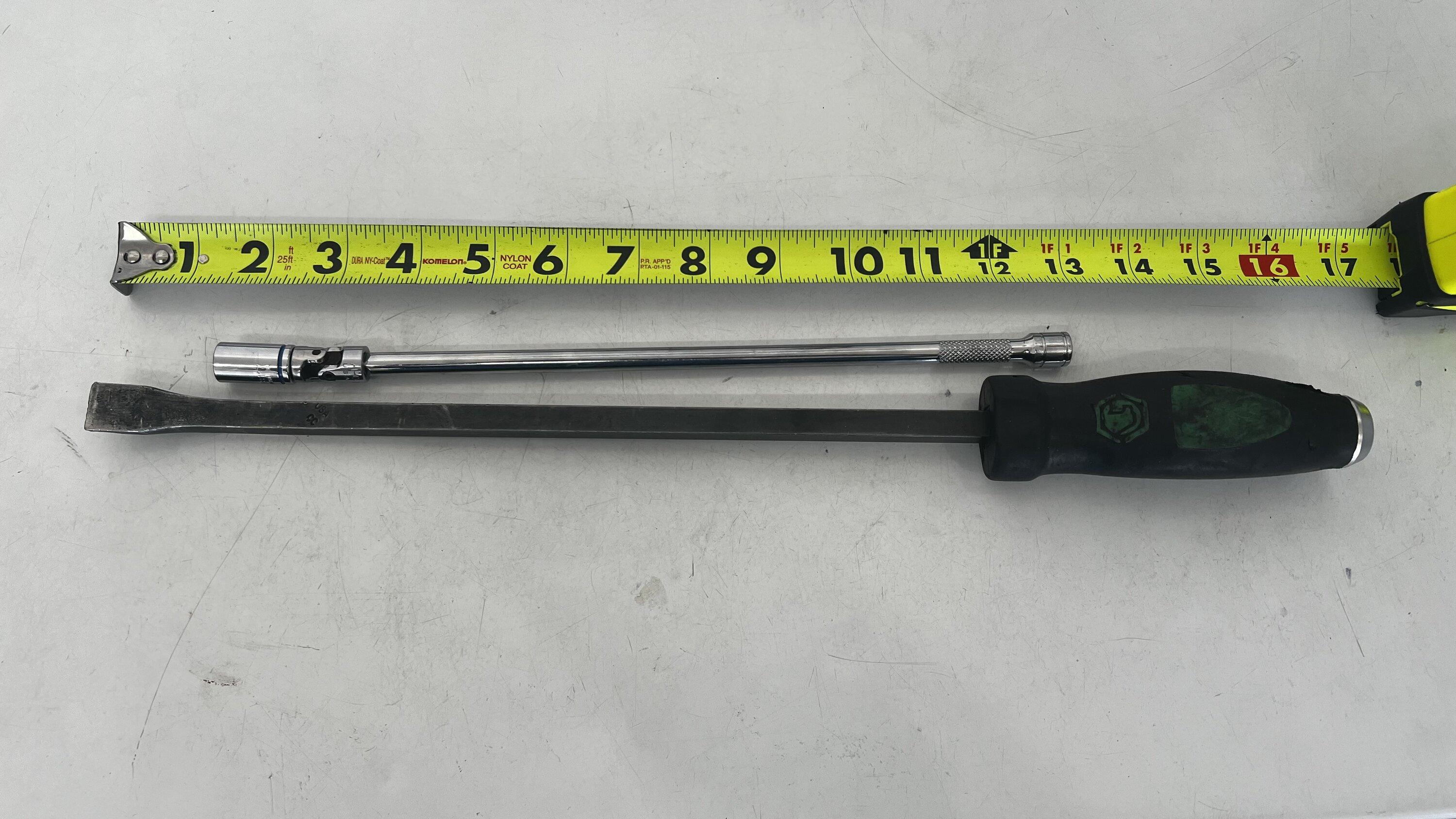

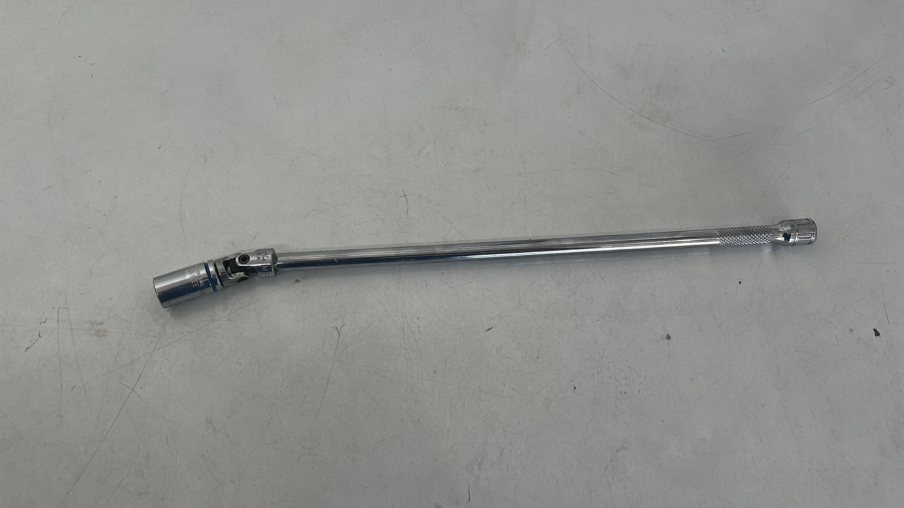

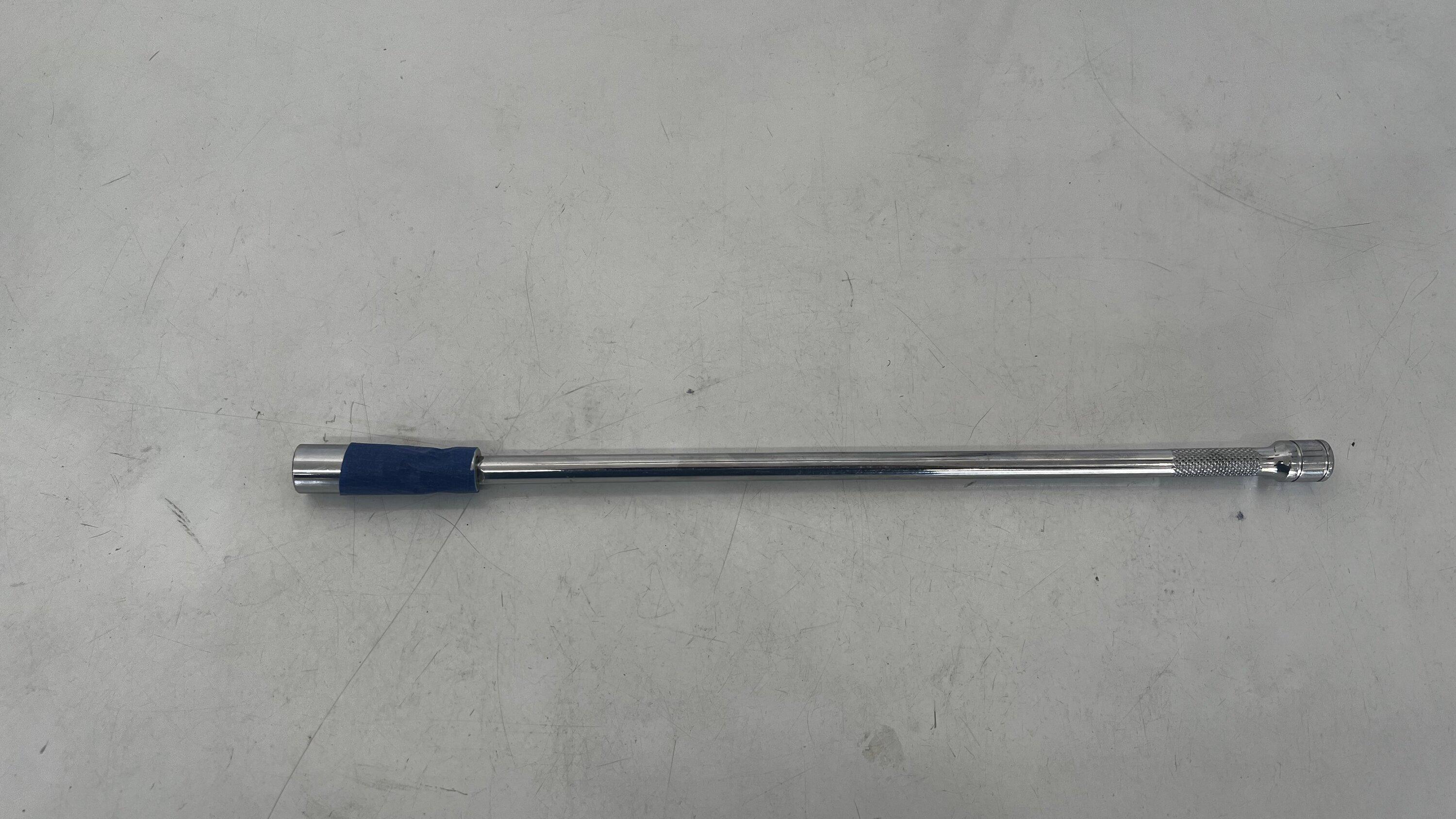

long 1/4" extension and a 10mm socket at the end of a wobble joint, I remove the downpipe and can feed it right through the back there to it. If you have a long breaker bar you can kinda bend the very end of a heat shield out of the way to reach it easier.

Thanks for this but the bolts are on the front? It’s covered by the oil feed line and I cannot remove the housing at all. Is there anyway to keep the turbo in place and remove the compressor housing.
