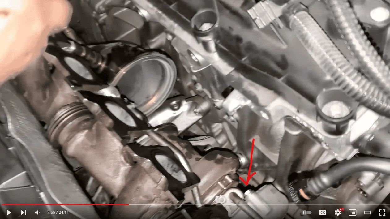

6port, the inner housing bolt is close to impossible to reach.
2mrrw I'll either drop the dp or try to unbolt and angle the turbo.

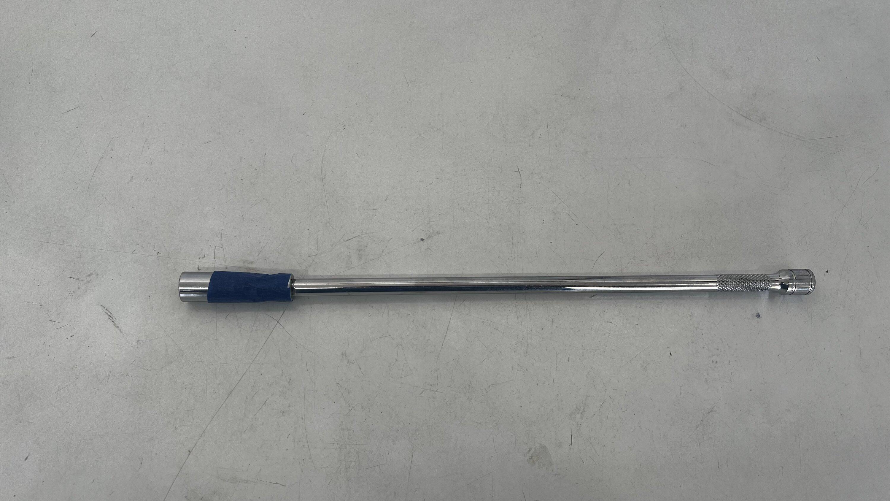

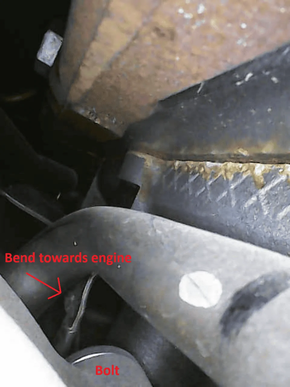

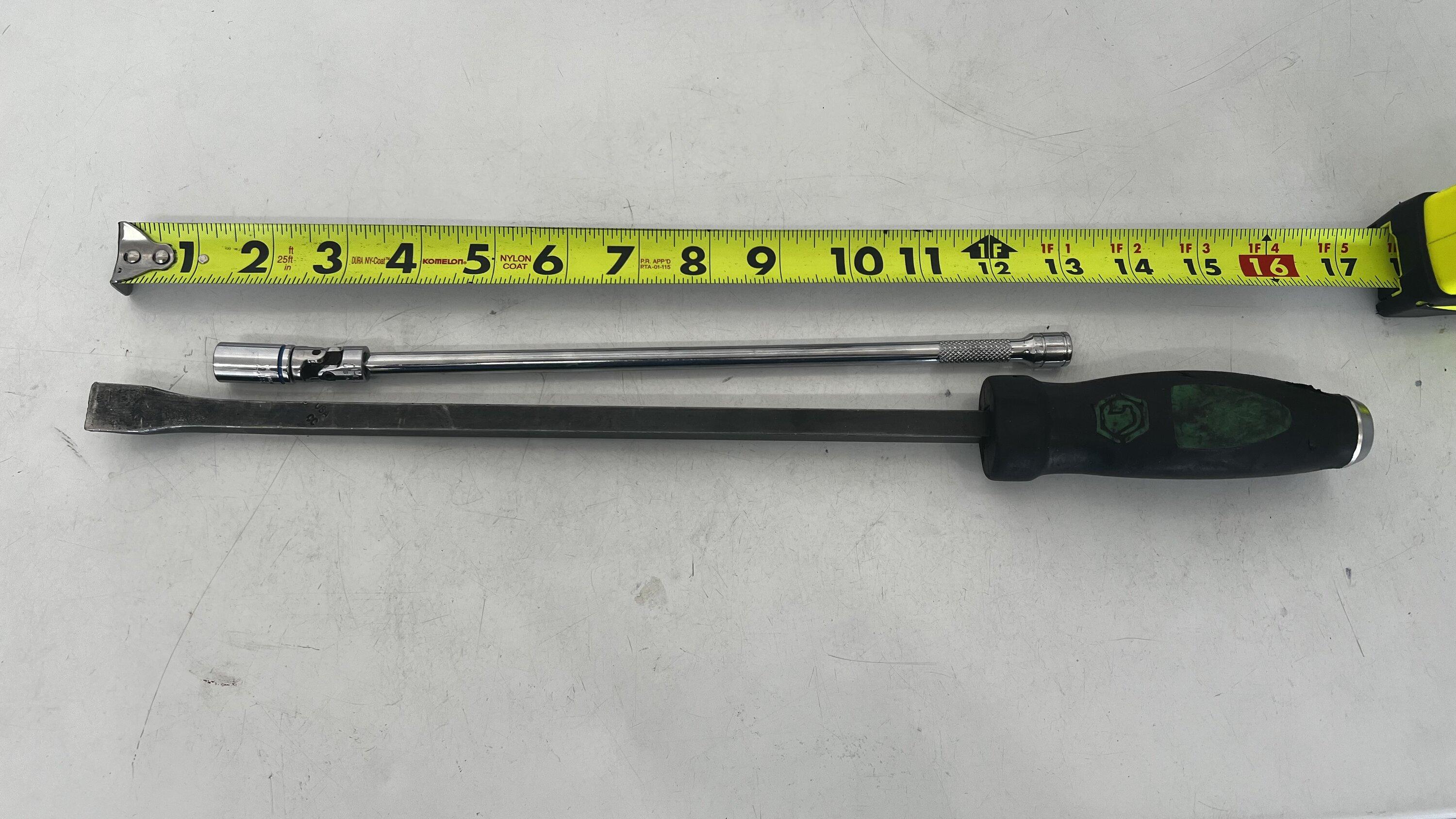

I dropped the turbo first time doing it, but found a way where you don’t have to. Remove the DP, use an extension and a universal/wobble with a 10mm and you can slide up through the back of the turbo. Also if you have a long pry bar you can bend a heat shield just enough to be able to get easy access there. That heat shield is like directly behind the bolt a little offset. Makes it a lot easier bent out of the way.
what I use. I’ve got it down to about 2.5 hours total now. Put a piece of tape on the end of the socket and push it through, thatll hold the bolt on there when you install it. Also do about 1 wrap of painters tape around the wobble and that’ll allow it to move some but stay upright when on its side.

I gotcha, need to drop DP and attempt this method.
Quick pic from endoscope.
