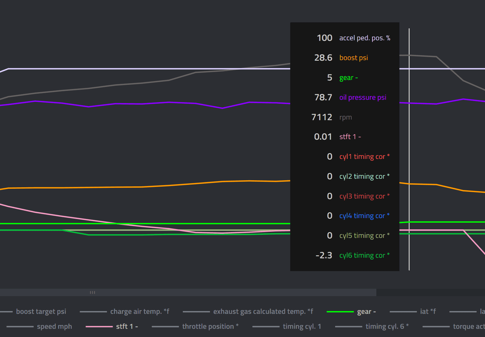

back to this, yesterday i started playing with raising rev limiter. just a small bump first to 7150rpm and car felt good. going to bump to 7300rpm to see how it does.
MA617M
Aug 27, 2017
2,302
5,164
lots
Not starting to feel any choking due to the headifold? I'm assuming you'd see MAF and IAT decrease/increase accordingly?
Twisted Tuning
Twisted Tuning
Justin
Mar 10, 2019
28
1,354
1,707
New York
www.twistedtuning.com
as of now, no. And to add to this, we are still running the stock catback exhaust. going to be trying 7300rpm over the weekend. Since i have not been able to successfully pull the stock TCM file off the TCM yet, im still unsure where the trans will force itself to shift since i haven't been able to view the calibration. So they may be a point where i can raise the Engine rev limit beyond the trans limit and the car shifts before reaching the engine limit. But we will see.

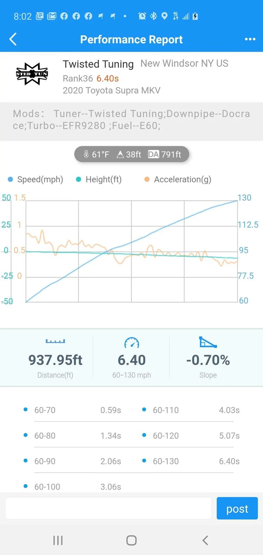

Mar 10, 2019
28
1,354
1,707
New York
6.40sec 60-130mph which is i believe the fastest full weight time. The couple people doc'd on dragy that are ahead of me are all weight reduction and nitrous. And within 1 to 3 tenths of my time. Working on 5sec at full weight. Im also 285lb myself
