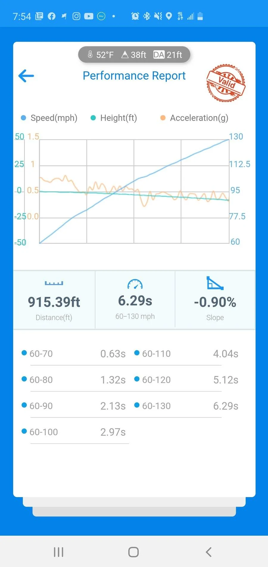

Thanks for the interest and kind words. We actually ran a 6.29sec 60-130mph time probably 2 days or so after that 6.40sec time. Keep in mind we are running these times with a completely FULL weight car. Stock battery, full stock interior, stock catback exhaust and me at 285lbs as the driver. Compared to everyone (like 3 or 4 cars) that has a faster time has weight reduction, no passenger seat, no exhaust, some have nitrous, and the list goes on. but you get the point.
Our goal is full weight just boost everything. Because that's how 90% of the owners are going to use that their car. Most wont add nitrous or take everything but the drivers seat out. or replace the driver seat for a CF lightweight one. No knock on anyone that does any of that. Later on if we really want to lower our times. we will pull everything out of the car and i'll let my partner drive at 150lbs.
Tuning Platform, I use MHD and Ecutek on this car. These times were posted on stock wheels and a 295 width R888R on the rear and stock tire on the front. We haven't even put the drag setup on and posted a 60-130 time yet, with the drag setup, should knock another tenth or so of the 60-130mph we are trapping 137mph on the street with a 2.1sec 60ft via dragy. current record is 9.7 in the quarter at 139mph for comparison. We spin thru 3rd almost on the street, lol. All tracks are closed in our area.
There are a couple people working on trans stuff. Im one of them and as mentioned @p2uned is as well. And i think i saw a post of something another tuner is working on. But nothing yet. Im sure trans stuff will come.
