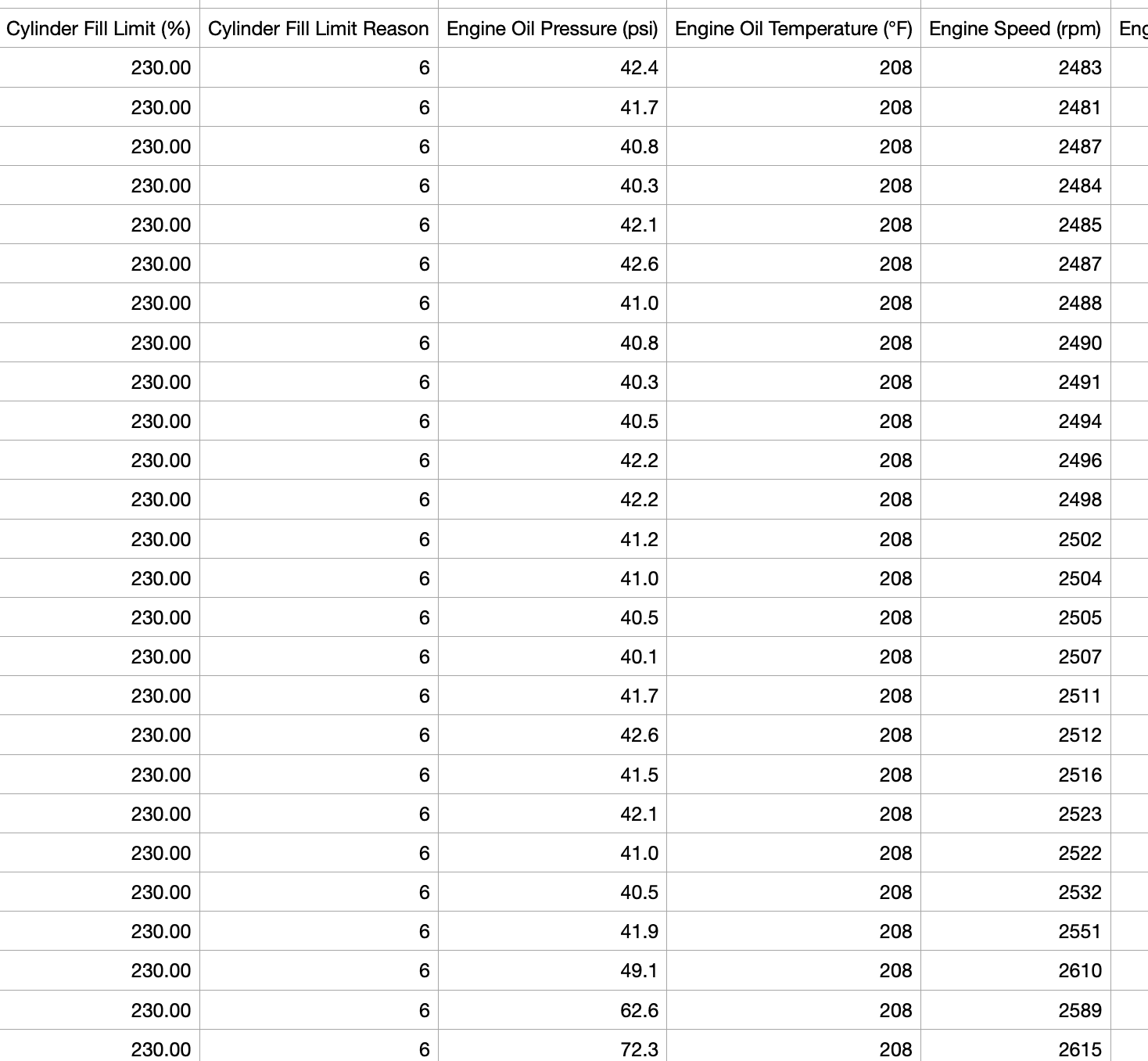

Actually just found this one from a few days ago. Didn't realize I was logging. Just a 20-30 minute cruise, no heavy throttle.
Yeah thats quite a bit cooler than mine then.
Im guessing you dont have any logs when you had the 0W20 oil.
Either way Im gonna change to a thicker one pretty damn soon.
If 208 vs 230 makes any real difference for long term use - thats out of my league of knowledge when it comes to this motor. 230 isnt really that high, just wondering what this will peak at. Better try it tomorrow 🤓
It's also 30(f) degrees outside.

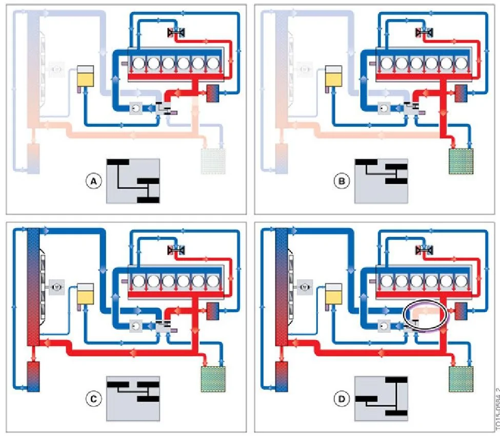

Yes completely normal
Modern engines like the B58, during coldstart... the cooling circuit gets bypassed.
Only when the engine is warm, the full coolant kicks in.
Old engines don't have those 'smart heat management valves/system' in place.
Mostly to do with emissions (reason why the oil is also hotter during normal operation on modern engines then older engines).
See explanation below from a B58 manual
Figure
A = Cold start
B = Warm-up phase
C = Operating temperature
D = Maximum cooling requirement
Cold-start phase, Figure A
The short-circuit line is 100% open in the cold-start phase. The coolant connections towards the
radiator and heating are closed
Warm-up phase, Figure B
During the warm-up phase the connection to the heating is opened in addition to the short-circuit line. The line from the radiator remains closed.
Engine at operating temperature, Figure C
Figure C shows the control in normal conditions (operating temperature). The cross-sections to
the corresponding connections are opened to a greater or lesser extent depending on the coolant temperature, so that coolant can flow through the minor and main coolant circuit and the heater circuit.
Maximum cooling requirement, Figure D
The radiator connection is opened by 100% and the short-circuit line is completely closed to provide maximum cooling at high dynamic loads and/or high ambient temperatures. In this process, the heat exchanger for the heating system is blocked by 90% to be able to provide the radiator with even more volumetric flow.
The coolant connection to the expansion tank is not controlled. As a result, it is permanently open so that any coolant demand in the coolant circuit can be compensated for by the expansion tank at any time.
