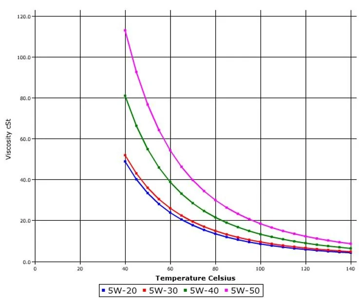

If that isn't how it works then how is that real life results that i have seen many times? I don't care about what F1 does, we have normal passenger cars, not multi-million dollar race cars built for every aspect of hp possible. They don't care about longevity as long as it makes power and last 1 race. They run something like a 0w-70 anyways and dont think its anything close to normal oil.
I think you are getting confused on what I am saying. I have not once said run a crazy thick oil in our Supras. No, not even close. I have said oil weight has to do with clearances. Same as you. All I have been saying is A - a thicker oil is better since it typically has a better load capacity (this is in general and not specifically related to a supra) and B - thicker oil runs hotter. How and why is we can disagree on.
One thing I do know is that I have more actual hands on experience about this exact subject then you with real world testing. No here is a link or a chart, I'm right! Specing out engine builds is what I do everyday and I have enough Baja 1000, formula d, Rolex series and 6 second drag car builds to back it up.
