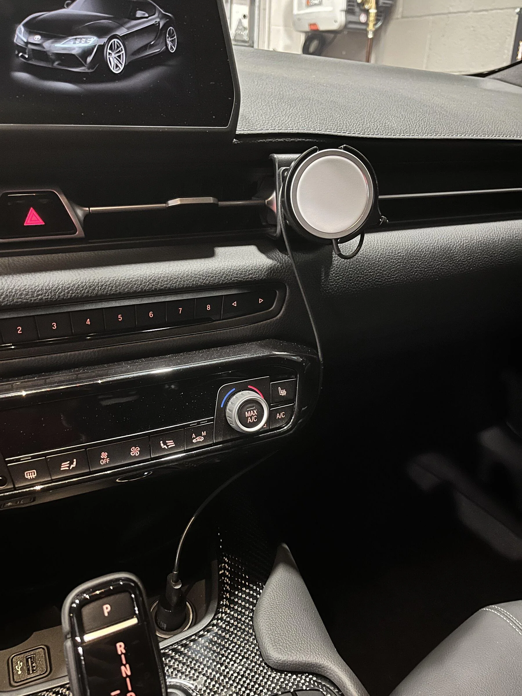

I think what people dont realize is its not just a wireless charger, it is also a cellular repeater, and the combination is what causes excess heat. I threw in a proclip and a magsafe charger and it does all I need. Id highly recommend it.
Please share with me about these products.... I'm intrigued......

For the MagSafe car mount, I would recommend the following;
  1. ProClip car mount for GR Supra $34.99
  2. ProClip MagSafe iPhone Holder $39.99
  3. Apple Magsafe Charger $39.00
For my iPhone XSMax, I personally replaced #2 and #3 with the following;
  1. ProClip iPhone holder - Rugged case $39.99
  2. Anker USB-A to lightning cable, 3 feet $15.99
Note: A wire is the most efficient way to deliver power to your phone, eliminating the power needed for the wifi radio, and wireless charging. Also the iPhone XSMax does not support the magsafe system ... only Qi Charging (i.e. no magnet). Only the iPhone 13/12 are MagSafe compatible.
