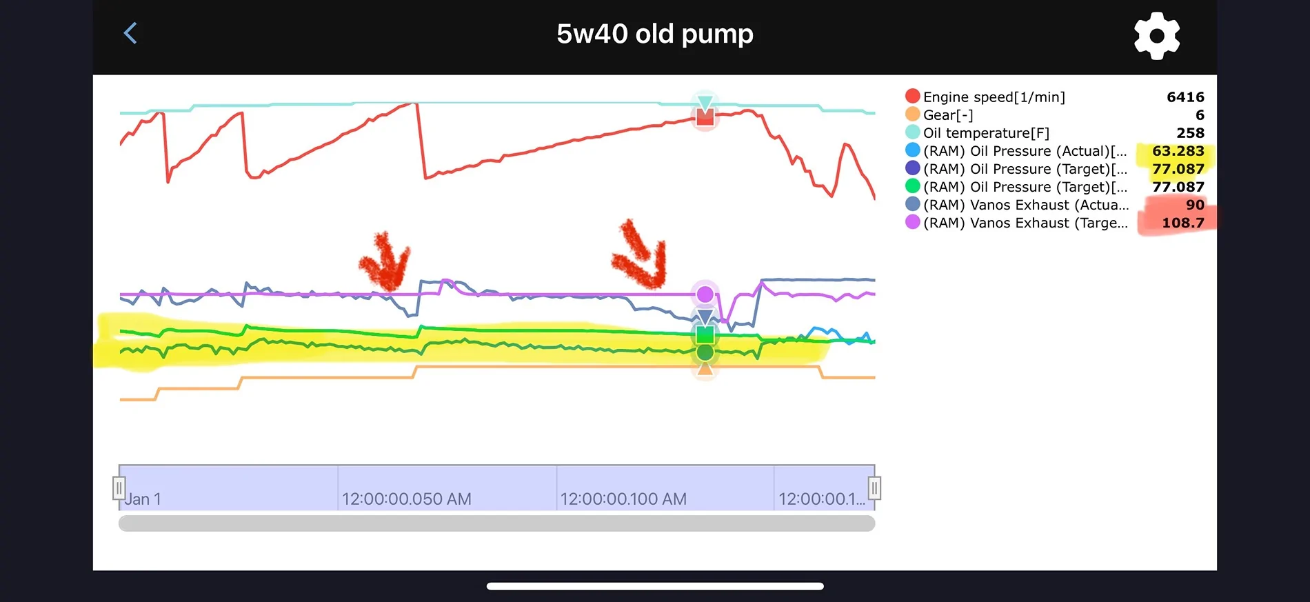

Data log 5w40 old pump
Here’s a screen shot with the old pump. Notice oil temperature is at ~255F, and oil pressure off target by nearly 14 PSI. Actually, for the entirety of the straight, you can see in the highlighted section that the pump fails to hit target.
Additionally, we can see our cam walk. You’ll notice highlighted in red that cam falls off target by 17% towards redline. The red arrows notate where cam timing deviates.

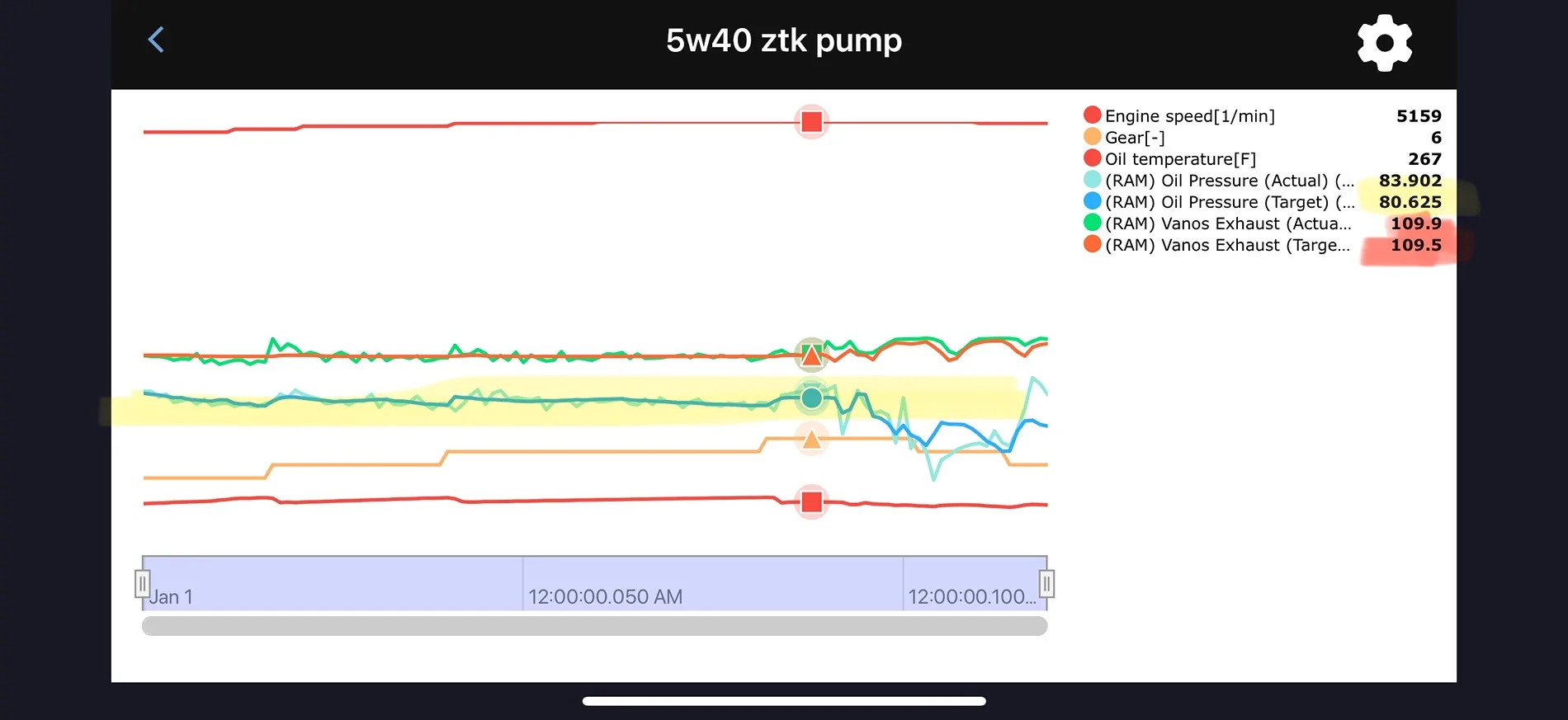

Data log 5w40 new pump
Here’s a screenshot of the new pump. Oil temp is even higher at 267F. We can see oil pressure highlighted, and both actual and target values are completely superimposed over each other. VANOS Exhaust actual and target are also both completely superimposed throughout the pull.
Based on the results, it’s clear to me the ZTK pump is confirmed to have higher output than the older pumps.
