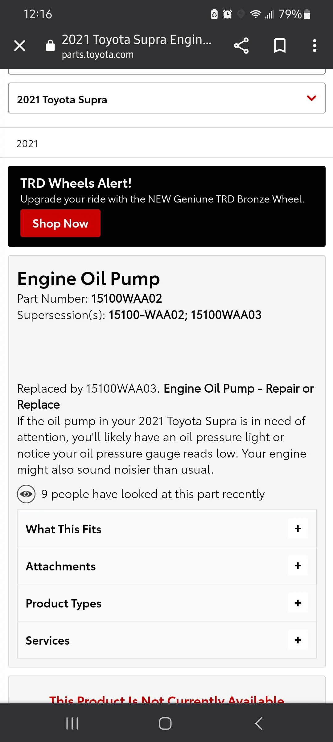

Looks like there is a new part number too - looked up a 2020 Supra
Engine Oil Pump - Toyota (15100-WAA03)
SKU: 15100-WAA03
  • Other Names: Pump Assembly Oil
  • Description:
    GR Supra.
  • Condition: New
  • Applications: 3.0L.
  • Replaces: 15100-WAA02

Here is the BWM Info for 2020 Z4 M40i - looks like new part too.
2020 BMW Z4 OIL PUMP
Part Number: 11418646453
Replaced by: 11419895359
SKU: 15100-WAA03
  • Description:
    GR Supra.
  • Condition: New
Interesting I wonder when they decided to start implementing the New part And which one I have..

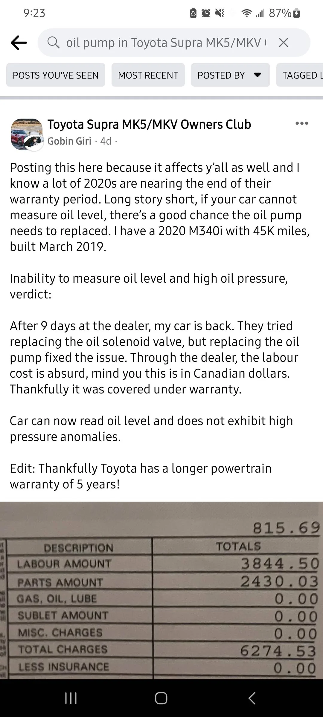

They replaced mine because I couldnā€™t measure oil level properly. The sensor was also broken, so I had extensive work done just to get that working again. Then still was burning 2quarts every 1000miles.
Eventually they opted to replace the entire long block.
Glad I sold it.

My 2020 wouldn't read oil and had oil pressure issues. Subframe drops to get to oil pump. 30 day wait just for new torque to yield sub frame bolts. All in all a huge huge headache at around 20k km. Not sure if the replacement oil pump was an updated version or not but I ended up trading for a 2023. My 2020 also kept having evap leaks. Figure I'd give another Supra a chance.
