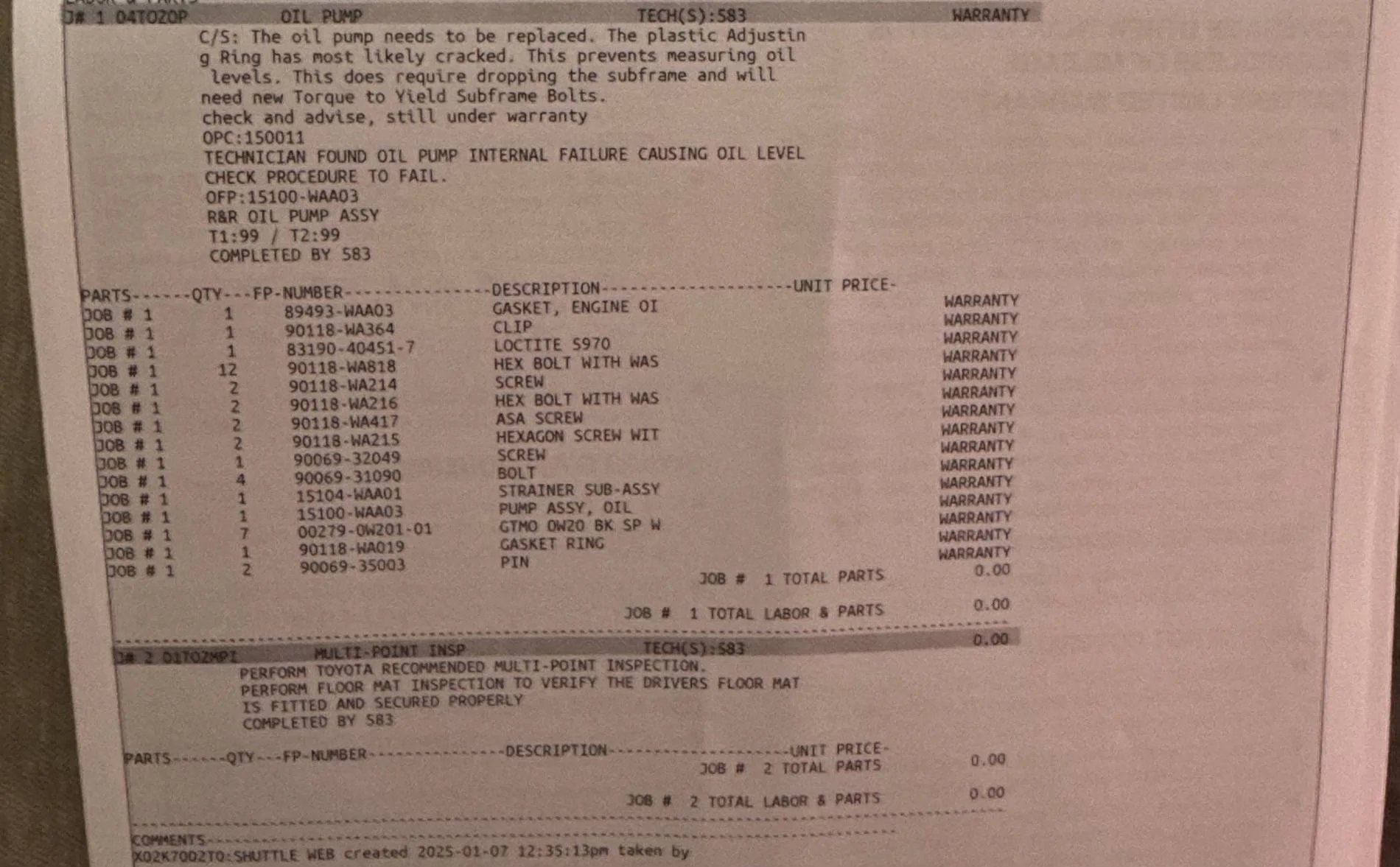

Oil pump tsb?
Booly
Bilal
Feb 23, 2024
Austria
Toyota Supra A90
This looks correct. Don’t forget to buy the Subframe Torque to Yield bolts, they’re single use. My dealership bought a lot of stuff to replace. Even new rubber grommets and such. I’ll see if I can find the paperwork.
would be gr8 ty!
