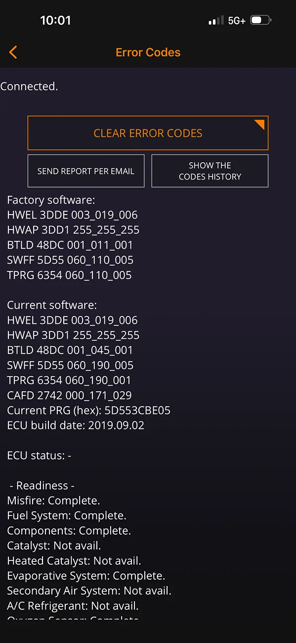

How do I check for that to see when mine was last updated ?

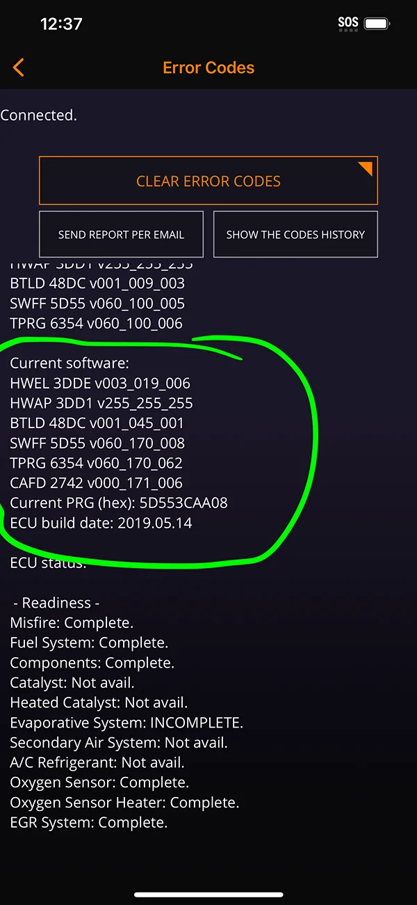

You can check your SWFF and BIN version via MHD:
Here’s mine, with that being said are you able to tell if I would need a software update or just plug and play oil pump:) fingers crossed!

You do not need any software updates to swap out the oil pump. I had mine done earlier this year. I have an unlocked DME on my 2020 from factory. I haven't even done any of the recalls. They just swap the pump and you're done. Nothing needs to be done with the software, won't effect your unlock or tune at all.
