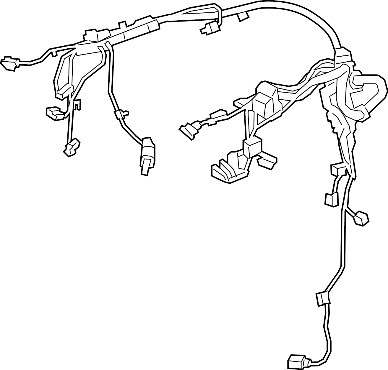

So the dealership found out what the issue was, a rodent has been gnawing at my knock sensor wiring harness. Toyota wants to charge 1900 for parts and labor but I figure I can repair it myself. The harness is $170 online but the intake manifold and more needs to come off. Wish me luck.
For anyone wondering what the part number is for the harness it is #82127-WAA06
That harness has the crank sensor on it. As well as a couple of other hard-to-reach sensor clips. Some of those are a bitch with the engine in the car.
Removing the manifold is easy, reinstalling it is easy, you'll need to rebleed the coolant system, and vacuum bleeding is the best way to deal with that. Good luck.
This fix the issue? I’m having similar codes and recently found a nest.

Yes I found a nest near the sensor under the intake manifold. I ended up just repairing the wires and it has held up since. Wasn't super difficult. Took about 3 hrs total.
