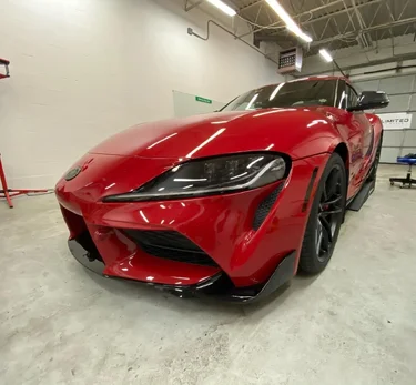

After some delay, finally got my Supra back from the detailer. Ended up with full Xpel PPF topped with Gtechniq CSU.
Edges were wrapped, though corners were more noticeable than expected. Saw some moisture, but was assured that it'll disappear in a few days. Will keep an eye on it, but will also have a follow-up inspection in a month.
