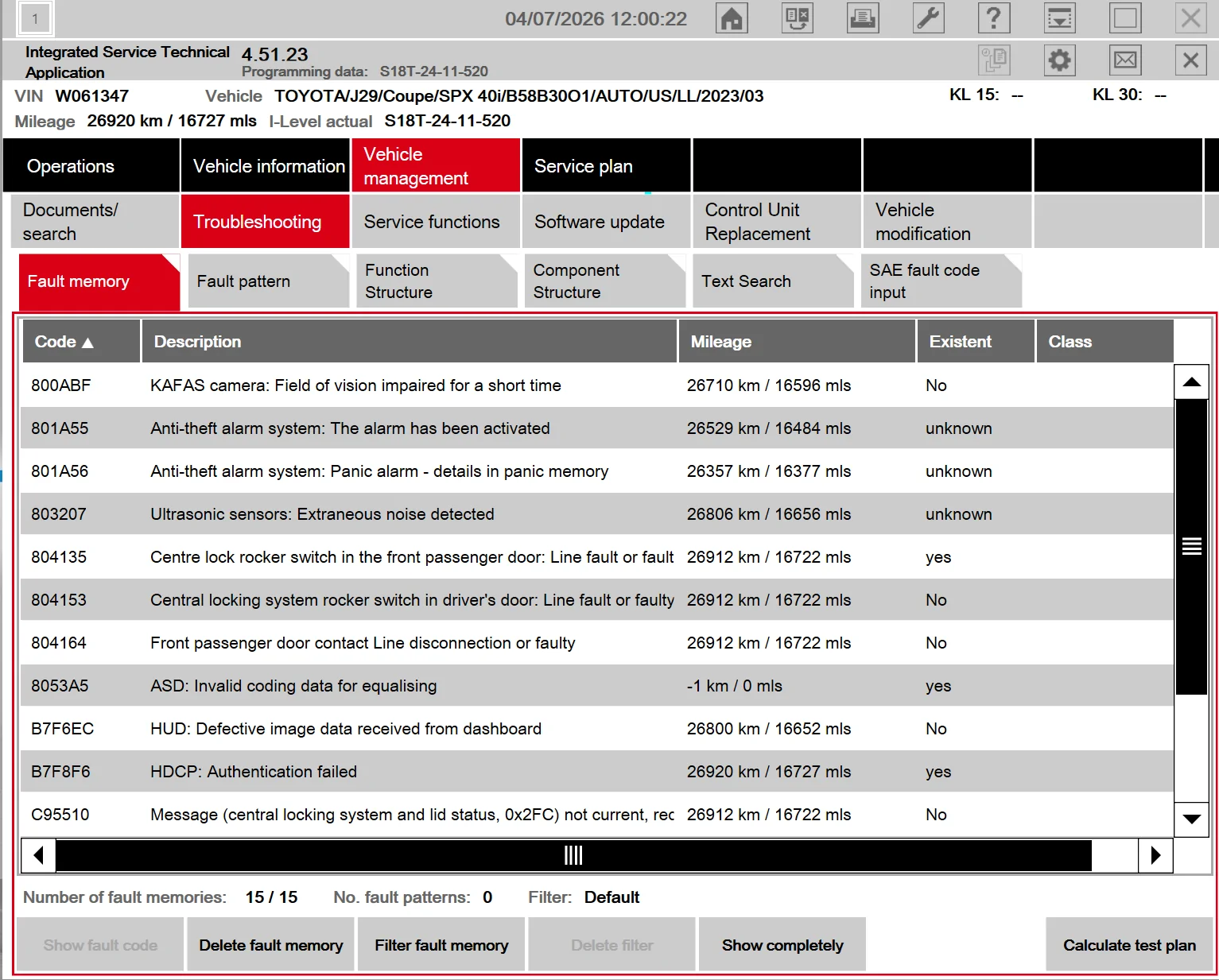

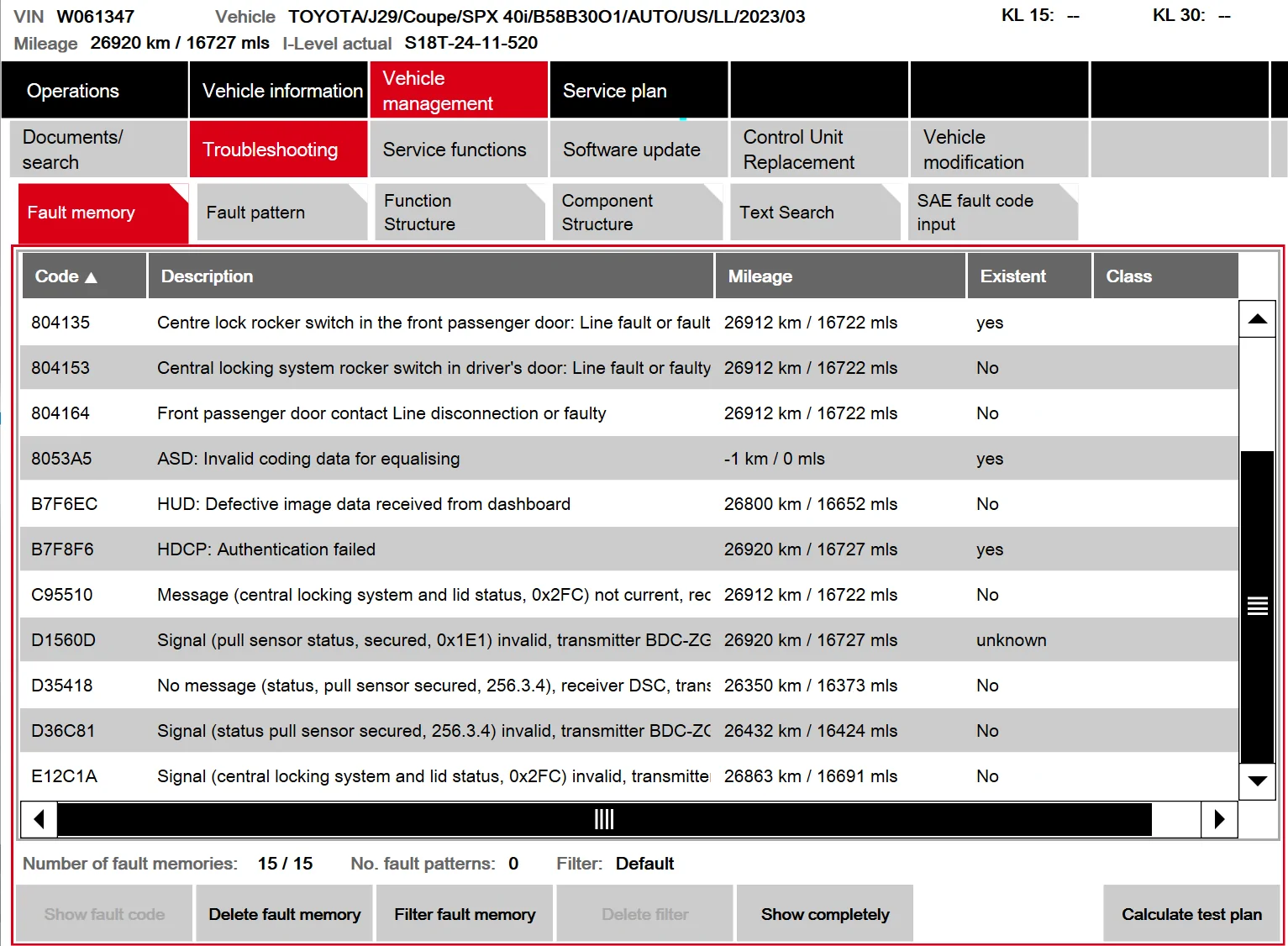

Toyota pulled the following fault codes:
  • 804164: Front passenger door contact, line disconnection or faulty
  • 804135: Front passenger door central locking switch, line fault or faulty
  • E12C1A: Central locking system and lid status signal invalid
  • C95510: Central locking system and lid status message fault
  • 800ABF: KAFAS camera, field of vision impaired for a short time
  • Plus a few alarm-related codes

I’ve attached screenshots of Toyota’s diagnostic report. I just want to fix the issue.
Has anyone experienced something similar or seen these fault codes before? Do the codes point you in a different direction? Does this sound more like a passenger door latch or wiring issue, or could the windshield replacement somehow be related? Also, is there anything else I should be asking Toyota to inspect or test?. The only solution they have provided is to go back to the OEM door releases. But I’m not convinced that’s the issue.
