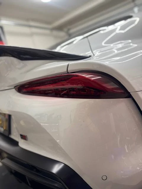

Installed my Valenti Taillamps and they worked, mostly. When i went to test the opening and ending action there was no response. More to the point the car wasn't locking and unlocking. Car only start when remote key is held up to the steering column.

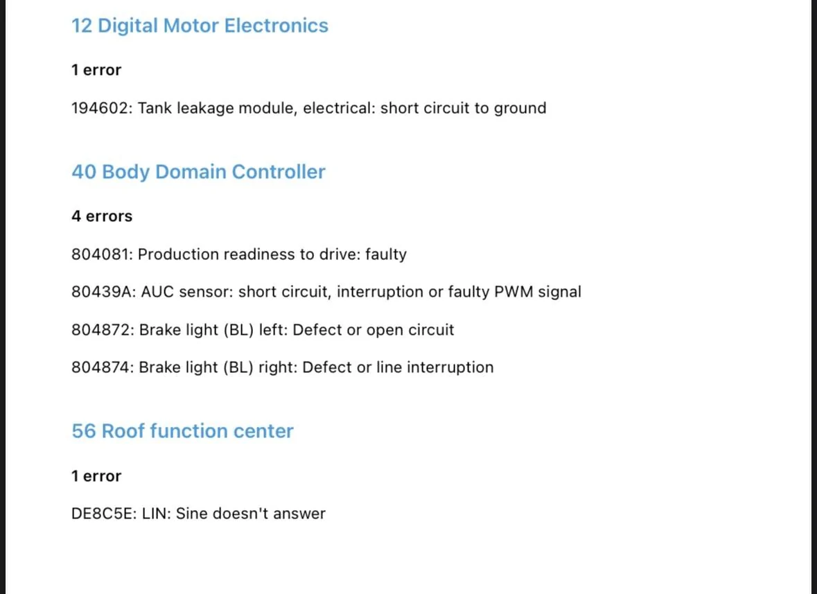

I seem to get all kinds of errors or codes when I do things to my car. Sorry to use your post as a guinea pig but I wanted to see if this multi AI model would work in a single link, instead of a massive copy & past. Hope it helps ya!
https://www.perplexity.ai/search/bda21c9d-6a9f-4c3d-a71b-b38163c3cd12#0
WOW that's an interesting program thanks for sharing that.
I've performed all of the basic check and tests going over every connection ive interrupted both new and old. I'm now limited by lack of specialty tools like techstream or harness pigtail for DMM use. Couldn't find anything helpful in the files of bimmercode and bimmerlink.
I took it to work this morning and just then realized i've lost carplay and bluetooth. Seeing as how fuse F244 it told me to tap is the circuit for door locking and telematics this pretty much umbrellas the problems to one circuit.
