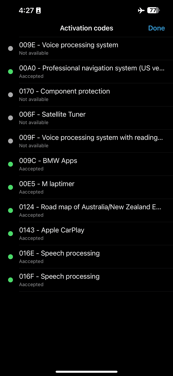

I've been having an issue where I cannot seem to use Bimmercode to code the Headunit anymore post installing full screen carplay.
I installed full screen carplay from https://easybimmercoding.com/produc...arplay-fullscreen?_pos=1&_sid=2d0ffa624&_ss=r
who have stated that bimmercode should work post installation.
I get the following errors and missing activation codes possibly when trying to connect to the head unit. (see images)
I have tried deleting the bimmercode backup files so as to 'reset' bimmercode but that does not help.
Bimmercode and the OBD CX adapter I user are on the latest version.
Is the only option to restore the haedunit to the original state and then try coding ?
Or does anyone know a way of coding the headunit through esys and able to share the parameters ?

There is no way around this except for having the person who did the modifications revert them entirely. Attempting to do any of it yourself without their software will result in the head unit functioning incorrectly.
