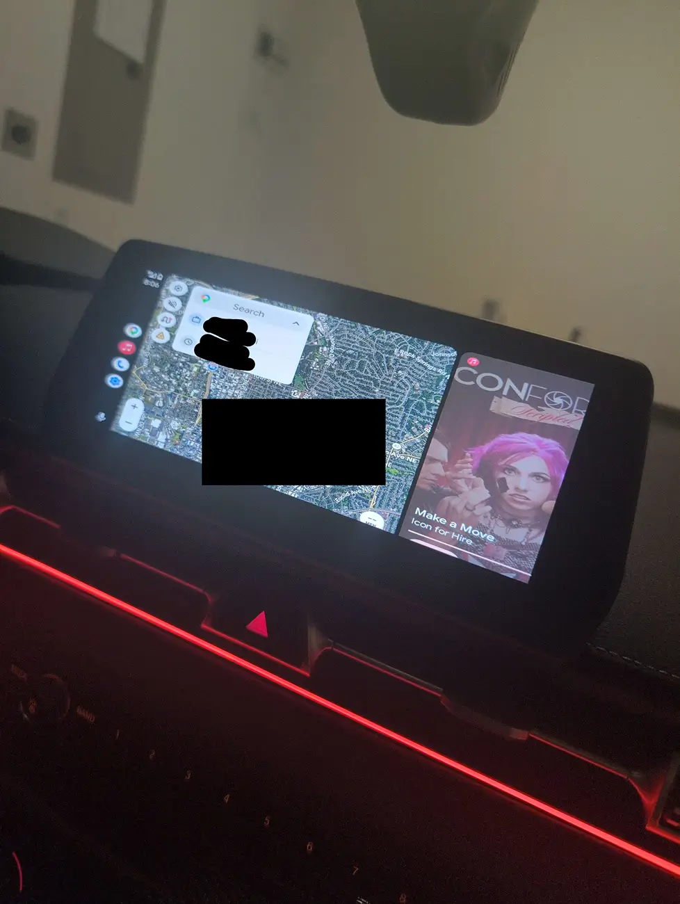

Ok, so I might damn well have the first Supra running Android Auto natively.
It cost me about $500 in tokens, and there's still work to be done.
I will open source the code when its done. I obviously need to work on the resolution, but this is 100% natively running on the NBT Head Unit. There is No MMI unit. I'm connected directly to the CarPlay wireless network.
There's a few quirks I/GPT-5.5 need to work out...
- Resolution
- Audio Streaming
- Controls/Touch Screen
- Launching natively within iDrive
- Coming up with a free way to open SSH on y'alls head units
Once again, I will not charge for this like bimmer_manufaktur is planning to. I cannot guarantee compatibility or anything of the sort, however, I'm happy to have AI look at it and hopefully come up with something for you. Once it's finished, I'd obviously like to recoup a bit of the cost, so I will include my PayPal, but for now... I've got some vibe coding to do.
Ok adrenaline rush is over, have a picture :)

Amazing job man, this is something that will meaningfully change a lot of driver's experience with the Supra. Will throw some money to support you once you post the PayPal link and I dont even use an Android.

This is some impressive work,
Can I Help? I am being serious have knowledge into low-level and I am a Computer Science, Cyber security. And Also I'd like to add a couple of features some people would also like like changing the chime to custom bring your own audio, and changing the pictures of the black supra to custom colored Supras. I have a designer friend that can also help with this. and see many other things if people would like.
Obviously im only doing this for the love of the game. All donations can go to you I don't want any :)
has already been done before
https://www.supramkv.com/threads/guide-custom-supra-icons-throughtout-idrive.24478/
@a90.faz had all the UI assets posted on GitHub
https://github.com/FarazzShaikh/j29-supra-id6-assets
And here's all the audio:
https://github.com/Sq00ky/Supra-Headunit-RE/tree/main/audio
90% sure there's checksums in place for audio. I've tried, and I know others have and haven't had luck.
Code currently exists here: https://github.com/Sq00ky/Supra-iDrive6-Android-Auto/tree/main/Milestone-2
