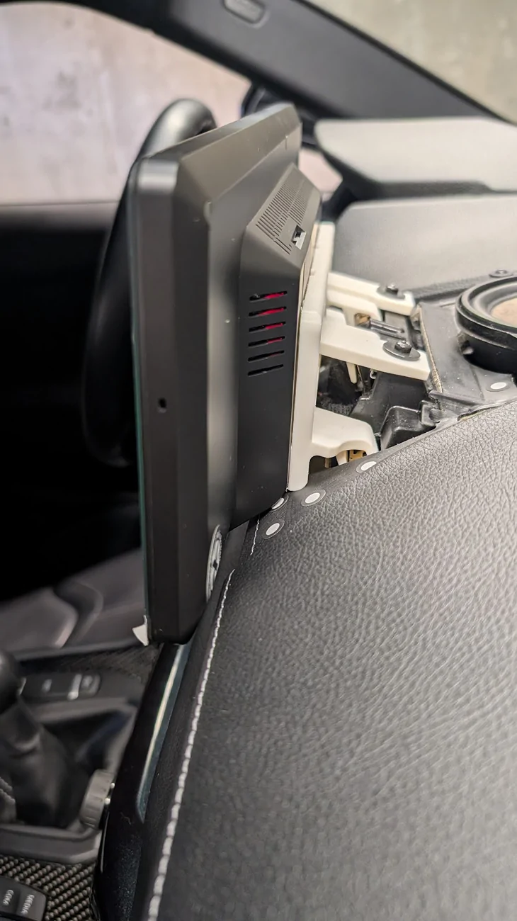

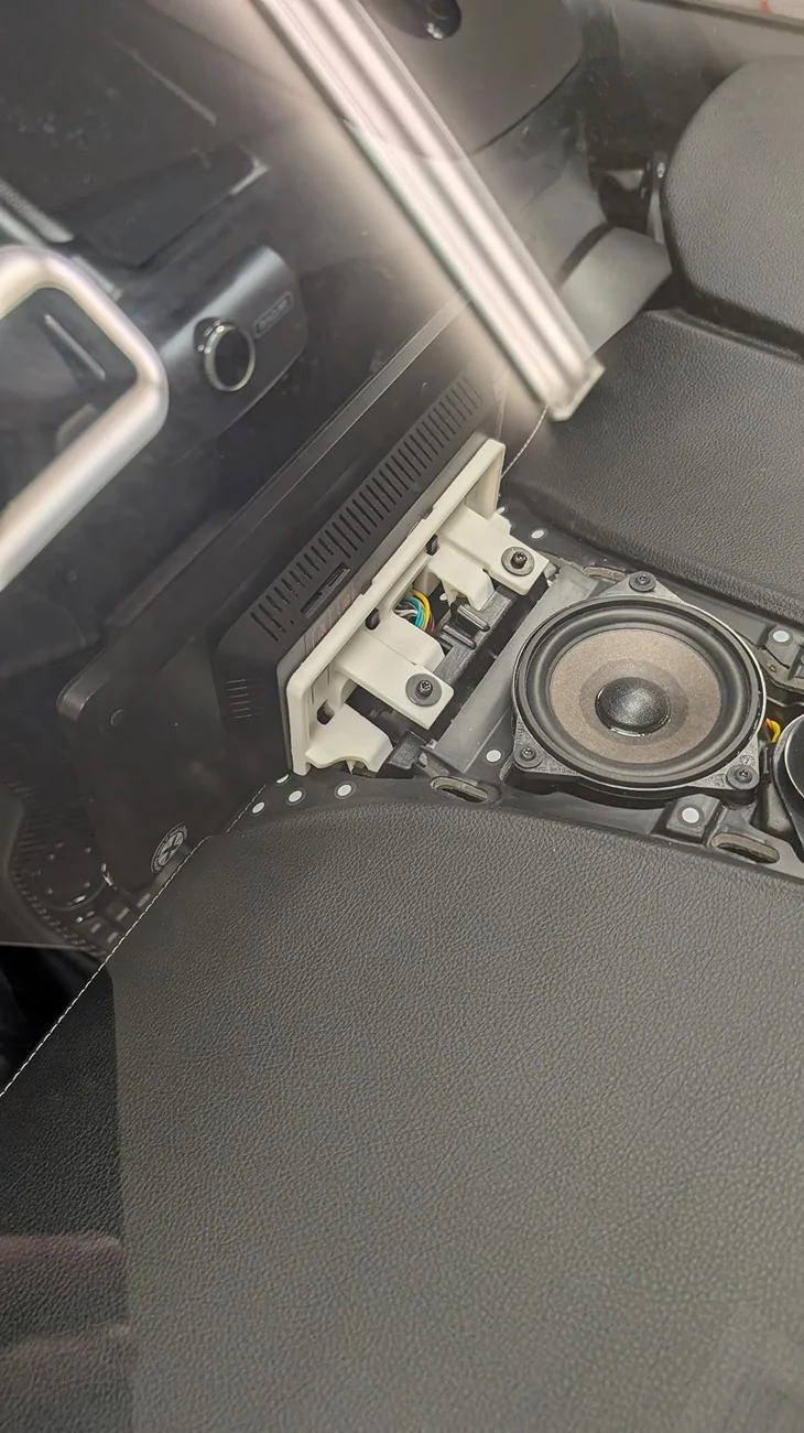

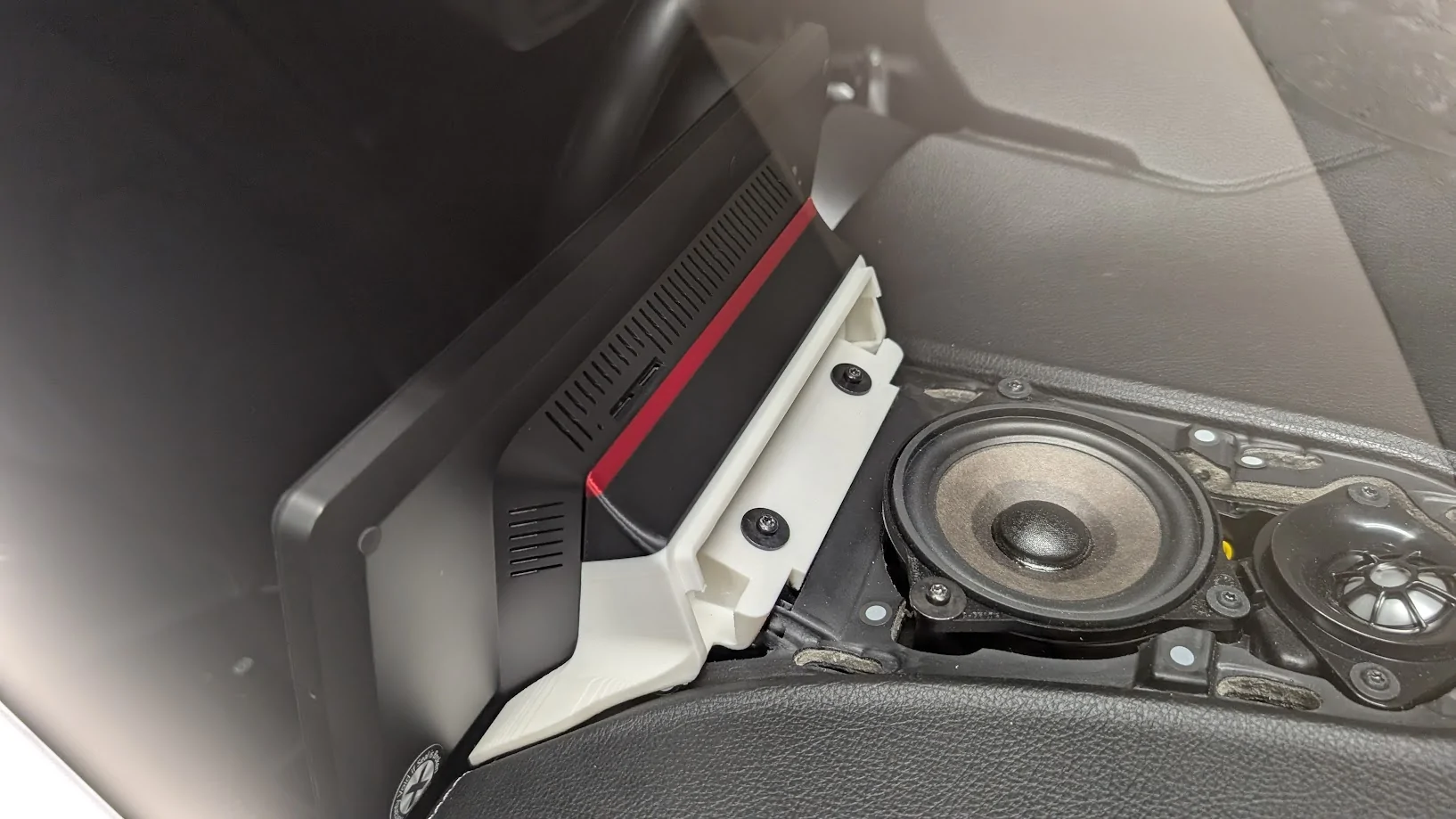

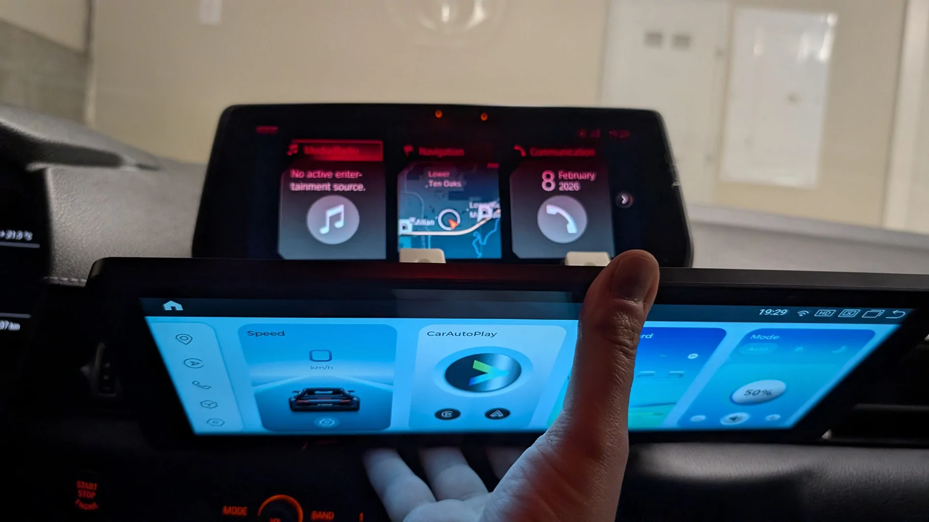

Alright, well it's over-engineered, exposed my lack of CAD knowledge/technique, and it's certainly not a RapidDesign :p - but if you need it, ere:
https://makerworld.com/en/models/2824249-xtrons-headunit-mount-for-a90-supra#profileId-3145802
You're selling yourself short, looks real nice to me. The finish/colour on the adaptor is slightly different to the OEM dash but thats being picky. Have you considered the option of "if you can't replicate it perfectly then make it a feature" thing? So a different surface finish to actually highlight it when you do get a look at it. I've used that technique a few times when making stuff to blend with the OEM and can't achieve it that well. Just make it a distinct feature. Not too distinct it shouts at you just enough to say "hey I'm not trying to match just blend" kind of thing.
One of my many prototypes (unpainted) ended up like this, which I thought looked kinda cool:
Kinda leaned into the whole 'well I can't hide this thing'.
I just got too focused on making it, and not so focused on trying to paint match the trim (which I didn't even try to do...).

Print looks really nice! Would you do it over again? I have a mmi box but would love a bigger screen.
I like using the touch screen, which the MMI boxes don't have, right? So for that, sure.
Making the mount cost me over double what the headunit did :) so maybe not so much that way lol.
