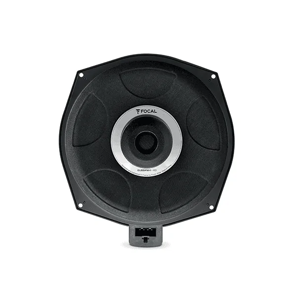

Hi guys, i've been lurking on this forum for a while now.
Decided to hop into the discussion since i stumbled apon something interesting from focals "inside" line.
They are plug&play dedicated to BMW. But since we all know whats inside our Supras i figure these would probably replace our 8' subs too? They look excatly like the factory H/K subs taken out of the enclosure and the same as the Bavsound.
I might just order 2, try them out and return them if needed.
Anyone had contact with these?

Those Focals shown are 4 ohm speakers... BMW has a few different stereo options offered such as "Hi-Fi", HK, etc...And depending on the system the subs as well as amplifier outputs are either 2, 4, or 8 ohms... You'd need 8 ohm to properly match them to our HK amp with requires 8 ohm loads...Yes, you could run 4 ohms, but might run the risk of damaging our HK amp's output drivers at higher volumes...
That said, the issue is not really with the Supra's OE HK woofers (after fixing some enclosure design issues) but moreso with Amp and it's associated DSP tuning...
Here is a writeup I did awhile ago evaluating / comparing the Bavsound Ghost Subs to the Supra's OE HK subs...
Bavsound Ghostsub Review: I really wanted to like them...

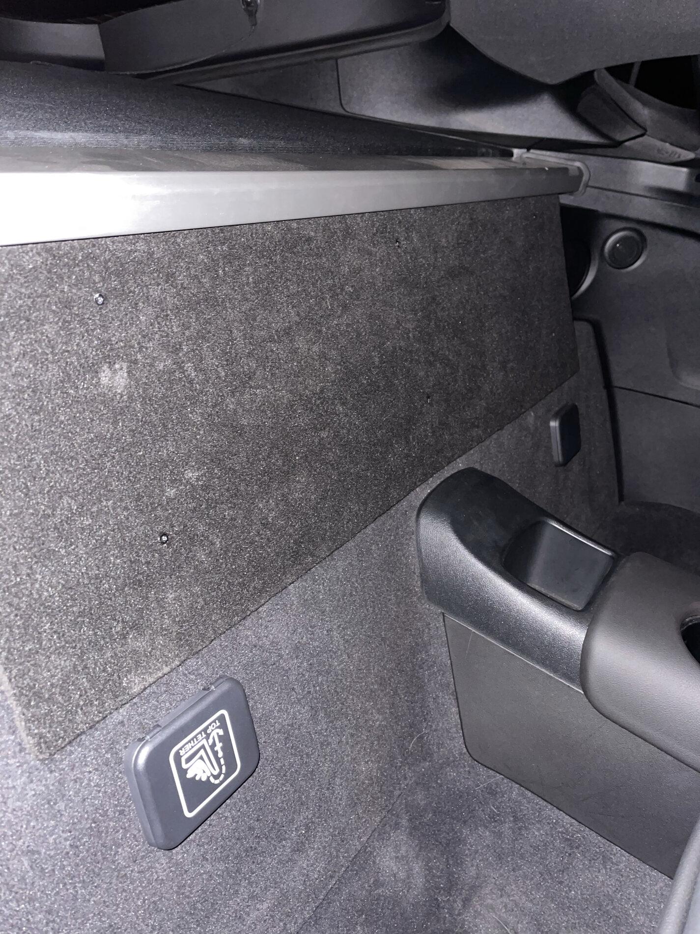

Next up is the remote wire. I originally purchased The LC2i Pro because it has a feature where when it senses audio, it creates a remote output wire to turn on your amp(s). Unfortunately, in this car it didn't work exactly as planned. The LOC would randomly power up without the car being on. I spoke with an audio control rep and they said the car most likely has mics in it, pick up sounds, and powers up something in the CAN network which trips the LOC on. (These are his words, not mine. I do not know if this is true). I didn't like the idea of potentially draining the battery so I ended up finding a switched wire behind the fuse box that is located on the passenger side of the trunk area.
I used this video to help me remove the fuse box and find the wire I needed which ended up being a green/blue wire for the input wire into my relay:

Here is the solution to your problem Wettnoodle. It's from a topic created by static63.
If you dont want to cut any wires, like me, i used a fuse splitter. Im no expert too so please take caution :)
Thanks @Piotr I literally just happened across one of these today which seems to be the perfect solution to my problem.
