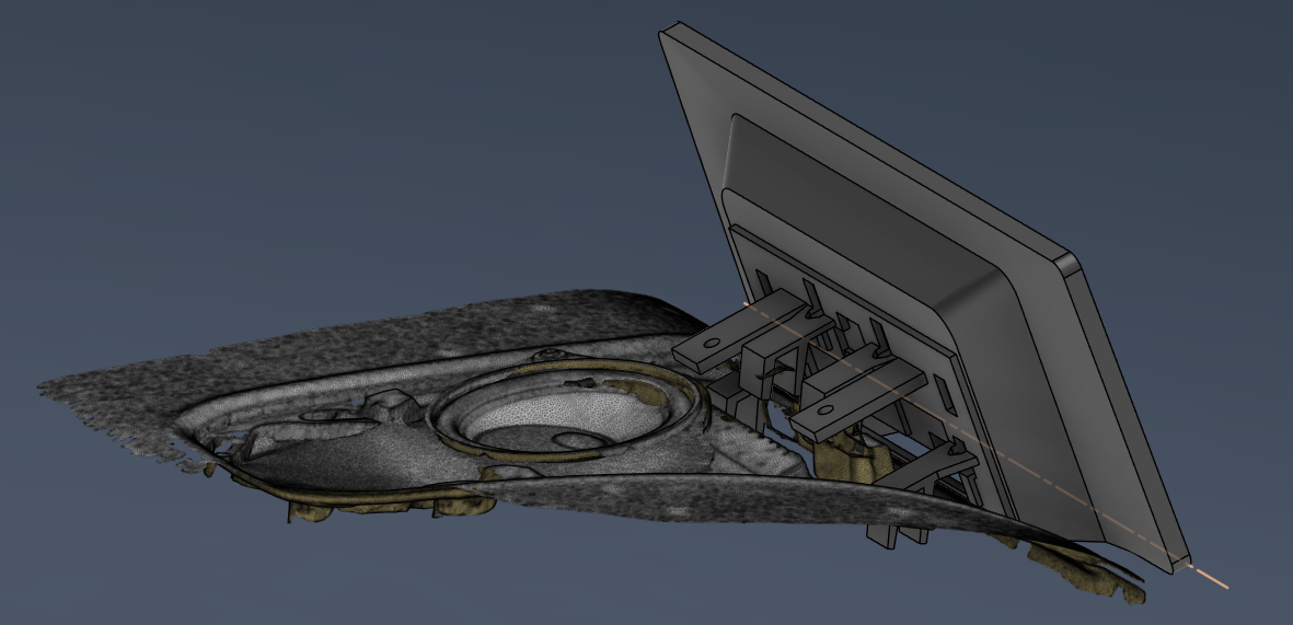

I have the 14" and a 12.3". I will probably end up using the 12.3" unit for packaging reasons, and because modifying the OEM mounting CAD will be easier (display rear has tabs like yours). The 12.3 also has a metal enclosure for additional rigidity on the dash.

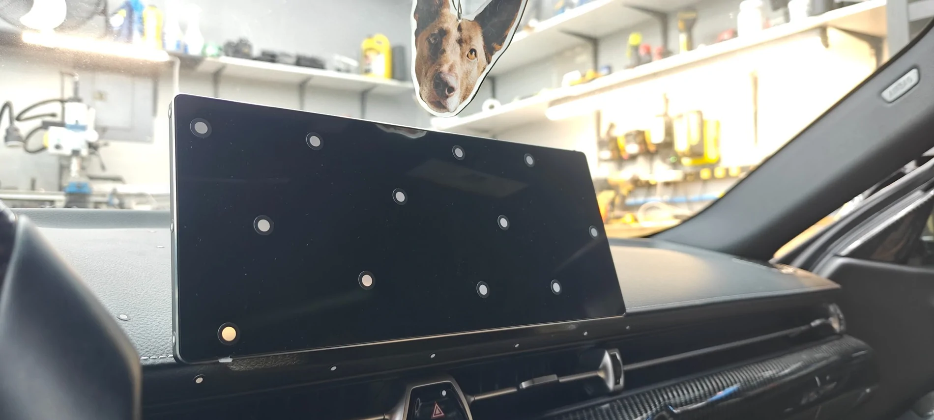

Chinese LVDS cable worked!
Next up, have ordered a HSD->USB port as our HU's have an unused USB port on the back and I hate seeing that 3.5mm audio box thing...
does this screen have audio delay similar to the nbt one? and can you run MHD flasher or DashCmd or raceChrono pro application on the screen
you only needed the screen and nbt cable and a mount to run this setup correct?
Denton
Jun 11, 2019
379
491
BC, Canada
23 MT

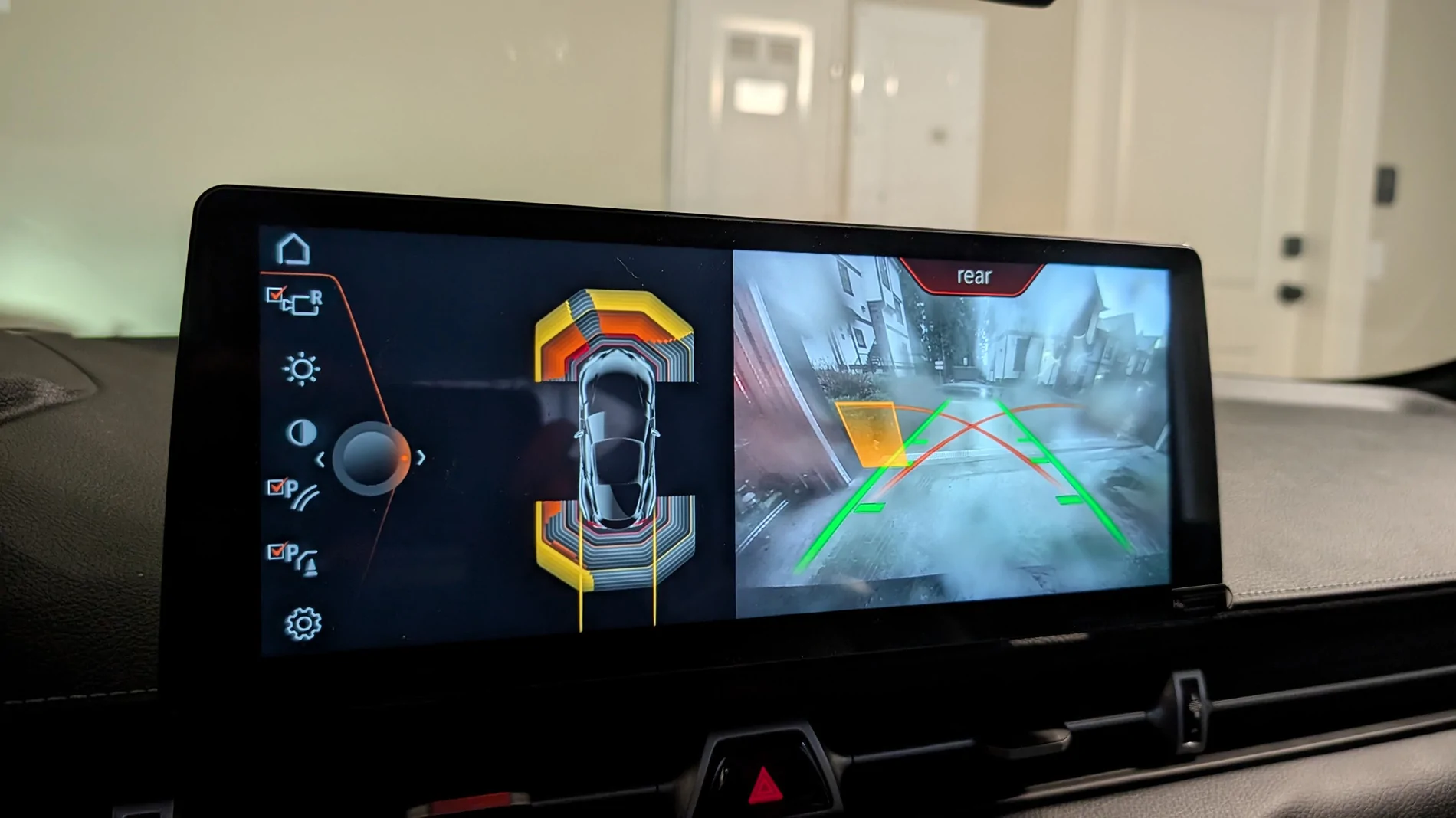

- I don't feel any audio delay, here's a video I recorded using an audio delay test from YT.
- MHD runs fine, RaceChrono is available on the PlayStore for this device so I assume it will run fine also. DashCommand (from the PlayStore) won't install as it's 'too old' and wasn't built for Android 14 (which is running on this device) - maybe you can sideload an APK or something.
- Yes, just the XTrons device, correct display cable, and a way to mount it to the dash of our cars is all that is needed. For audio, you will need to code aux into the car and use the USB port.

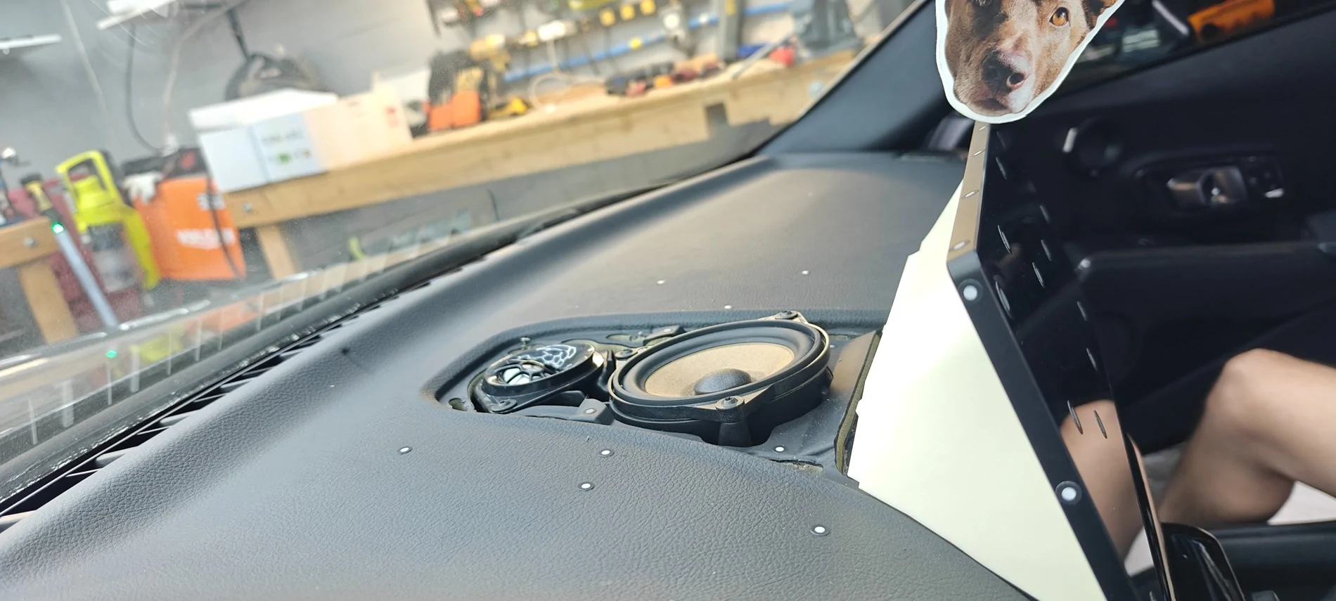

Yeah a few reasons:
- Pretty sure the MMI box doesn't work with the OEM display touch screen, so you have to use the physical iDrive controls to use it (touch screen might still work if you're interacting with the OEM headunit via passthru though, I'm not sure). With this, it's sort of the reverse, iDrive physical controls must be used to navigate the OEM headunit when passing it thru, but the Xtrons headunit supports touchscreen and the physical iDrive controls.
- Felt like a neat project & excuse to buy some things.
- I can tell everyone that I've got more than 10 inches now...

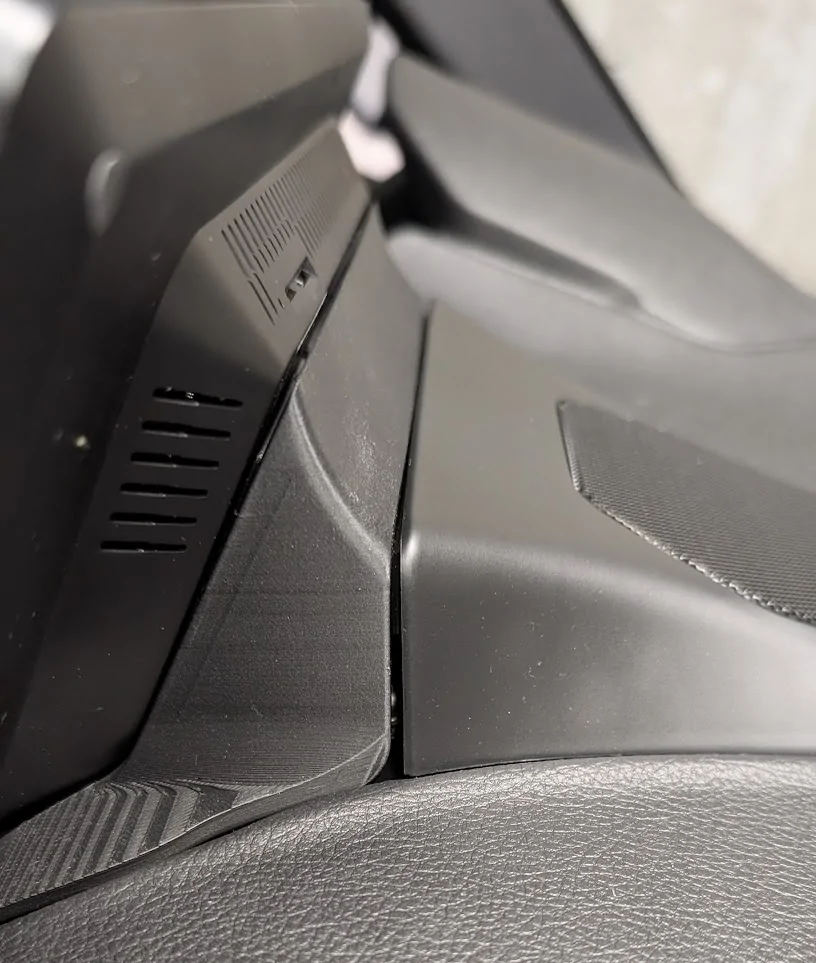

You can have the stl to the "v2" mount if you want, but I don't have a cover for it that doesn't look like ass right now, we got Supra hood level panel gaps going on (note that I have not attempted any finishing on the print because why bother until I know it fits):

That looks like pretty good fitment already, especially considering it'll be behind the screen and you won't really see it. Would love to have the stl for the v2 mount.

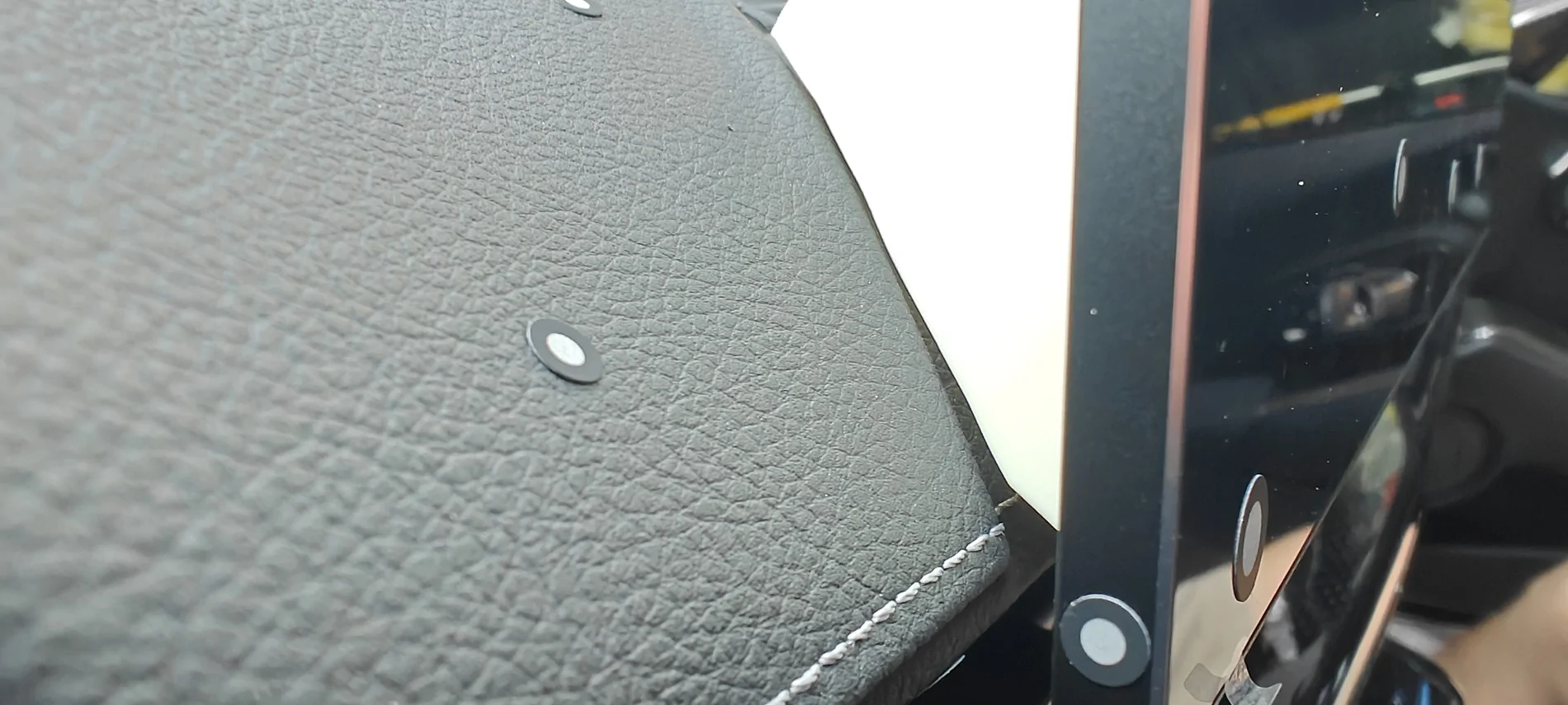

First test fit in cheapo filament. We only need to fix the contour of one edge. Everything else fit first try. We're now going to switch to CF-impreg nylon for the final print. Waiting on a new LVDS cable, too.

Some of the screens run Linux, some run Android - with enough programming magic, I don't see why not.
