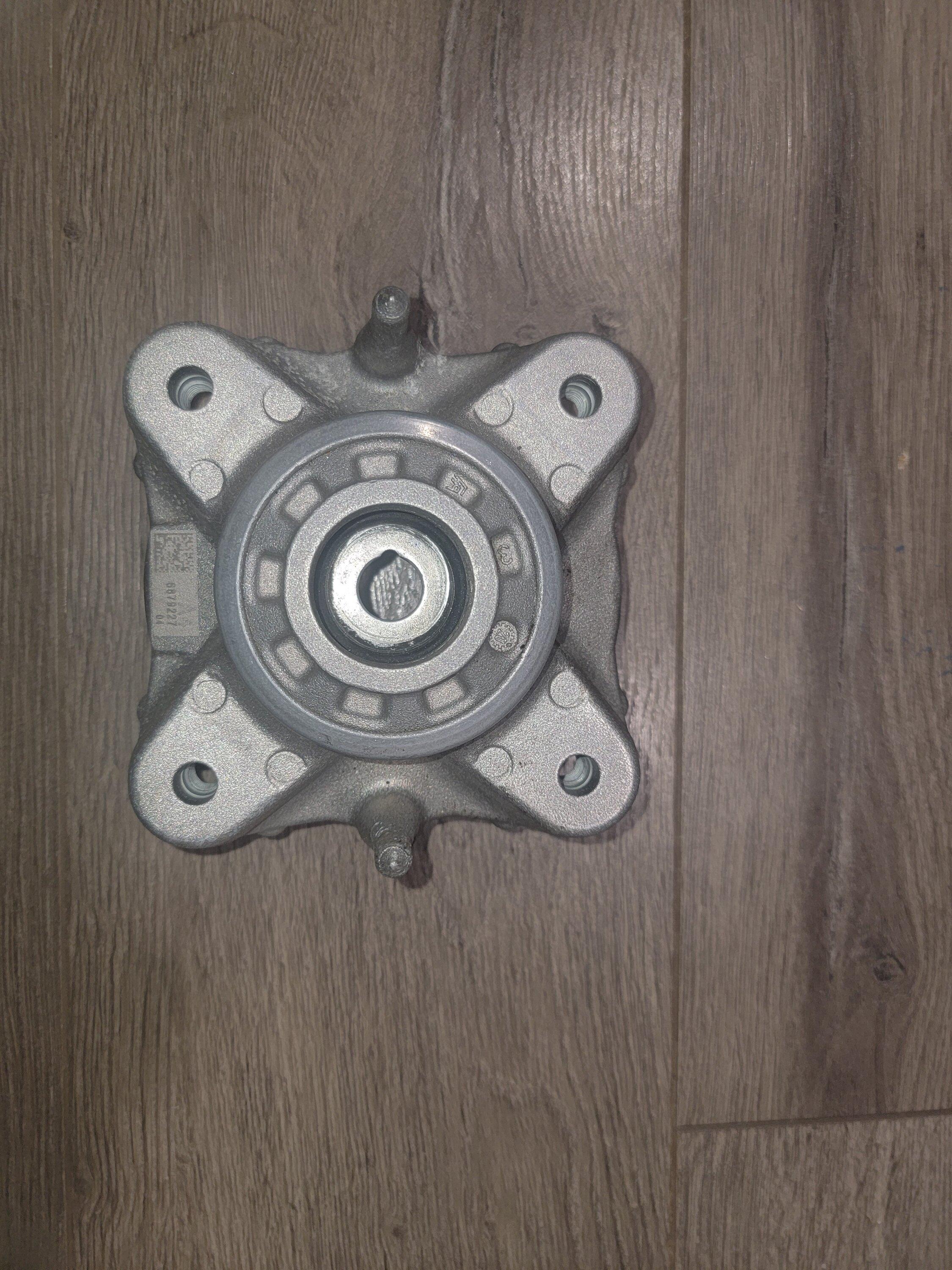

I am hoping someone with more knowledge than me can shed some light on to an issue I’m having.
I had installed the HKS adjustable lowering springs myself on my car over the weekend, however there is gnarly noise coming from the driver front area. Everything has been double and triple checked to be tight and secure.
I had taken it to a proper shop to diagnose the issue and they and told me 2 of the 4 holes seem to be stripped. They have also confirmed that everything is tight and bolted down to spec. However, 2 bolts on the fender side seem to spin and won’t get to spec.
I put a feeler out on the Facebook pages locally to see if anyone has a replacement top mount. Dealership says 2-3 weeks out.
Upon looking at the part online/photo it seems to me that the top mount may just need to be rotated?
Does anyone have any experience with the way the strut is orientated if the top mount just needs to be turned/rotated 180 degrees? And if this is even possible?
I understand that the top mount is aluminum and it is possible I somehow stripped them but I highly doubt it is that. I am very carefully, sometimes hyper careful when working on the car.
I am out and won’t have the chance or opportunity to test this until tomorrow and wanted to hear from the community and experts.

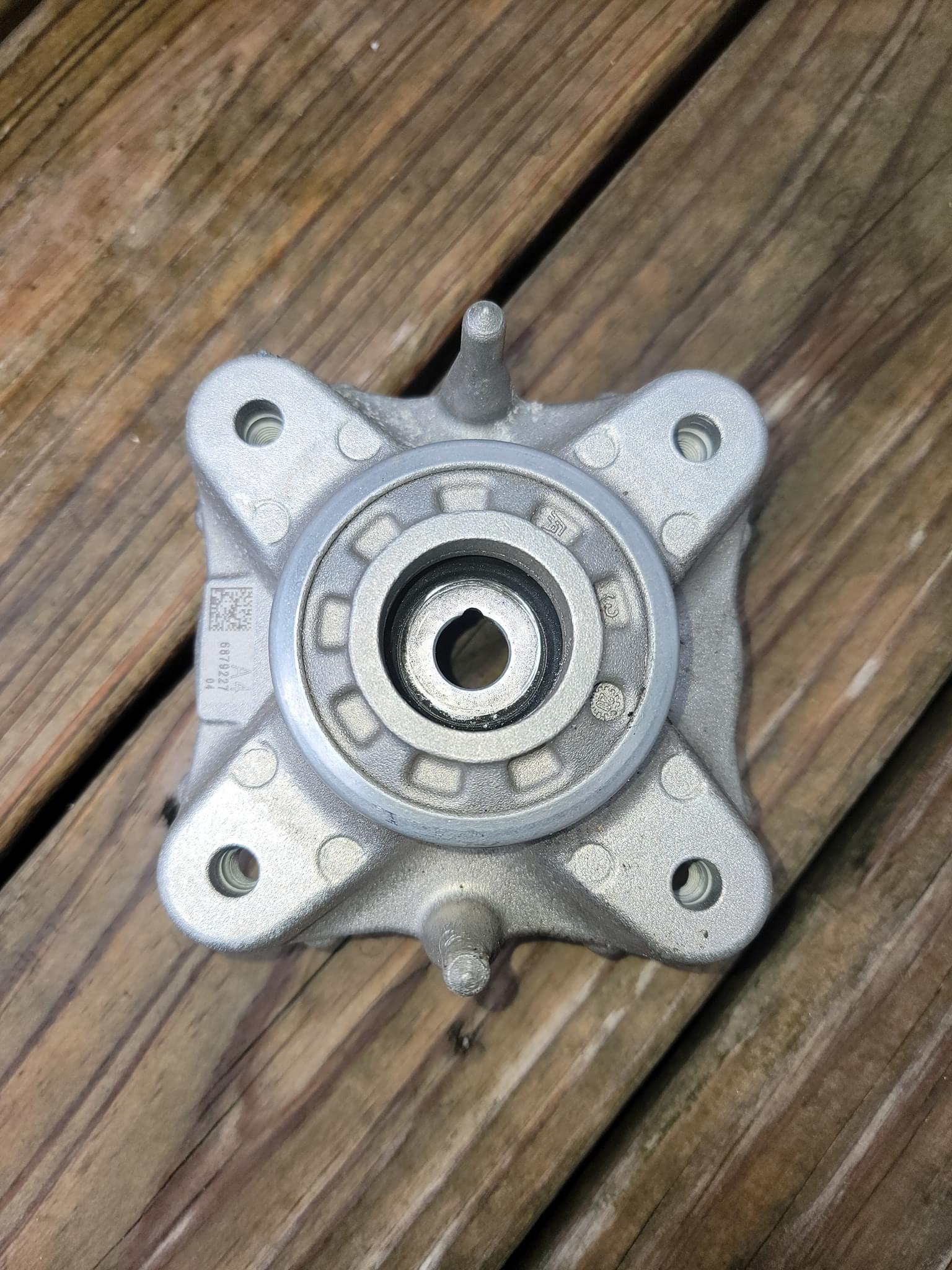

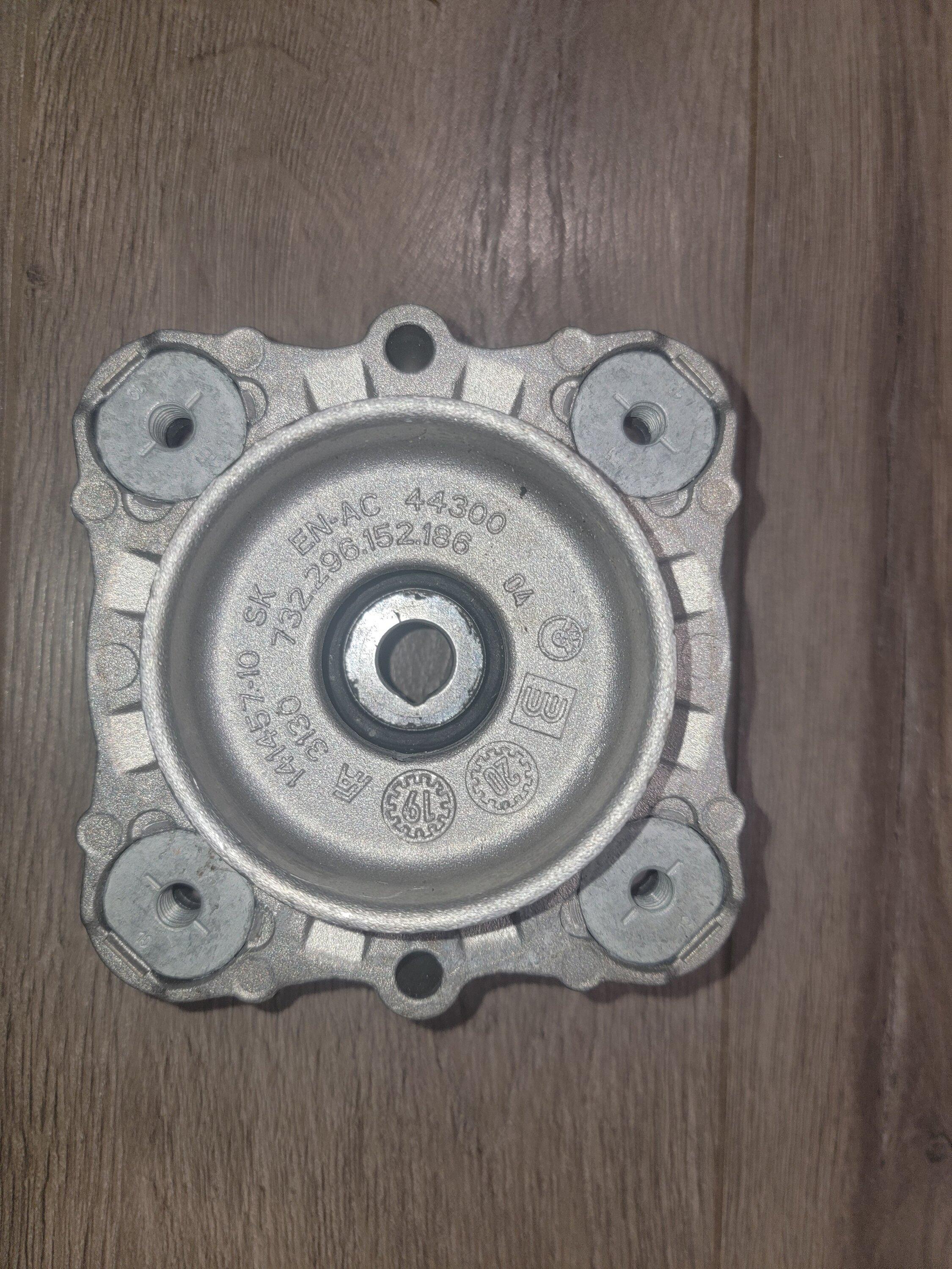

Lol, that's my photo :) All four go all the way through.
No way, haha! Thanks for the photo for reference.
I guess now then the question at hand, will roating it 180 degrees change anything. I will update the original post. Thanks @JoeDaMechanic for clarifying.

If yours is actually damaged on the threads you can always tap it and put a helicoil on it. That's assuming it's not the actual nut that's spinning in there. I can't really tell if it's just notched on the bottom or on the entire hole.
Right, I agree.
Is the thickness the same on all 4 corners? Is there any way to measure and see if it is 100% square.
That is the last and only thing I can think of.
Jacking up the car up, taking off the wheel, dropping those 4 bolts and spinning it 180 degrees wont take long, to see if that is the cultrate.
If that does not work I may just need to ask around to purchase a new one.

Quick measurement on the table top says they're all the same height.
If it is the nut that is spinning in there, you'll definitely know when you try to take it off because it will probably spin when you try to remove it as well.
