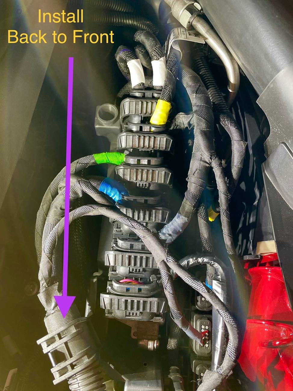

I pulled my DME last night to check the Manf date and now I’m the Supra doesn’t want to crank. Says drive train malfunction and Chassis Stabilaztion issue. I unplugged the colored coded cables plugged them back in and nothing. Any ideas?

did you disconnect the cable from the negative battery terminal before disconnecting the connections to the DME?
Edit: push the connectors in even when they click they aren’t always clipped down and make sure they're level with the other connectors

Thank the maker ? one of the clips wants locked in. Wow those little boogers are just a tad tricky

It’s easier if you install them starting from the rear connector first.
