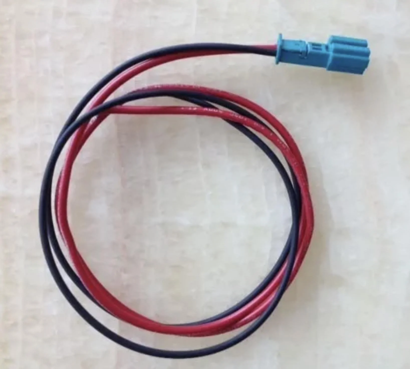

I have some extra BMW speaker pigtails that I bought when I did my M240i, so I hope I can make changing the rear-sides so easy that even a biologist can do it.
