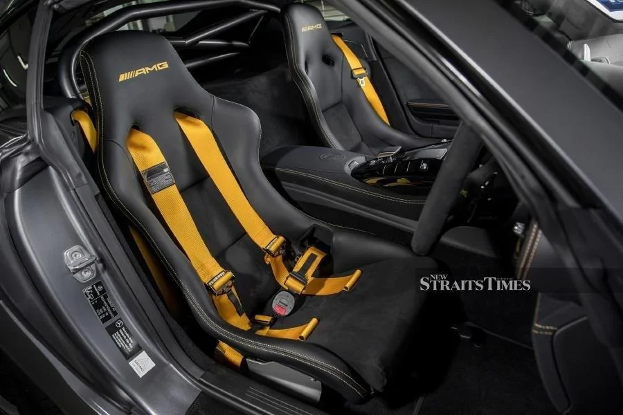

Porsche GT cars with the clubsport package come with these installed from the factory, rated for street use. they make some dumb design decisions, but this was one that’s been tuv + legal tested
infact amg gtr pro is primarily setup for these in the eu
