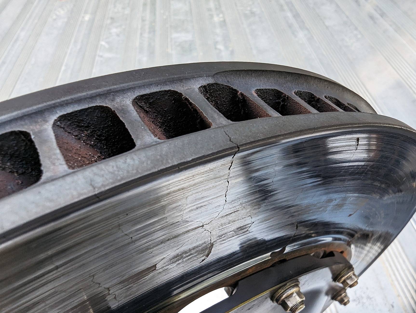

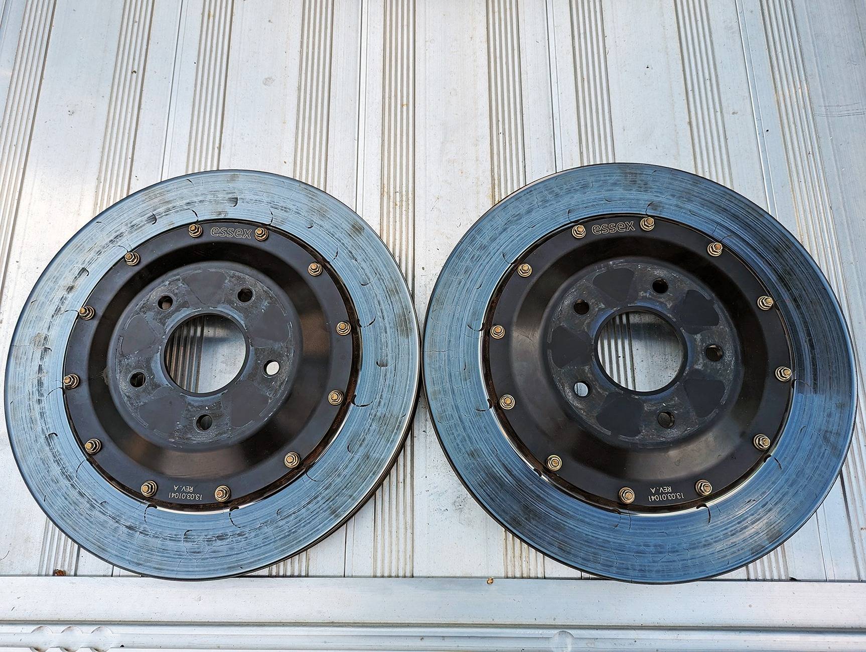

I've never had an issue mixing pad compounds; if I bought new rotors every time I tried a different pad I'd be broke(r).. ? FAFO, I guess..
And I typically don't replace rotors until I delete the slots. :headbang:
My handiwork at CMP:
I wouldn’t want to get rid of those nice rotors either! I they weren’t cracked ? My rotors are cheap. I will say the p mu 999s came recommend highly to me. After giving them a go, my fav pad so far (yet to try CSG). Curious if anyone else has tried them on the Supra?
Yeah, you weren't kidding about "deleting the slots." That's getting your money's worth out of the rotor rings. At least the hats are re-usable. :cool: Are you running some kind of ducting to the caliper/rotor on the C7Z?
All the front rotors on my LeMons Mustang end up cracking in a similar manner...and we have a homemade ducting solution still sitting in a box, planning to do that in the offseason.
