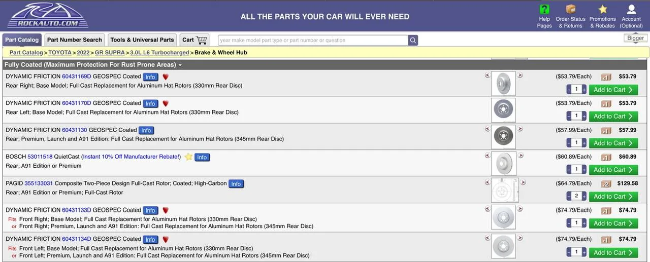

How about just getting them from FCP Euro once and exchanging forever? That's my plan. Got a pair ready to go for when I wear through the stock ones.
You can't order just once. With their new policy, you have to have at minimum 2 purchases for the cycle to be started. Factor in the shipping costs back to FCP euro?? Rockauto Rotors work out better.

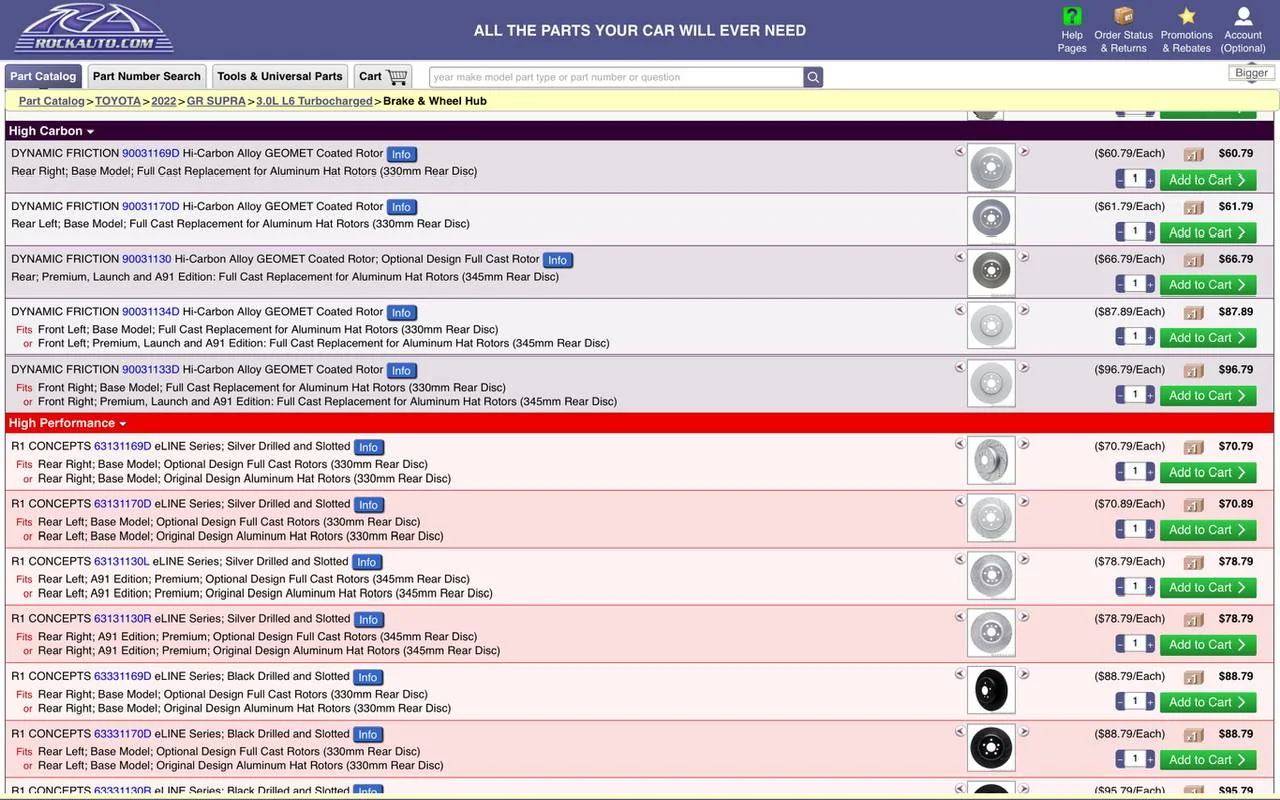

yeah that's what I got as my new rotors as well.
to be fair, the fronts are more like $75 than $55 :D
I bought them for $54.79/each last time, they have since gone up to $63.79/each
60031133D and 60031134D

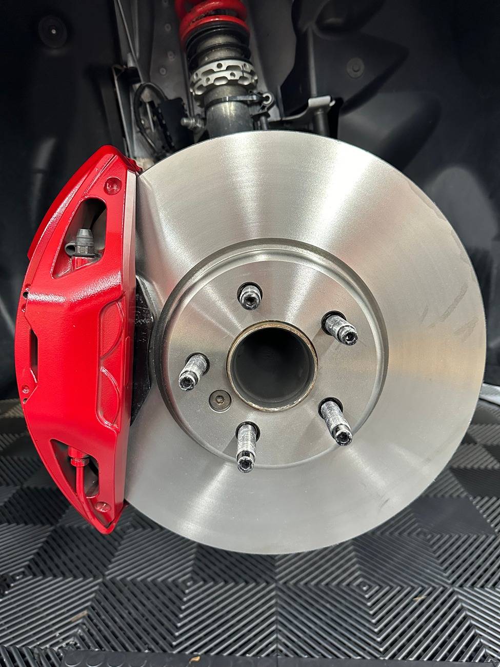

does the geomet coating cause any issues with bedding? my guess is that the coating will get swept away from the rotor face upon the first hard stomp, but i'm not sure if it leaves a residue that will gunk up the pad
Yeah, I've put myself on the FCP Euro track. Now I have store credit after a round of buy/return, it makes sense to buy from them again...I'm also doing SRF through them. The shipping back prices do SUCK, though. I agree, dollar for dollar, Rock Auto probably comes out cheaper. The only thing that makes me feel a teensy bit better is that I'm at least getting Zimmerman rotors, which have treated me well on several previous cars.
I know the coating Zimmerman uses is really nothing but rust protection for shipping/storage. It's gone immediately, no gunking up the pads in my experience.
Dammit! I was hoping you were going to tell us the $53.79 dollar ones were good enough.
Some people don’t like rusty looking rotors, like my wife. No issues at all with bedding. But again, I like to stick with the same pad compound with each rotor.
