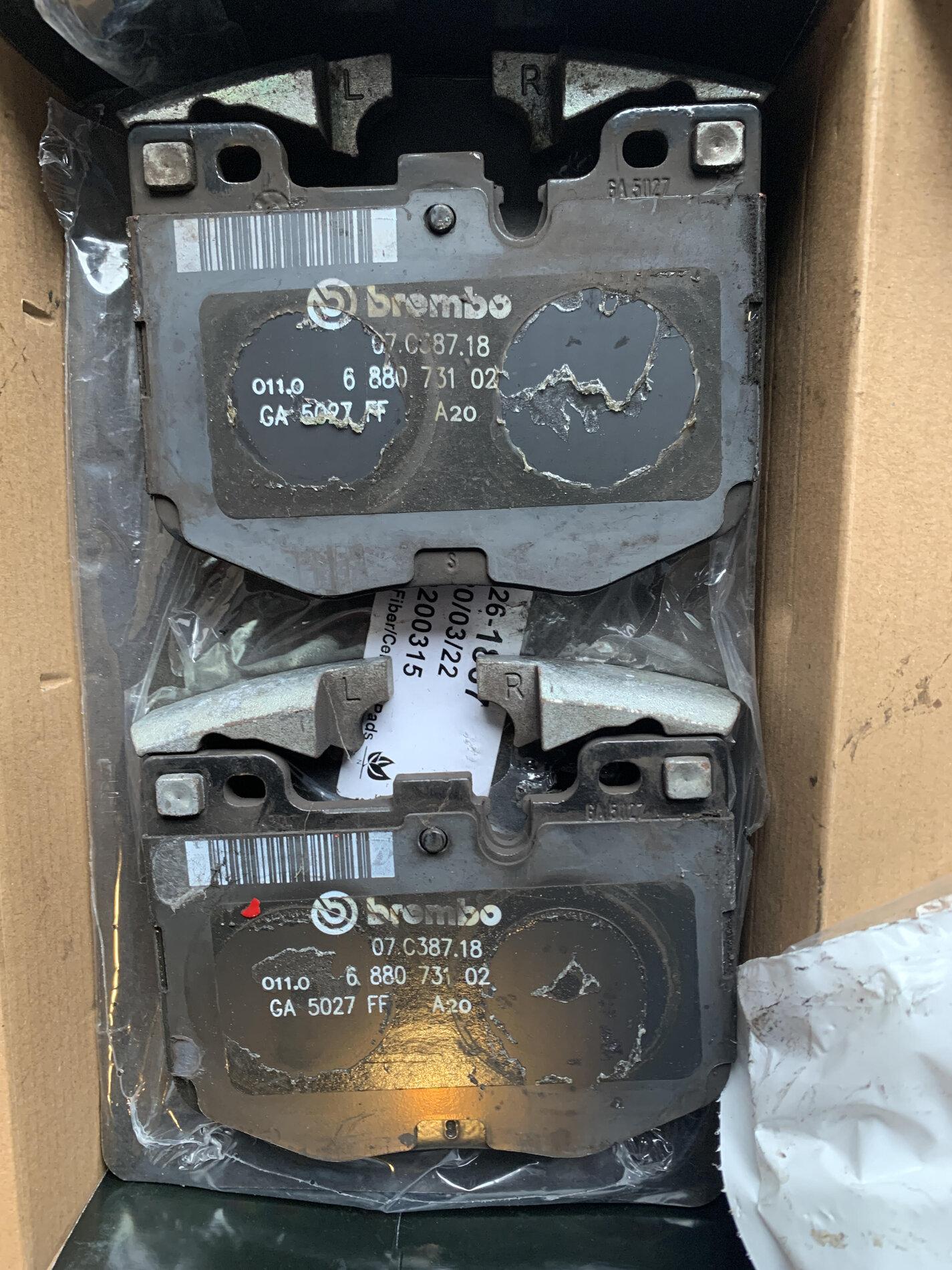

I installed the Z26 Extreme pads last night/this morning.
I found the fronts were a real PITA to get out. On my X3MC, once I removed the pins the pads just slid out.
On the Supra it seems the backing of the OEM pads was "fused" to the pistons of the caliper. Almost like they were glued in. Car has only ~2000 miles so was surprised about that.
Is this some kind of adhesive backing on the OEM pads? It required some creative prying (and a few F-bombs) to get them out without scratching the caliper paint.
From the pic, you can see what looks like an adhesive which is missing where the pistons are (assuming it is now stuck to the pistons).
Have to bring the wheels to get the Michelin PSAS all-seasons put on and will bed them this weekend.
Edit - the rear pads were a snap in comparison. Literally 1/2 the time which is opposite of my previous experience.
