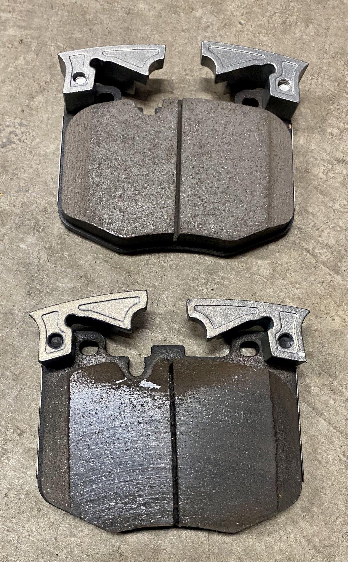

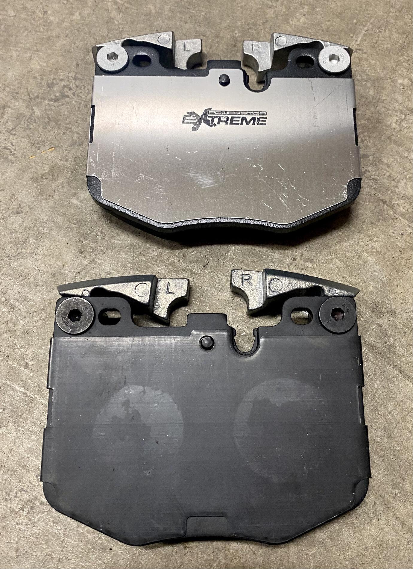

I installed the front ones tonight and will report back once I put some miles on them. Awaiting the matching rears to arrive.
I’ve added some pics of the new pads installed & the prior installed Z16 along side of the new Z26 extreme pads.

~ Well after seeing the differences in material compounds & dust reduction ... I elected to switch from the Z16 (low dust) to the Z26 (near zero dust) pads.

~ Zero complaints...
Performing perfectly with very very light dust (mostly road dust against the black wheels).
Producing less dust than the Z16 pads. No noise or reduced braking. ❤

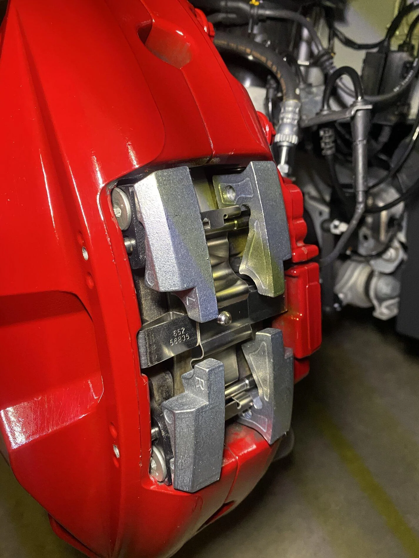

Did anyone else notice how loose the rear brake caliper guide pin bolts were. According to bimmerpost threads the bolts are torqued 30 nm or 22 ft/lbs. Judging by the amount of force to remove them that seems about right.
