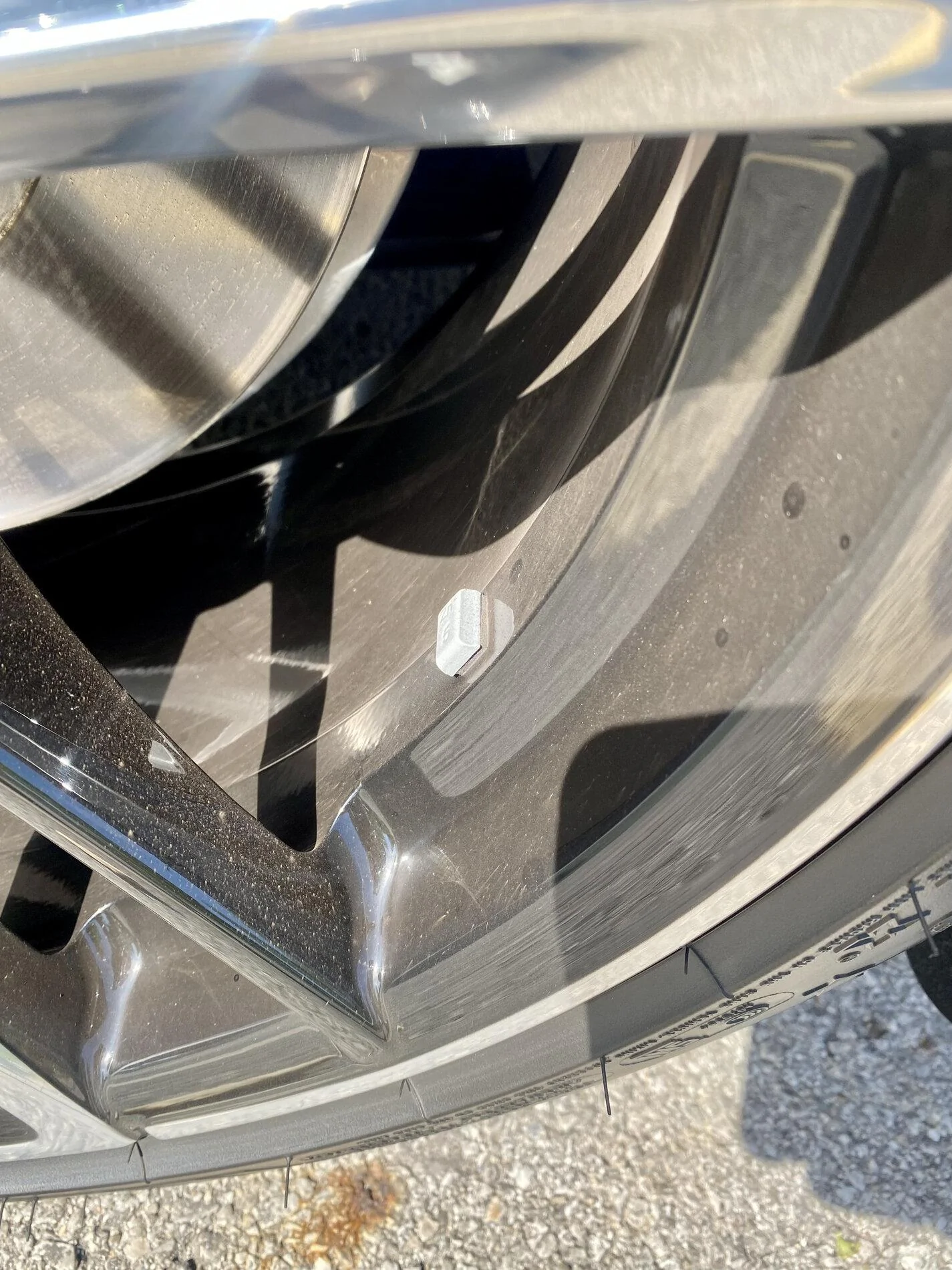

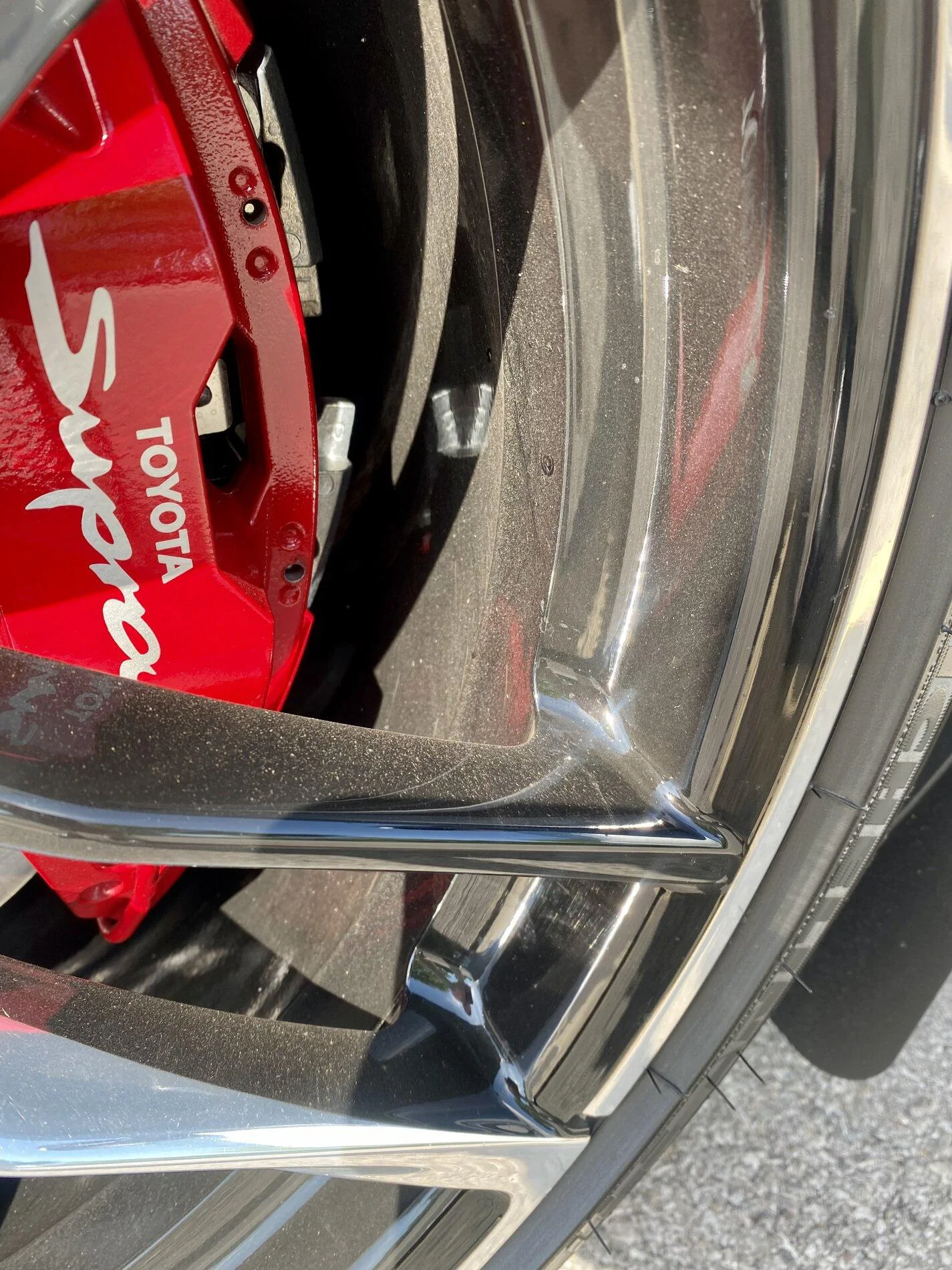

~ Okay sometime and mileage has accumulated on the Z26 powerstop brake pads and I’ve come to the conclusion the Z16 create less brake dust than the Z26 pads (contrary to what powerstop advertises). I will be switching back to the Z16 pads and plan to incorporate the silver backing plate onto the Z16 pads.
See photos below of the Z26 pads below. The brake dust is less than stock pads but not what I had expected or hoped for. Photos represent about 200 miles of driving in dry conditions.

Hey @Andrew4Supra, did you ever end up switching back to the Z16 pads?
We've had the Z26 on for a little while and I've found that they dust more than "zero".
Surely better than the OEM pads, but I have a low dust pad (different manufacturer) on my X3MC and it is about as close to zero as you can get. The Z26s....not so much.
I'm going to try bedding the pads on the Supra to see if that helps but curious where you ended up on this.

~ I did swap back to the Z16 compound and do find them to be less dusty than the Z26.
They seem near dust free with clean wheels until about 300 miles or so then the dust or road dirt build up starts appears.
The black wheels make things worse than they may appear on a painted silver wheel.
Nothing is truly dust free… just much less dusty than stock pads (they are filthy and show dust with the first drive).

Thanks for the update. Any degradation in performance?
Oh and can you advise if you ended up switching the metal backplates over? If so, how did you go about that?
I’m hoping bedding them in makes them dust less. Really don’t want to have to swap again.

~ I haven’t noticed any difference in the degradation of performance whatsoever. The backing plates will not transfer over for they are glued on and won’t pull loose to swap over. Bedding the pads won’t make a difference imo. Hope this helps.
