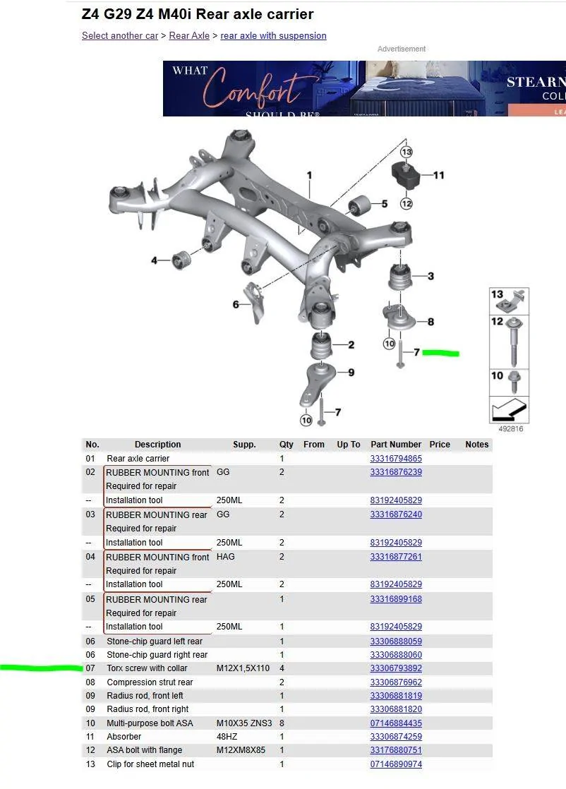

Search for the cusco rear sway bar installation guide. It lists the pn for the tty bolts.
