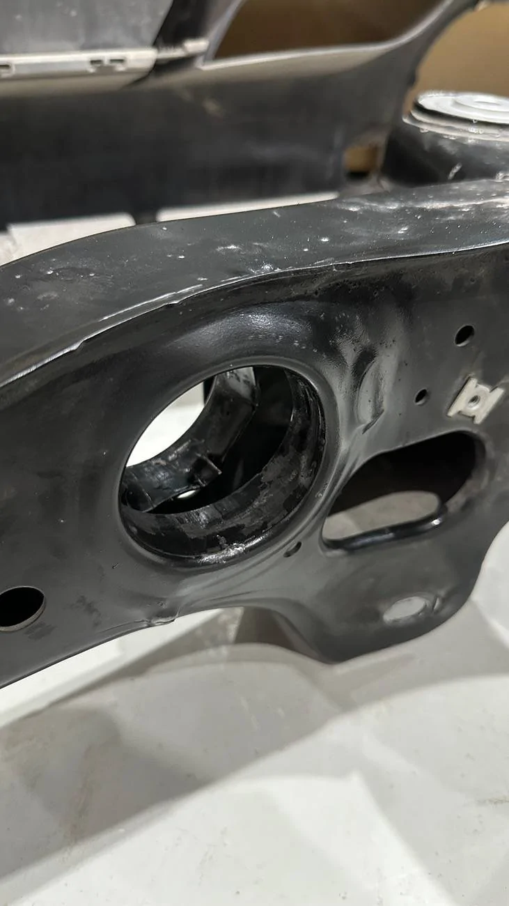

While I was doing the job last week, I took my subframe to a shop, and they managed to damage my subframe while removing the OEM Diff Bushing. They had the right tools but they didnāt use them.Hey man,

Sorry to hear they damaged the subframe.While I was doing the job last week, I took my subframe to a shop, and they managed to damage my subframe while removing the OEM Diff Bushing. They had the right tools but they didnāt use them.

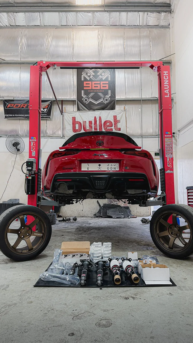

just got the new subframe, will update once the car is done. Might take time, as I wonāt be around to finish the job.
Will give street feedback once itās done, and track feedback once track season is back, which is late October/November in here.
