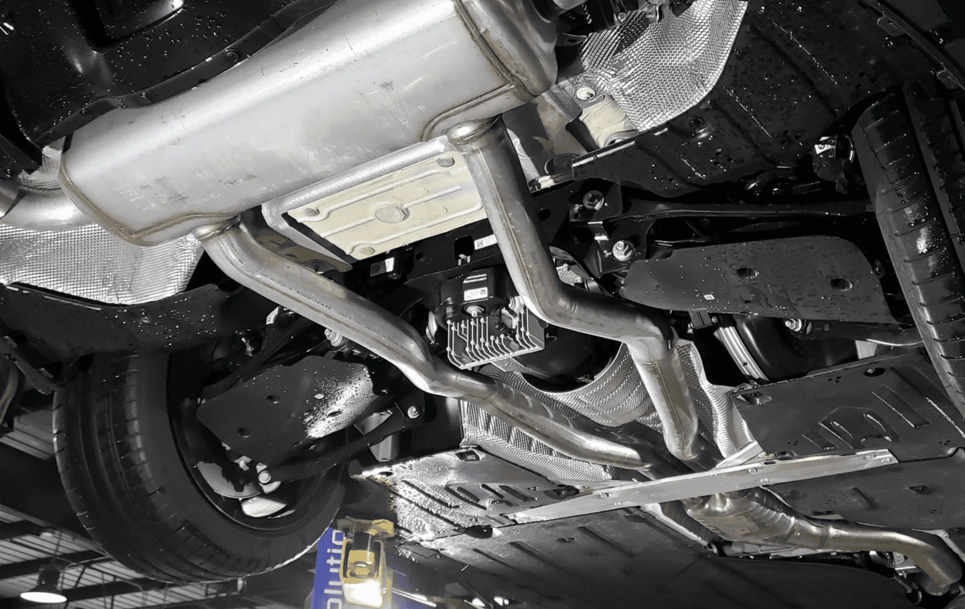

Here's the z4 i6 its hard to find these photos. I thought our diff cover was the same as the z4 but our might have more fins

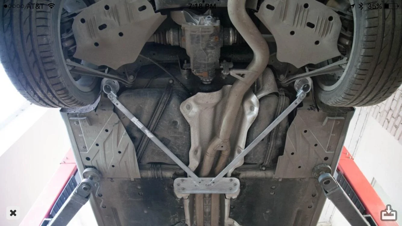

Replacement Cusco brace with bolt holes for reference:

not sure if am seeing this correctly, but seems like It connects to the lower trunk area rather than the subframe, so I imply it's there to increase the convertible's bending rigidity; rendering less rattles and squeaks from the trunk I guess. the supra has a fat roof, so It doesn't need that.
with that said, Cusco's brace is better for performance IMHO, it triangulates the OEM center brace with the subframe braces, so, in theory it will have a direct effect on reducing the flex in the rear subframe bushings. but again A90 is super-car stiff, I doubt even with Cusco's unit one would feel any difference, *might* help a tinnnnny bit in 60ft times.
if it was my car, I would change the OEM control arms/soft bushings with pillowball ones first, then worry about chassis bracing ;)
