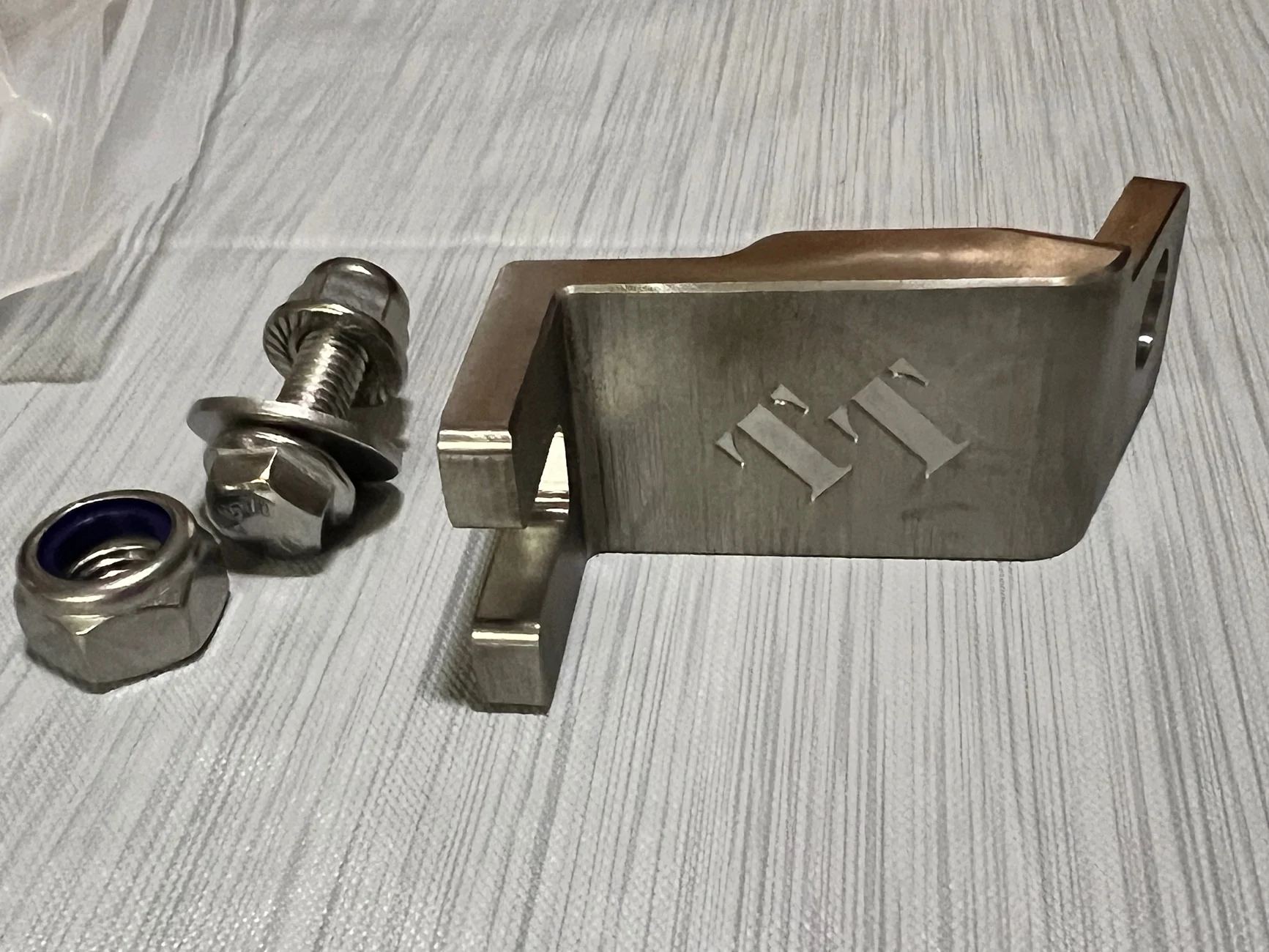

Yes as stated, locking the differential in place does assist in reducing/removing most instances of wheel hop. Also removes the movement in the diff from loading and unloading the car which depending on how worn your bushings are you can feel it. Increases responsiveness as well.
Our diff brace kit is the only kit on the market that handles both the front and rear mounting points of the diff as well.
We also use stronger materials than most of the other mounts out there. Was the first no drill diff brace. Tons of people use ur diff brace kit. From circuit cars to 7 second drag cars. Its been proven for years on many cars (several hundred sold).
Definitely feel free to reach out with any questions. link for our current V2 mount which offers access to diff service points without removal is here:
https://twistedtuning.com/products/...-z4-differential-lockdown-brace-kit-version-2

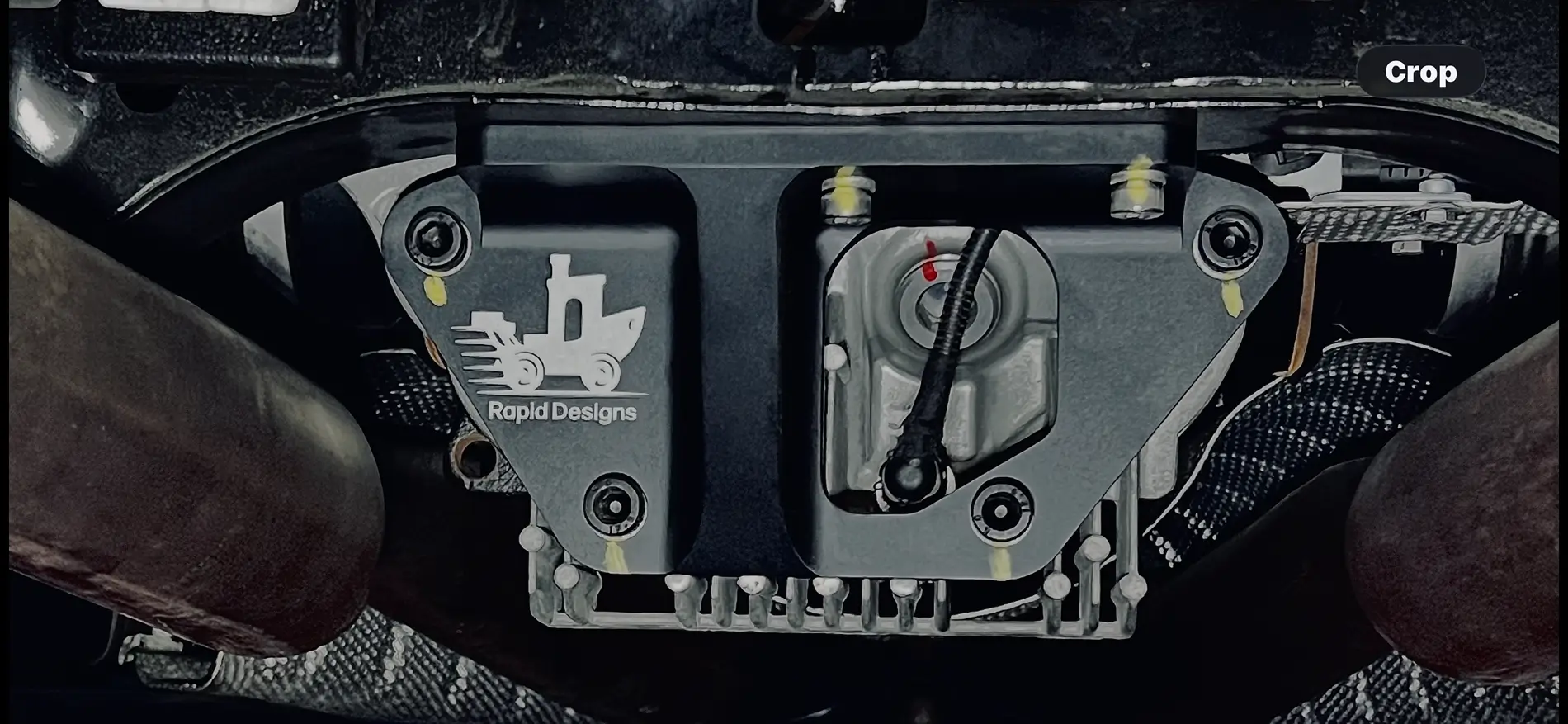

I have the Twisted tuning front brace and Rapid Designs rear brace on my Supra. The rear feels planted and solid now.
Any idea how much the front braces help? Considering them as well, any increase in NVH?

yes they help. they stop the movement of the snout (input end) of the rear differential. We are the only company that addresses this along with our rear case brace. And our rear case brace is the ONLY one piece unit which also eliminates other points of movement and shifting. We also use stronger materials than almost every other kit out there.
there is a video on our website showing the differential movement.
EDIT: forgot we put in on our youtube channel.

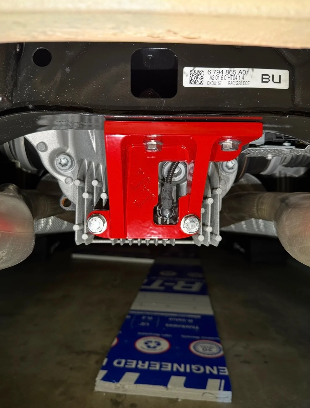

Did BMR brace a couple of days ago.

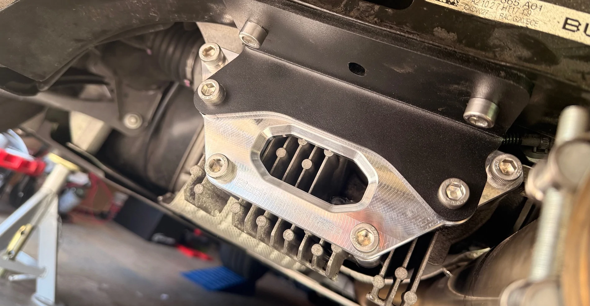

Did this a couple months ago, but now I kinda wanna switch to the BTK one. BTK also requires drilling on the driver side, so I asked them about the measurements to see if I can reuse the BMR hole otherwise I don't really wanna drill another hole :oops:
Orrrrr mine doesnt require drilling 💁‍♂️
Why bother drilling when there are literally options that better designed that you dont have to drill holes in anything. Will never understand why people chose the harder route for some things.
