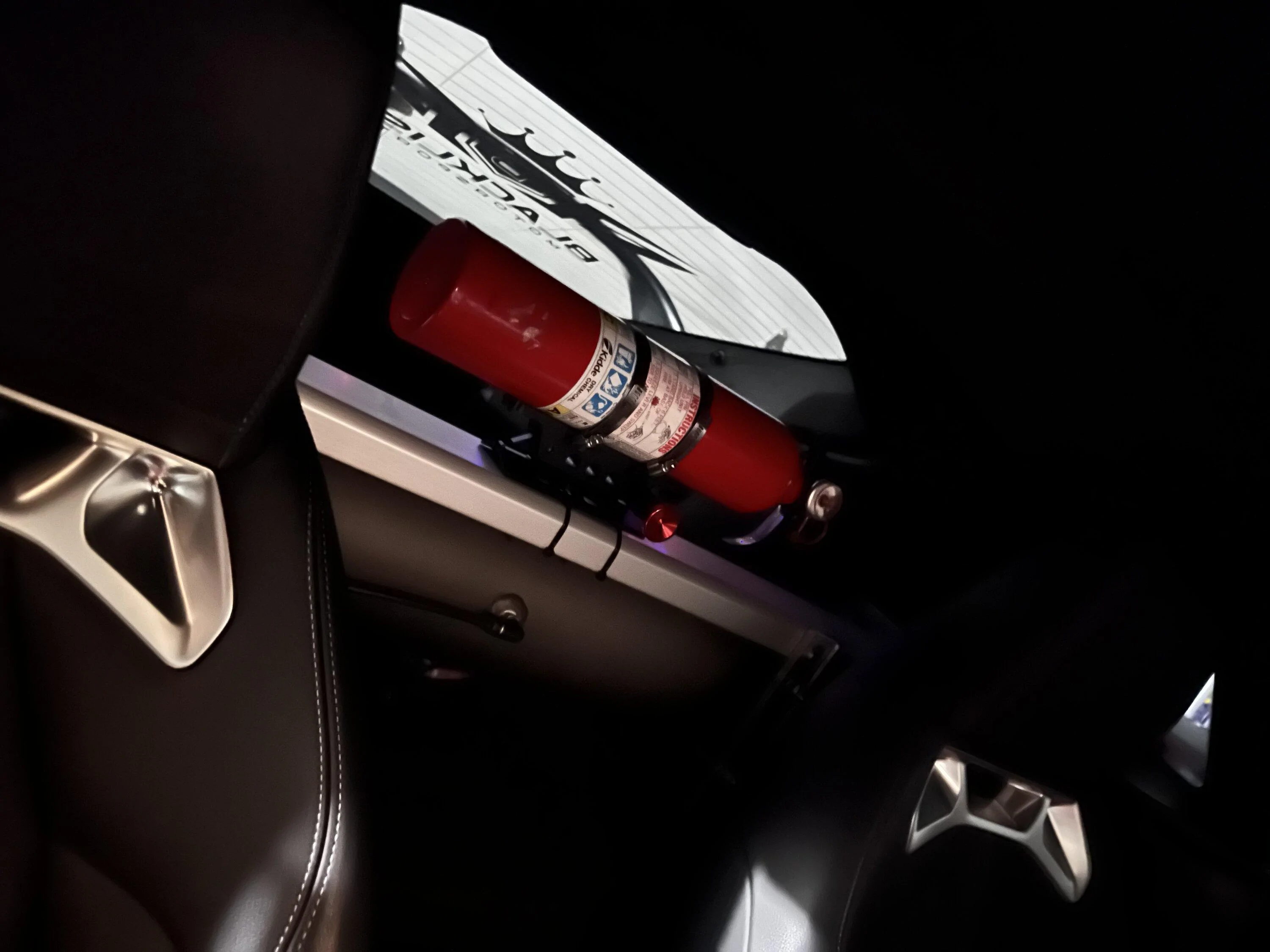

Basic Kidde ABC extinguisher I had in the garage.

Is that just zip tied? That is some Final Destination shit waiting to happen.
It is. Had some thicker ties in there prior to that picture taken but had to cut them off. All I had left were the smaller ties. Iā€™ll replace them with metal ties or might just bolt it down.

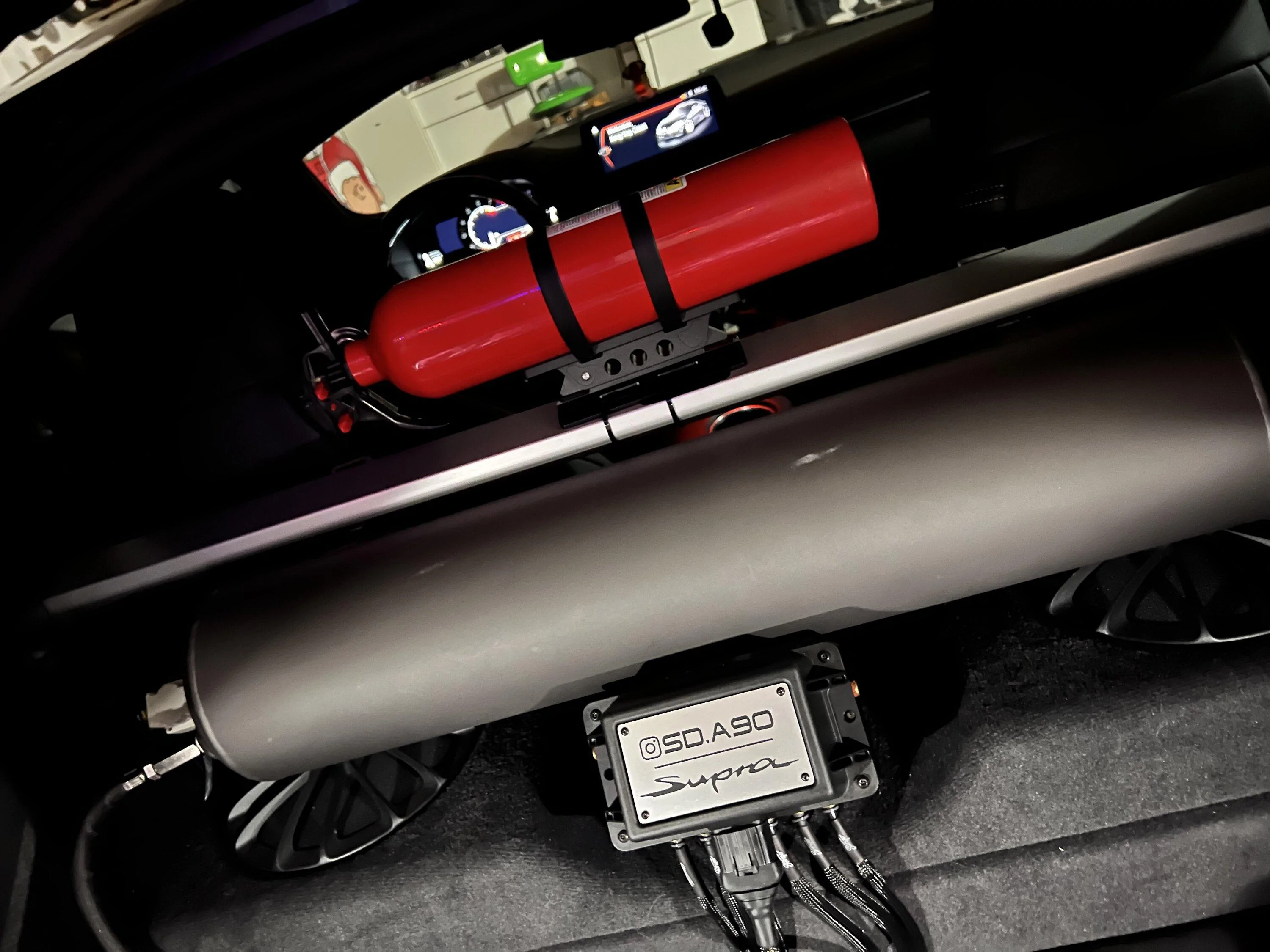

I used some eBay bracket that bolts under the passenger seat and is adjustable with a quick release to bolt to that bracket. Something universal you can make work on the cheap just an option. Also Iā€™d be more worried about (a zip tie breaking šŸ¤£)my fire extinguisher being out of date than which fire extinguisher brand.

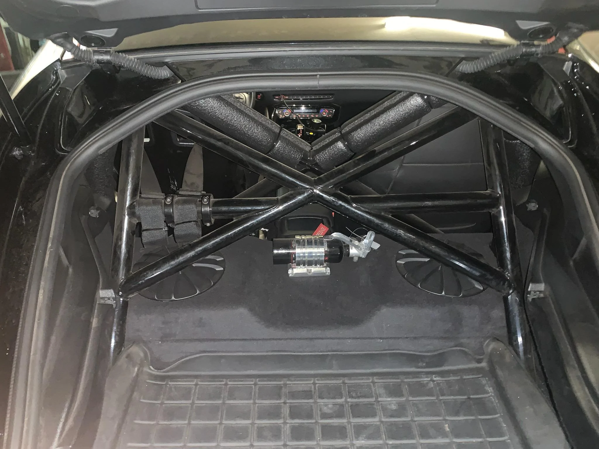

I have both element and Hs3. I used the element on a friends car and it saved it from what would have been a big fire and probably a total loss on his gti race car with a fuel fire over the gas tank after a race track contact with another car broke the fuel neck on the tank. Here is a pic of how I mounted the Hs3
