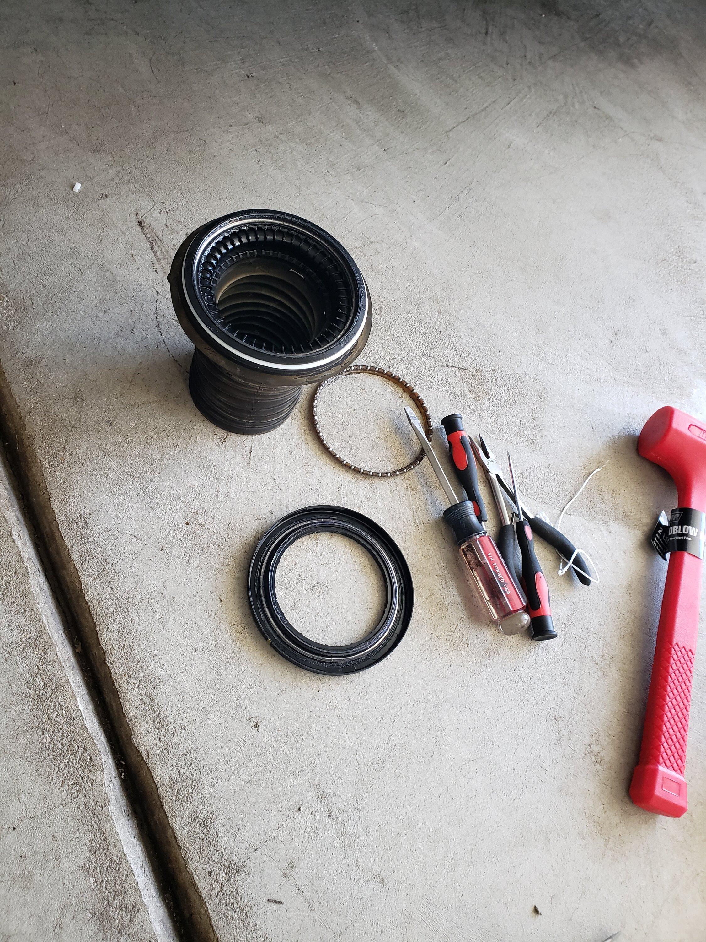

The bearings actually come off. It’s a 2 piece assembly and the bearing is removable from the strut mount

I just pulled it off, it seemed like it was pressed on.
The bearing container itself just snaps apart, there are clips on the top piece that keep it all together. I packed the top and bottom channels with Royal Purple grease and snapped it all back together. I was surprised about the lack of grease from the factory.
