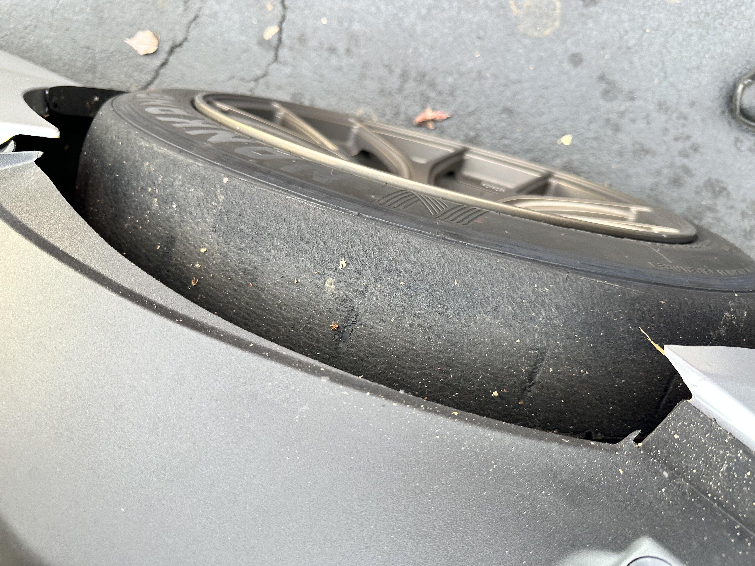

Rubbing Damage Fixed With Added Benefit
Nothing -4 camber won't help ;)
Truth! And a little height adjustment, stiffer…. I’m finally paying someone to set me up properly. It’ll be interesting to see where the numbers lie (in my case at least). I gave them your updated setup/height as well, for reference. At least we have the same size wheels/tires. Thanks man!
___________________________________________________
Curious what wheel/tire size the other guys here were running? @3rdDegreeNinja @Traxion
Saw @ope_sry was on 265-19s and lowering springs. Which definitely starts chewing into the amount of space up front under high speed compression. I was on lowering springs as well ? and not enough negative camber.
That ☝ with spacers also adds to the intended outter width. Allowing that tire to intrude that space under the wheel well fender. The OEM suspension track guys seem to be fine on 275/35(or 40)-18s. Now that i have coilovers, I’m able to take my spacers out. Which should also help.
(Kudos to @ope_sry bringing this point up. I’ve seen others with this same issue on our local tracks - this should definitely help others avoid the same mistakes)

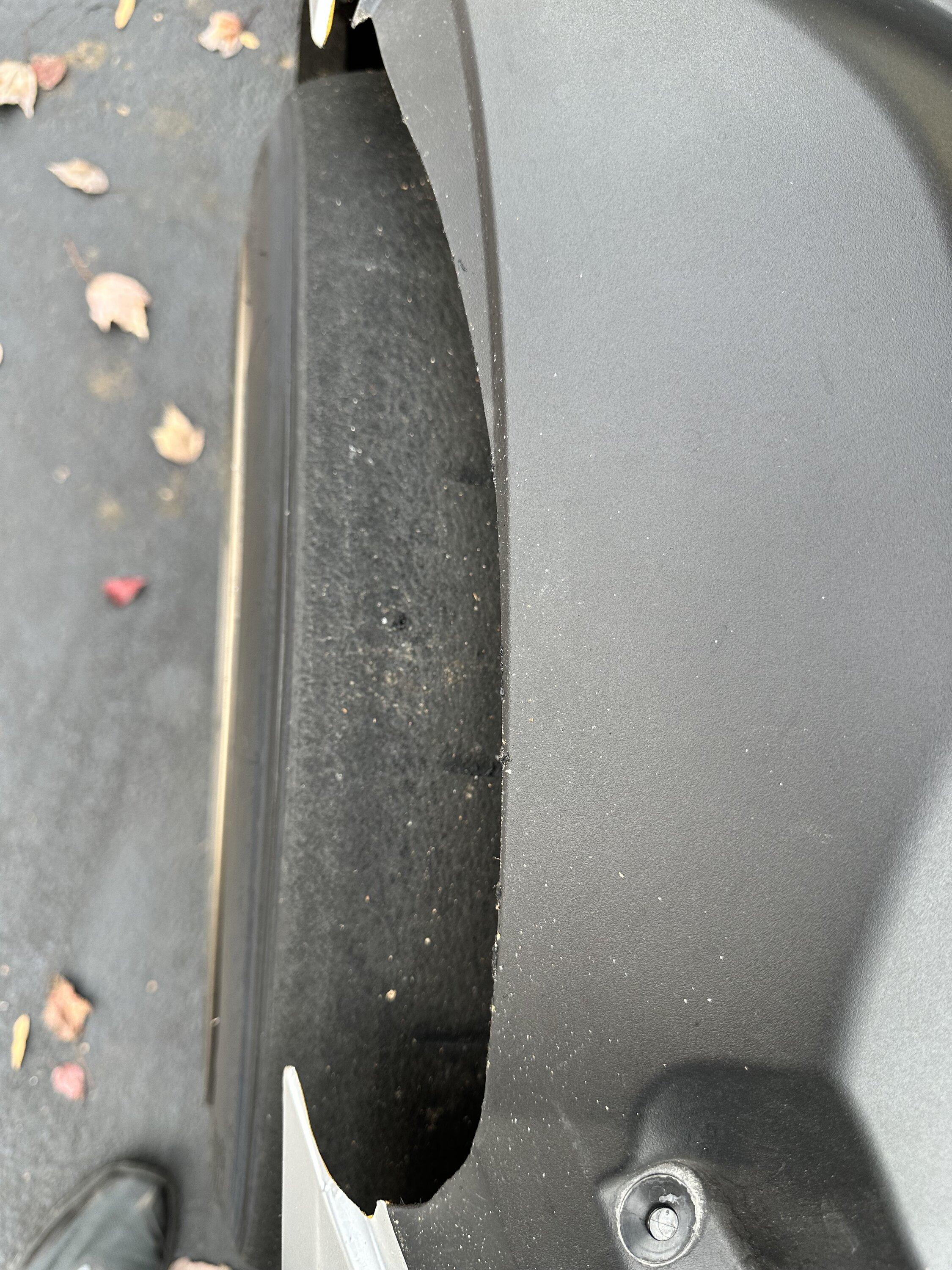

We posting our fenders?
Bam ?- Smartest solution! However, check out underneath the hood (wheel well fender). It’s metal and requires more cutting lol. If you notice black rubber in that location, you’re finally going fast enough to rub there too. Downside, you’re finally going fast enough to rub there too ?
Just sayin - don’t forget to check there as (wheel) well. Not you, but I was doing that and met others when we open their hood and we’re still rubbing. Hence my ride height, more camber, removing spacers and increased stiffness - here I come ;)

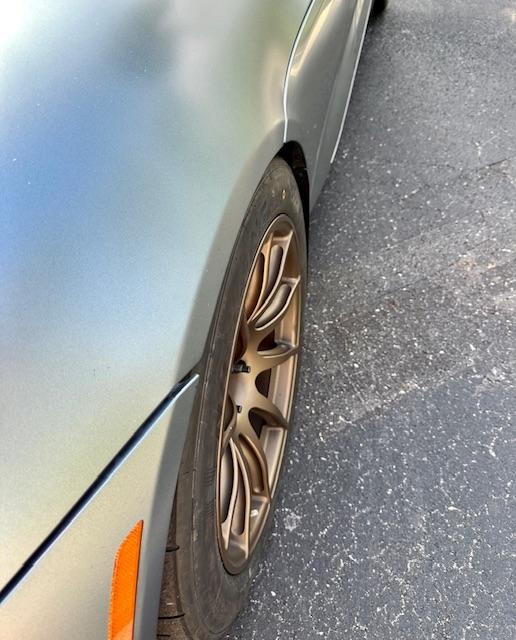

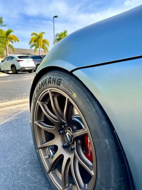

Im on 275-35-19s in the front with stock springs/shocks, and at the time of the rubbing I was on the stock sway bars.
We finally got the tires tucked under the wheel well fender
With the obvious is now taken care of, we also went stiffer on the sway bars and a few clicks down on the Ohlins dampening. With confidence up, times should go down ? - Looking forward to next weekend & put her to the real test (on track, @Sebring)
