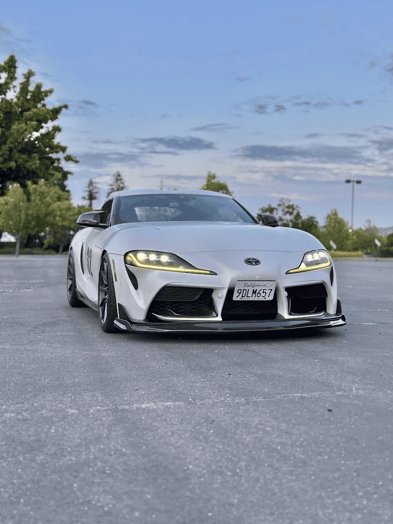

Would you prefer these over stock white? How's it with driving at night, of course you have your headlights on?
Its purely aesthetics for me. I love the yellow DRL look even when the headlights are on.

oh wow, definitely purely aesthetic look for those that like it. Looks awesome! Can't believe these are from aliexpress vs Motorsport+ and bayoptiks. i mean it's all made in china :yes: overall, sweet a91 and build so far! oh and how you liking the stock wheels? planning on upgrading to aftermarket?

Thank you! I'm loving the 23 stocks for now. They look good and are lightweight/forged. I'll keep them until its time to replace the tires. Aftermarket will be in the future for sure!

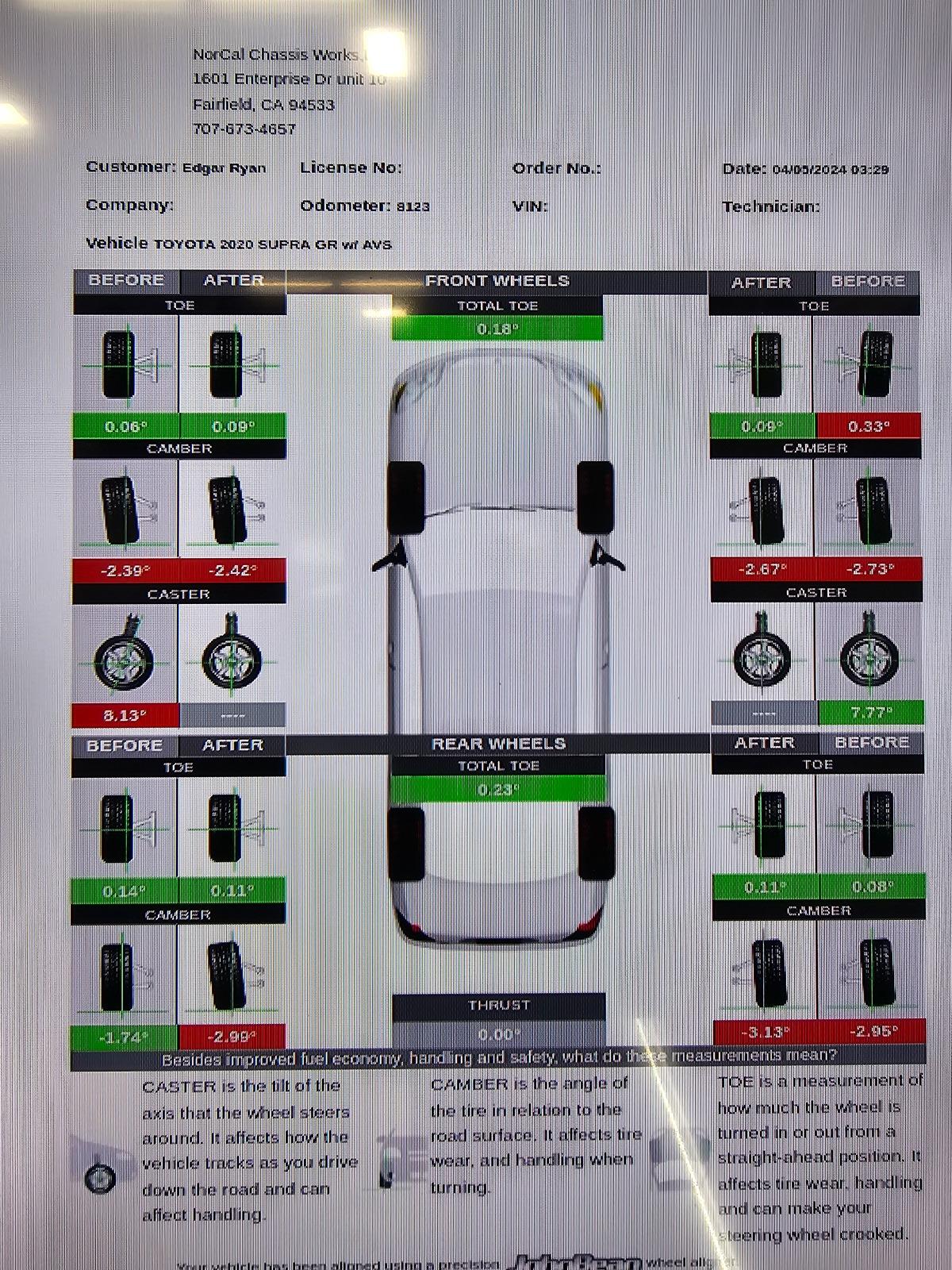

Updated alignment specs.
Damn fancy! More camber in the rear than front? I don’t even get a sheet anymore. Dude does it by string. He says I can take a pic of his notebook however ?
How does it feel on track?

I don't have any camber adjustments lol. I'm still on oem arms/plates, I guess the guy just maxed it out until i can invest in some! Heven't been on track yet but when I do I'll update how it feels!

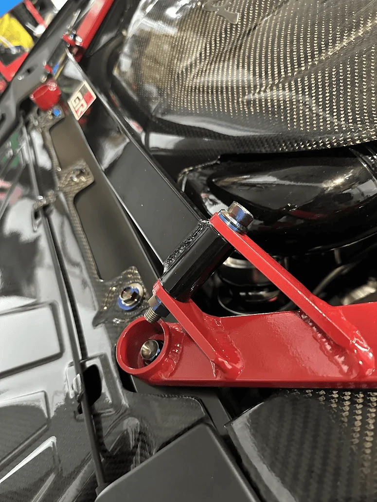

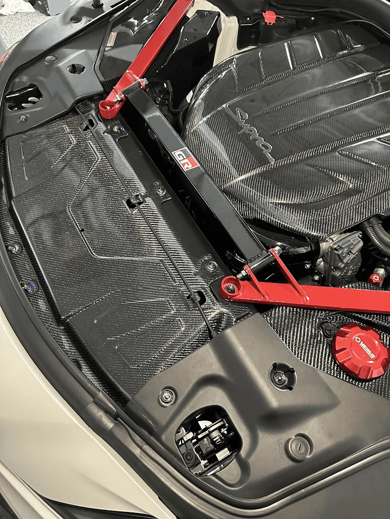

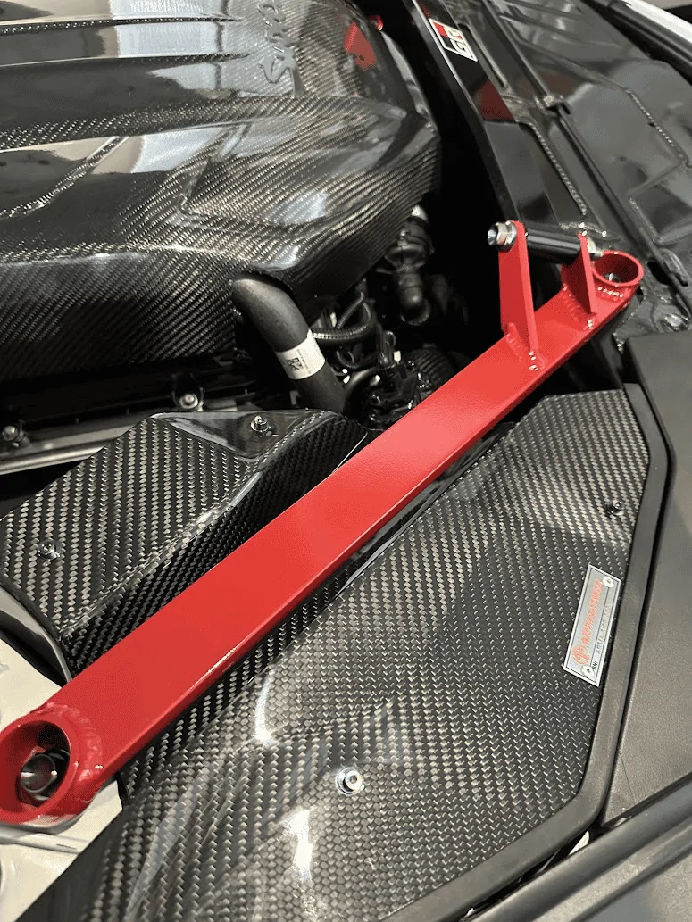

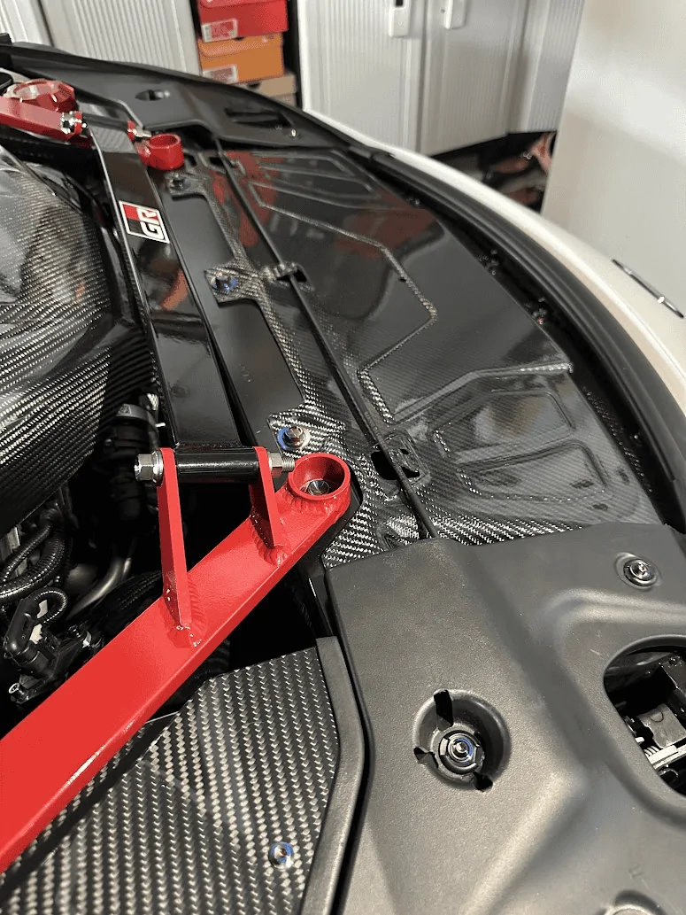

Added some titanium dress-up bolts from JDC for extra .01 whp each:

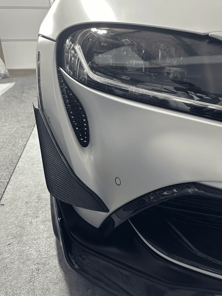

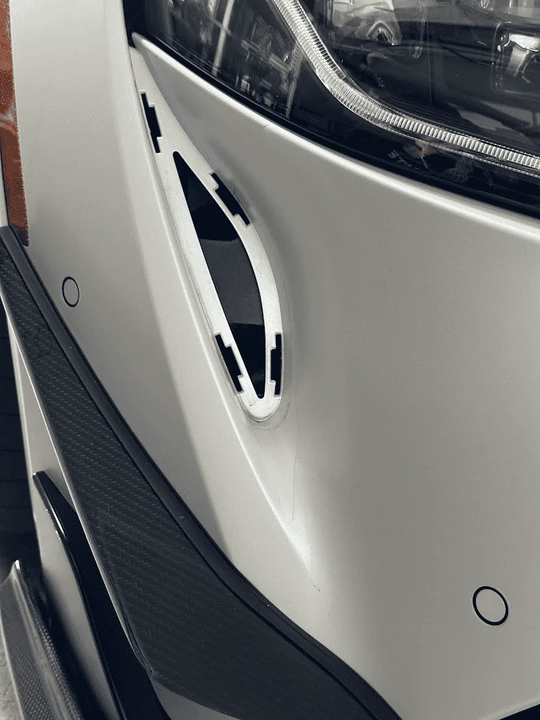

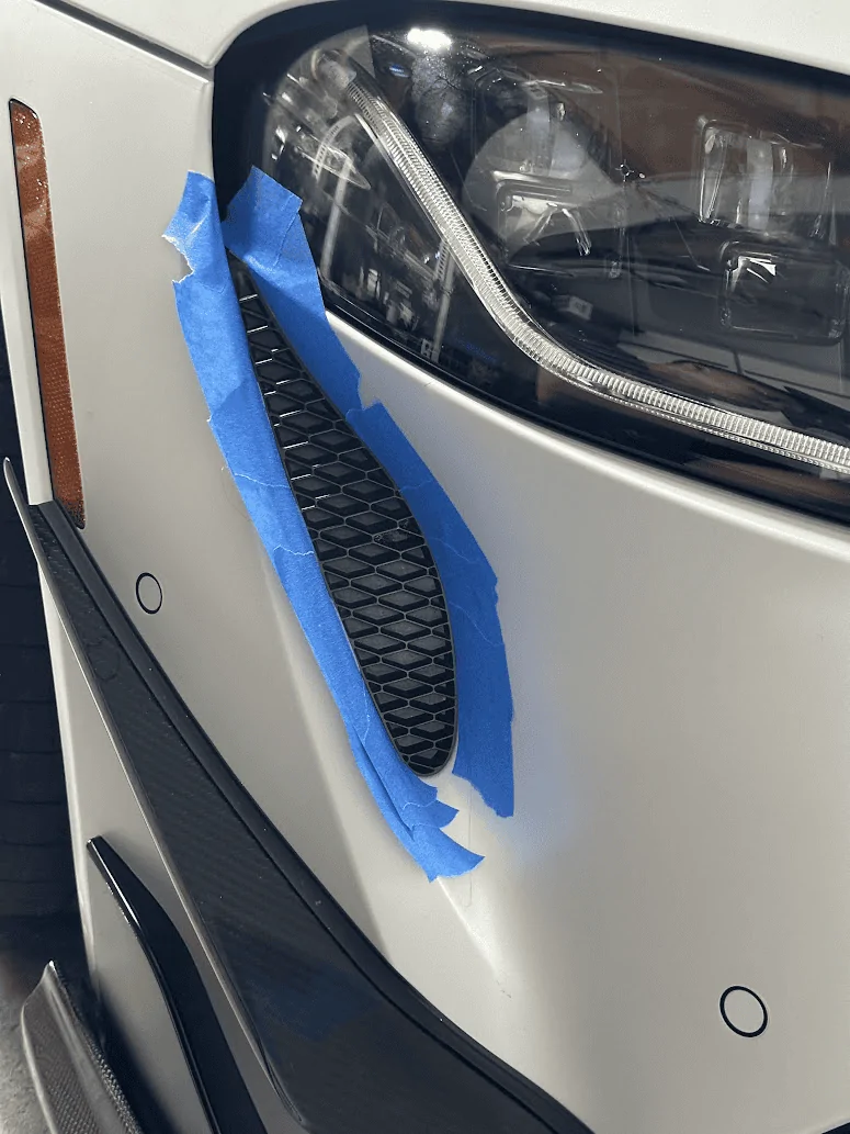

Replaced the fake front bumper vents with real vents from Speed Industry:

lucky phil
Phil
Jan 23, 2023
1,545
1,801
Only the lord knows where they lead but they look better than the fake ones imo.

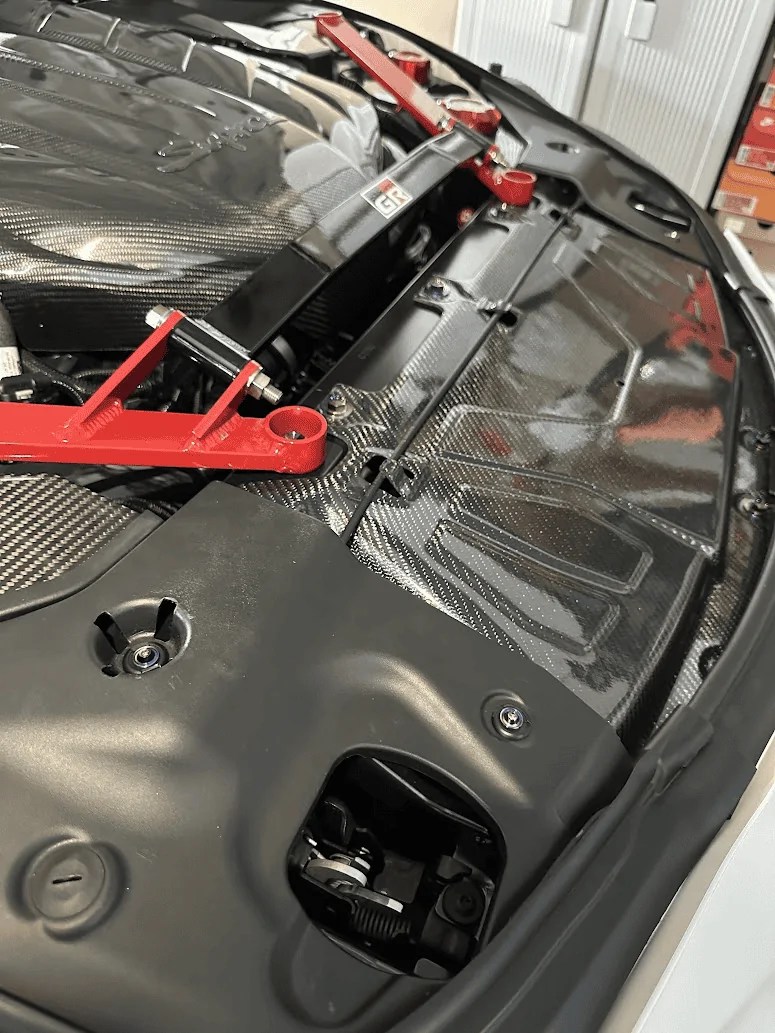

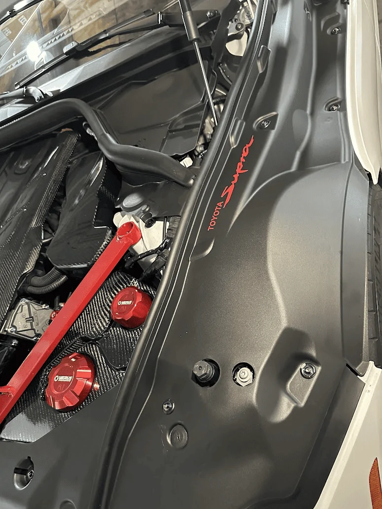

I think you need to paint the mounting flange under the plastic vents black. Looks a little "home made" with the white flange so obvious. Easy enough to do. I like your use of Titanium mount bolts ( I use them on tons of applications. Not particularly for the weight savings but because they don't have a surface finish that ages after a few years) on the strut brace but from an engineering point of view there are a few things. No need to use a washer under the head of the flanged bolts on the cross brace ( the bolt flange itself incorporates the load face) and the tail of the bolts should protrude no more than 1.5 threads beyond the end of the nut. Not a particularly functional issue just one that doesn't look "engineered". in addition if you aren't going to use a lock nut of some sort ( preferably a Nord-lock washer) then some blue loctite is necessary. If you're going for "the look" then you may as well make it look like it's been done by a pro.
